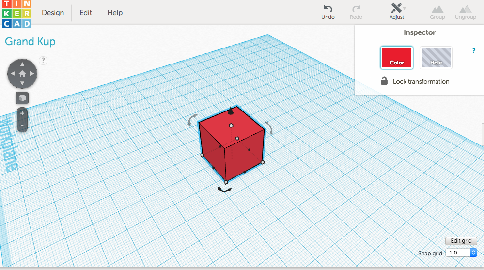

You can import existing STL files through the function on the right hand sidebar of Tinkercad. Dragging and dropping also works. If you look a bit lower, you can select a wide variety of geometric shapes to get you started in your workspace. You can also take a look and import other Tinkercad Shape Generator designs made by the community. There’s some neat objects available there, such as a voroni square, gear houses, octagons, and more.
Once you have the object in your workspace there’s two main things you need to know.
  • Dots scale/resize the object relative to the corner or plane you drag from. Hold Shift at a corner to scale the object uniformaly!
  • Arrows are for rotation. You can rotate on any of the planes.
