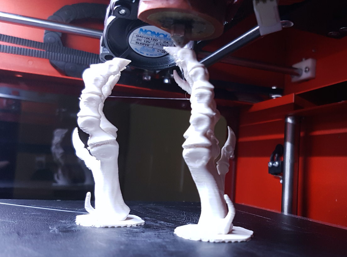

That said, I did feel like it would a nice challenge to print the pieces seeing as it looked like quite a tricky print. I downloaded the files and opened them up in Craftware (because I used a Craftbot) and to my pleasant surprise, the parts were already perfectly oriented and I only had to set the right settings and slice the model.
I printed most of the parts at 150 micron in white colorfabb PLA at 20-30 mm/s at 190 degrees (thanks for the temperature advice Ken). The models themselves were modelled and positioned in such a way that I didn’t require any supports which I thought was really nifty and quite impressive! I did print a raft underneath the prints to make sure that they would actually stick to the bed but I’m sure a lot of printers wouldn’t even need this either.

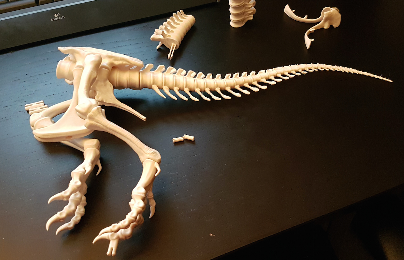

Anyway, here are a couple of progress shots.
One more thing I’d like to mention is that the files come with a really clear instruction manual and you don’t need any other material to put the print together but the models included in the .zip file. In the end it’s like you’re putting together a lego project, and who doesn’t like that right?

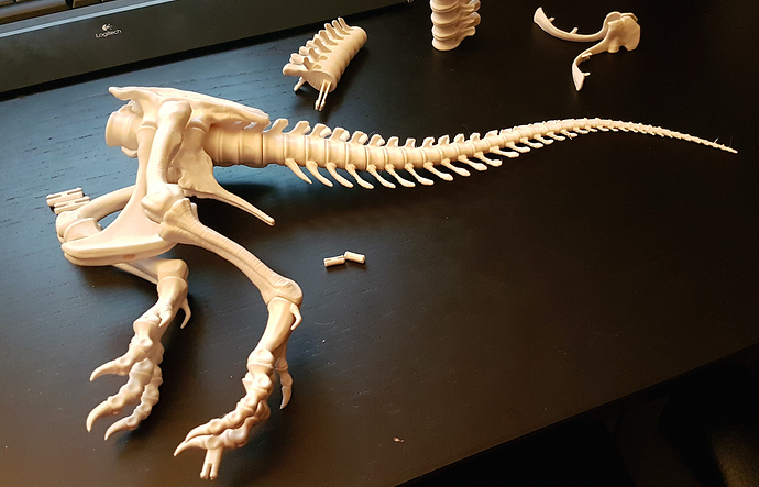

Here’s the final version of the print with full-color printed me standing in front of it. I do realize that some parts could be a bit cleaned up and the teeth are a bit messy but I am happy with the project for now. Does anyone have a suggestion on what to print next? I’m all ears!
