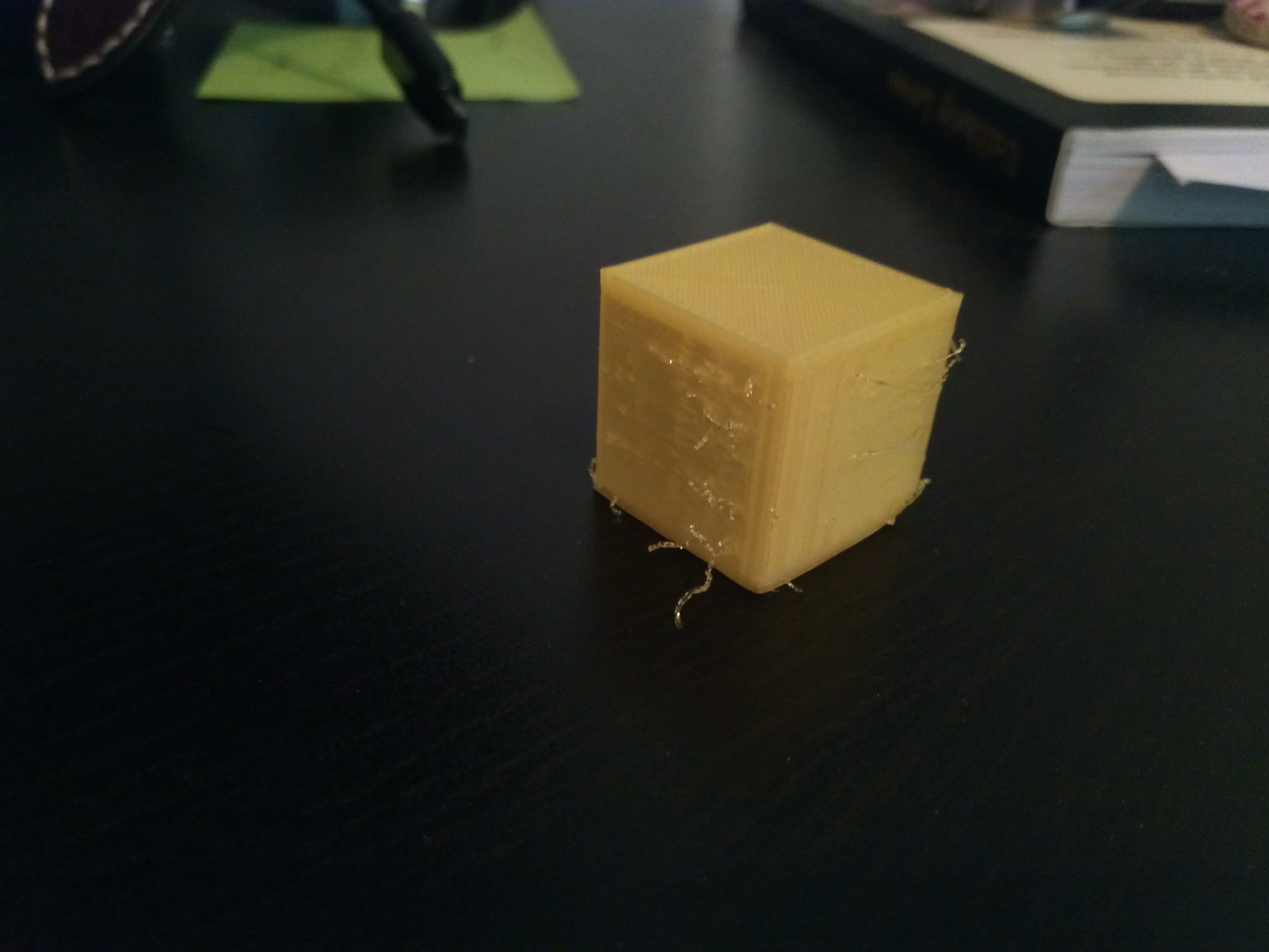

Hey everyone,
So I’ve decided to try printing PETG on my Wanhao duplicator i3 since i want to print higher temperature materials but not have the thermal challenges of ABS. I am able to print some decent looking parts but not without them having these strings around the print (see photo of 20mm cube). The strings only appear to be on the edges and the base and top of the print seem to be fine. I’m using these cura settings below and the PETG I’m using is Inland PETG, any recommendations on how to mitigate this issue?
print speed: 45mm/s
temp: 235C
bed temp:90C
retraction speed: 40mm/s
retraction distance: 8mm
Outer shell and top/bottom speed at 20mm/s

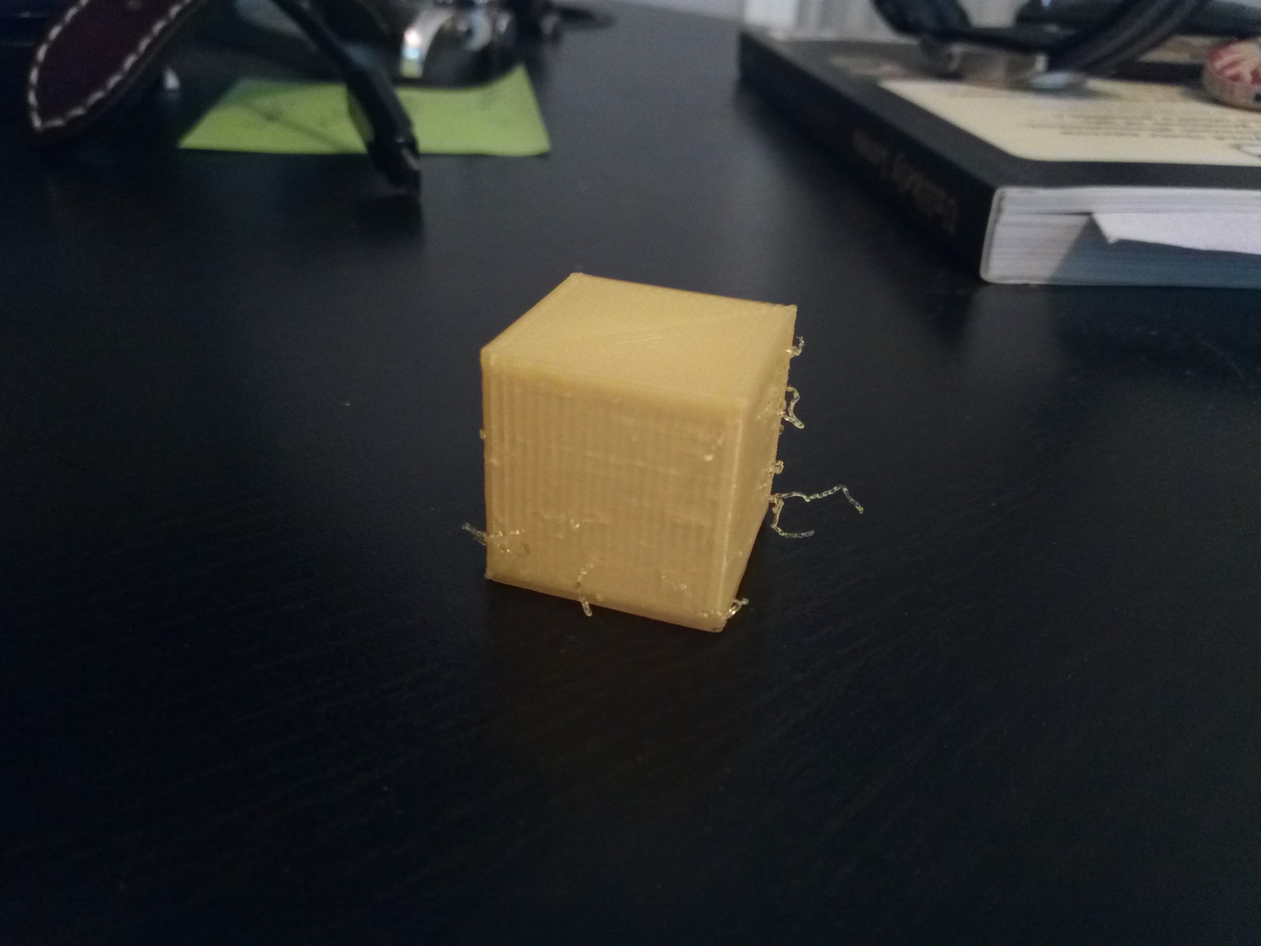

Adding second photo to show another view of the print.

Did you tune the filament diameter and extrusion multiplier? Try setting all speeds the same except travel. So if you are printing at 20 set all print speeds to 20.
I don’t know if my input is worth anything to you as I’m using a different printer & filament size, but I’ve had great luck with PETG. I’m using a Lulzbot Mini with eSUN PETG 3.00mm filament and get great results with no strings at all. Low & slow seems to work for me. Here are some of the settings from a Cura profile I’ve saved that work great. You can translate these to whatever slicer you’re using…maybe try to at least replicate these, see if it improves your results then tweak from there. Mine has a .5mm nozzle.
