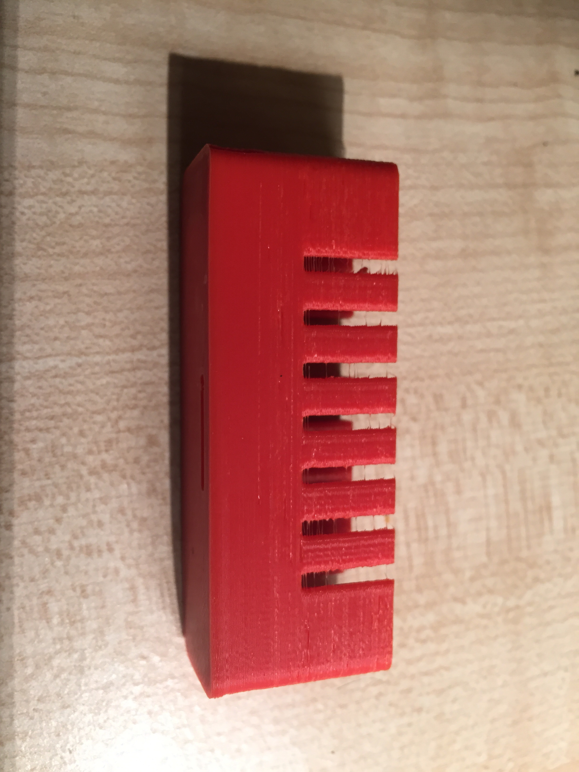

Ok, so first of all have been printing great with ABS. Updated to sailfish, still great. Sick of sprays and abs slurry and the like so installed a PEI bed. (Wanhao dup 4s)
Loaded a Red ABS which I’ve used before and now my prints are stringing with tiny holes. Can’t think how to fix or why it’s happening.
http://i.imgsafe.org/6d03db9.jpg
The top case was the original print, the case in the bottom of the photo is a recent print.
Now I used to print at 237c and 110 bed and these were perfect. Because of the PEI I use gcode temp override to lower the bed temp so I’m able to use the same gcode file as before.
Got 1 print off which was ok but not great quality, then extruder started to click when printing.
So I clean the nozzles out, and drive gears of the extruder motor and try again. No clicks, yey! But now the prints are stringing with tiny imperfections. I’ve noticed the ABS is leaking a lot, not like it used to.
Any ideas? Is it because my nozzle has been cleaned out and now over extruding/ extruder skipping?
Just wanting to know why this is happening now and how to fix. Sailfish is setup correctly reset to factory defaults so probably not a firmware problem.
Thanks for any tips guys

Based on what you described and the picture provided. I will says that it’s most likely your filament as absorbed humidity. This can happen when the filament is not stored properly depending on where you live there is a huge amount humidity in the air and ABS, PLA, Nylon and other filament absorb humidity quiet a bit.
You can put the roll in the oven at 50 degree C for about 3 to 4 hours (make sure the oven do not go higher than 50) I know it sound crazy but it’s a recommended practice.

Update: I’ve got rid of most of the stringing by printing at a lower temp (220) but that’s not the main problem now.
The prints are very weak, the case above where the vents are snap off while printing. When the print has finished its very easy and brittle to break. It was not like this before.

Perso I think 220 is too low and your part now are suffering from what could be referred as delamination.
http://reprap.org/wiki/Print\_Troubleshooting\_Pictorial\_Guide#Part\_Temperature
Who will make the part really weak and the effect accentuated if moisture has made his way through.

Update 2: Ok so put the filament in the oven for 5 hours and managed to get an ok print finish @ 230c , success!
I store the filament for a couple of days and try another print. Disaster, similar to before. I’m thinking this can’t be right, so i try the print again but this time with new filament that’s never been opened.
Same problem awful quality and strings. I try this at different temps and still no joy. I’m thinking because I haven’t calibrated for this new filament so I’ll measure the diameter and try again at some point with a new gcode file. It started to print ok but as you see in the photos gets worse. When extruding this new filament when loading there were bumps in it, not nice and smooth as usual, thought this was strange.
Through out all of this I’ve noticed that any ABS I load, leaks out the nozzle more that it use to. I’ll load the filament, stop, and it will still come out slowly for a second or two, is that normal?
