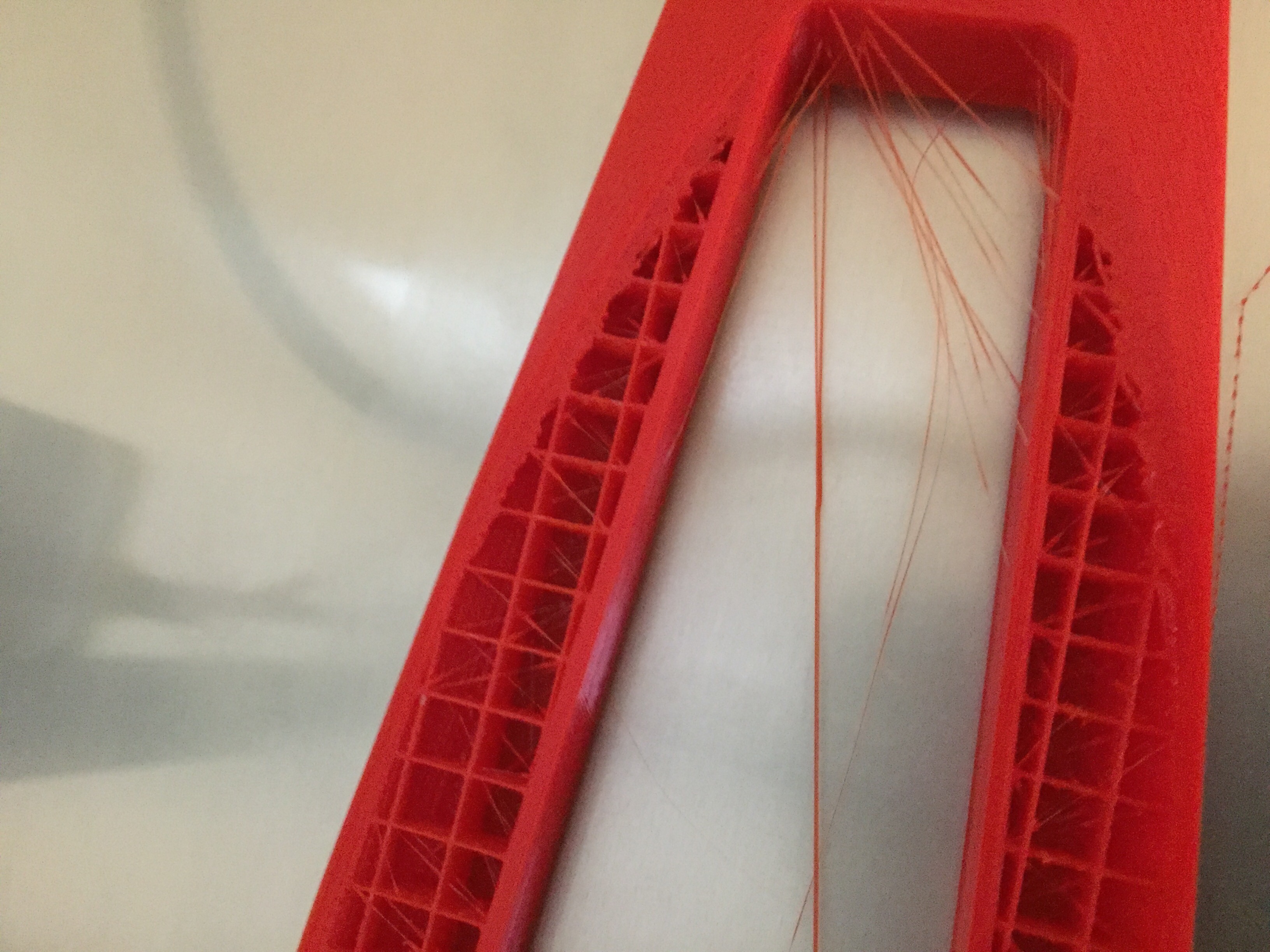

Hi everyone,
I use a CR-10 with Hatchbox PLA at 205 C. I have printed many objects with Craftware, but I can’t help to notice that the filament sometimes leaks out during far travel, even with my retraction settings dialed in. I have printed retraction tests, and those prove that my settings are fine. I was just wondering this is happening because I have my temperature set too high or if there is some setting that I’m overlooking.
Keep dropping the temp 5 degrees at a time and see how it does. I have printed Hatchbox at 190. Also some colors string more than others and this kind of extruder move all the way across an open space is prime for stringing.
wayneuk
3
180 travel speed seems high to me. looks like your dragging the filament
