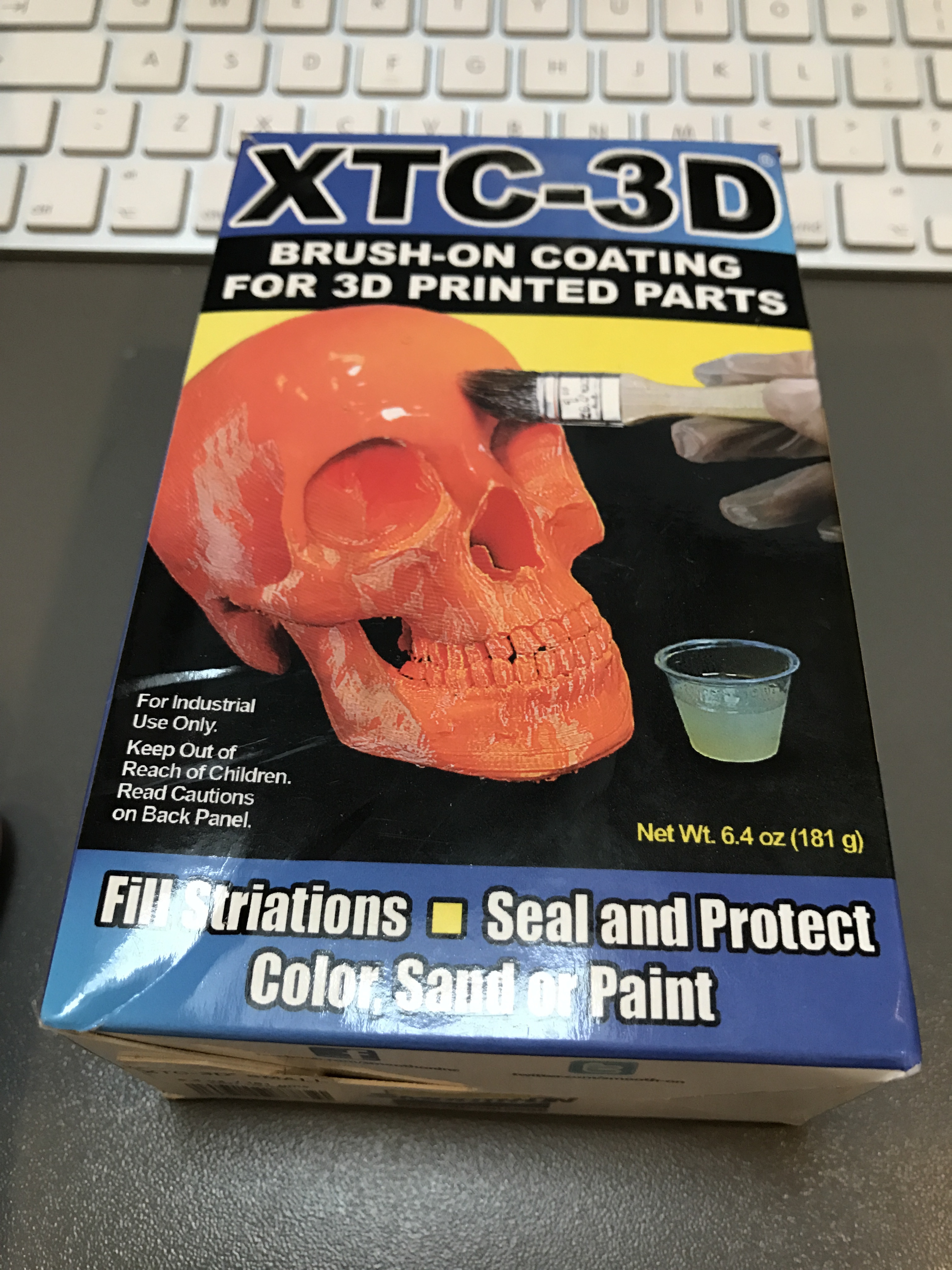

Hi. Wonder if you have tried low vapour epoxy?
also, i have tried this with my own 660.
