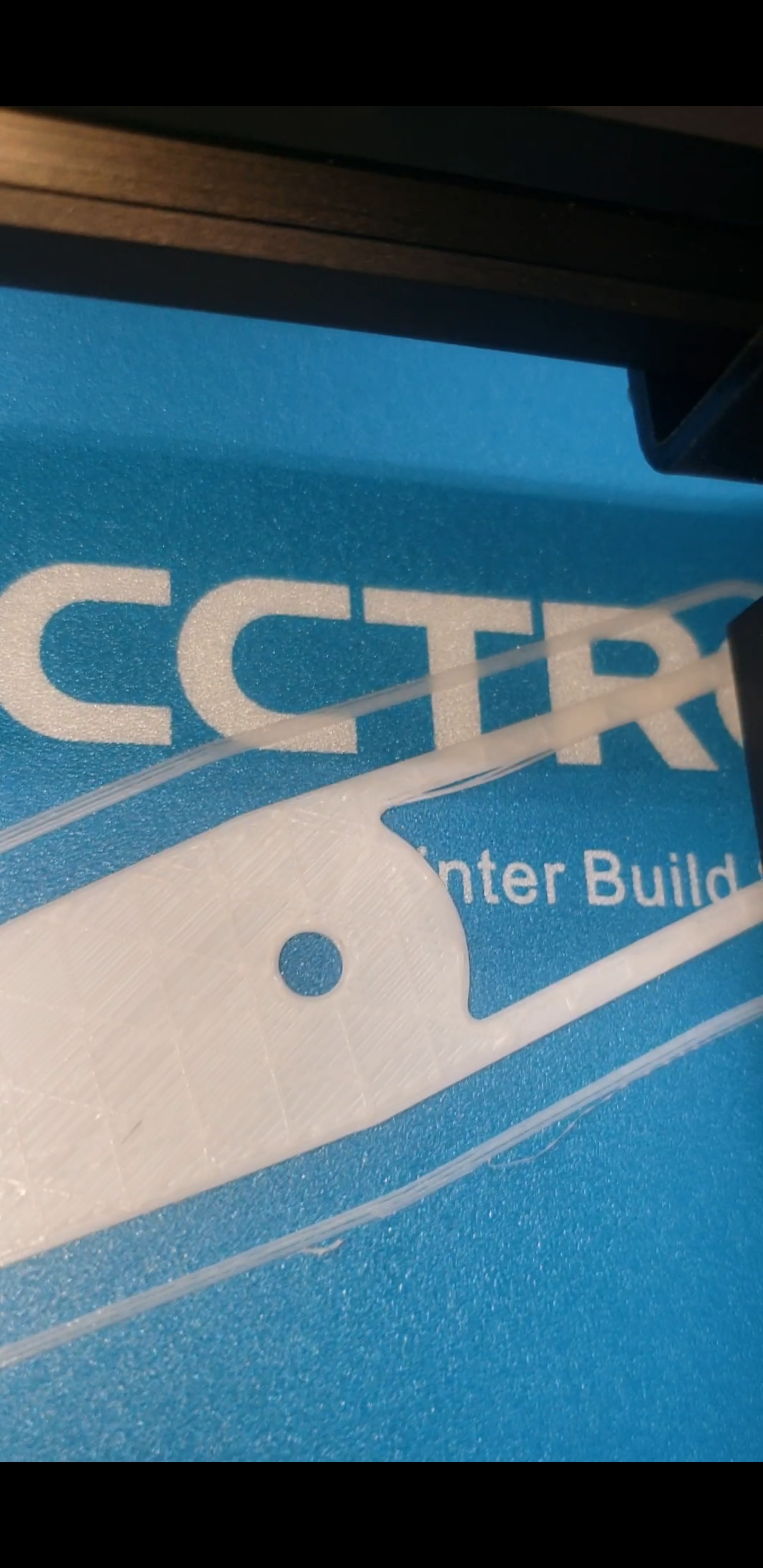

Good evening,
Just bought my first printer and I’ve got it all set up.
I was wondering if theres anything I can do about stray lines? On prints that have longer bases sometimes a stray or bent line pops up. I use hairspray and its PLA with 200 degrees/65 degree bed temps.
I do a skirt outline of 2-4 and that part lays down perfectly fine.
However if you look at the image. I get one or two lines that seem to not stick. Any solutions?
looks like it could be slightly under extruding. Try upping your flow rate in your slicer or the extrusion width. I have a 0.4mm nozzle and I have my extrusion width set to 0.48mm. Also, make sure your nozzle is at the right height above your bed and its level. Not sure if it was just the brand I had but hairspray never seemed to work for me. Try using a water-based glue stick if all else fails.
