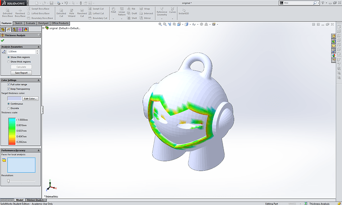

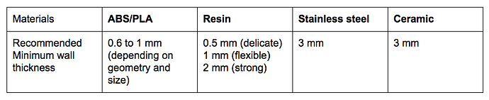

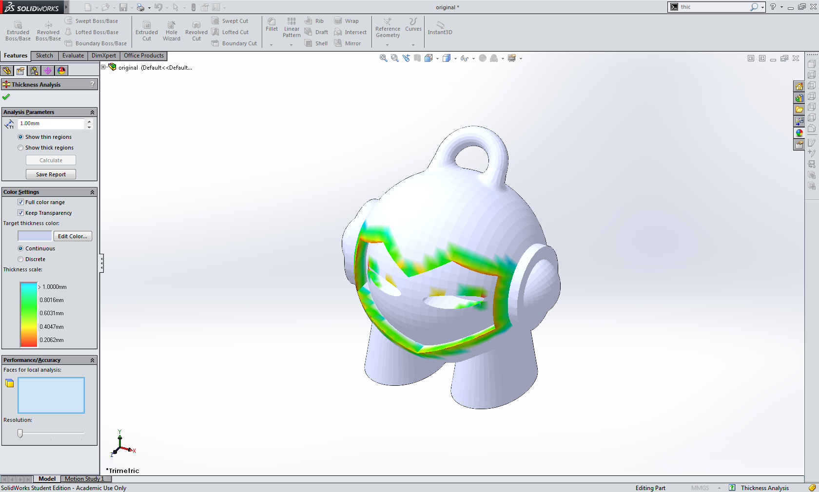

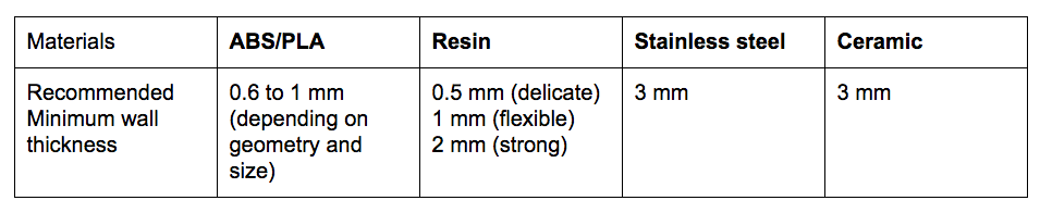

The wall thickness, or the minimum wall size of your model, is another important parameter you need to take into account. Too thin walls might make your model non-printable or break after completion.
Luckily, the Thickness Analysis utility tool makes it ridiculously easy to to check the size of your walls in SOLIDWORKS. Use the table below for reference:
This values are indicative and can vary depending on the nozzle size of the printer in use.

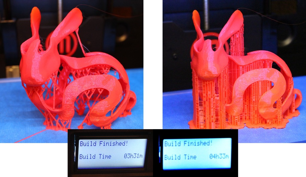

It’s always good to keep in mind the printing technique you intend to use for your design. For example, FDM and SLA printers require the generation of supports to be able to print overhanging parts. On top of impacting the amount of material used and printing time, support structures can leave marks after being removed and can induce a long post-processing cleaning.
Voronoi shaped Stanford bunny 3D printed with an optimal number of supports (left figure) (photo credit: Ryan Schmidt)
For SLA prints Use the Align feature to get your model under the best alignment and then generate only the minimum required amount of supports. (This step will be handled by the SLA printer proprietary slicer software).
