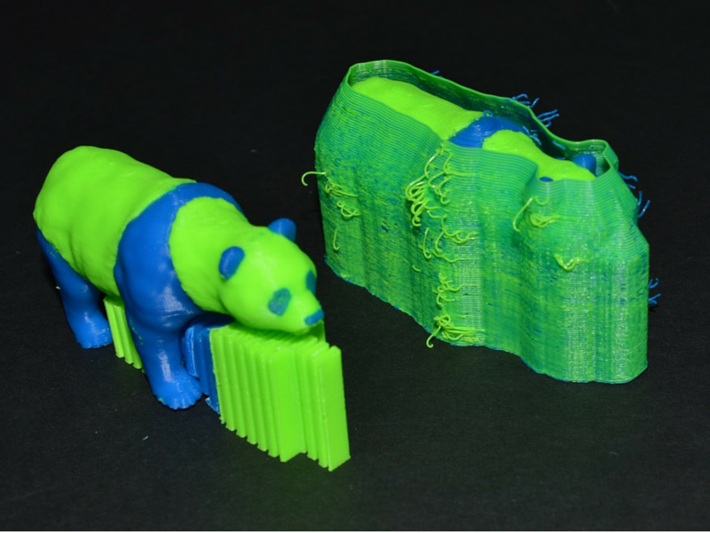

Dual Extrusion Wizard: The new Dual Extrusion Wizard simplifies the steps involved in configuring a dual extrusion print. With only a few clicks, users can create a beautiful two-color part. Depending on the type of model, users can choose from a variety of “ooze shield” shapes, which will surround their part during construction and provide crisp, sharp definition between colors.

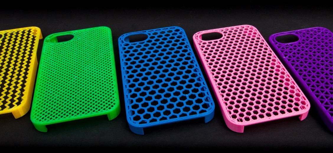

Infill options galore: Simplify3D now boasts six infill pattern options, including the popular honeycomb and triangle infill patterns. The new variety of patterns allows users to configure the interior of their part exactly how they want it, whether the goal is to achieve high strength requirements or for stunning aesthetic results.

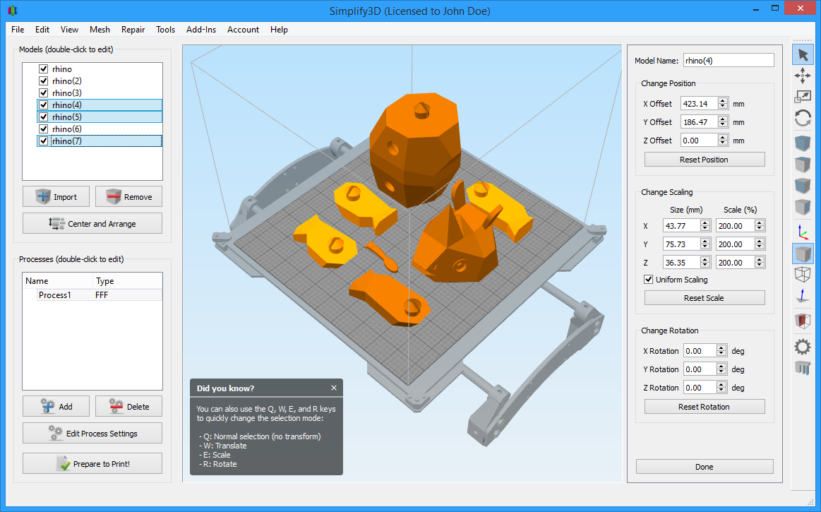

User-friendly interface updates: The interface has been revamped so that frequently used tools are more intuitive and easier to use. Model manipulation is easier than ever before, and new grouping options make it incredibly simple to work with multiple parts. An “undo” button saves time and frustration while new keyboard shortcuts improve navigation. The Preview Mode has also been enhanced with multiple coloring options so users can visualize their build sequences by speed, active toolhead or feature type.

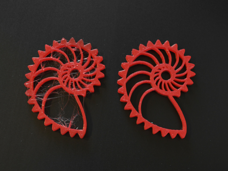

New settings boost quality: Simplify3D 3.0 provides dozens of other new features to improve print quality, such asAvoid Crossing Outlines, which alters the movement of the toolhead to reduce excess oozing, and Non-Stationary Retractions, which helps reduce defects (a.k.a. “blobs” or “zits”) on the outer surface of the print. These fine-tuning controls improve even the most challenging prints, and make the difference between a good print and an excellent print.
