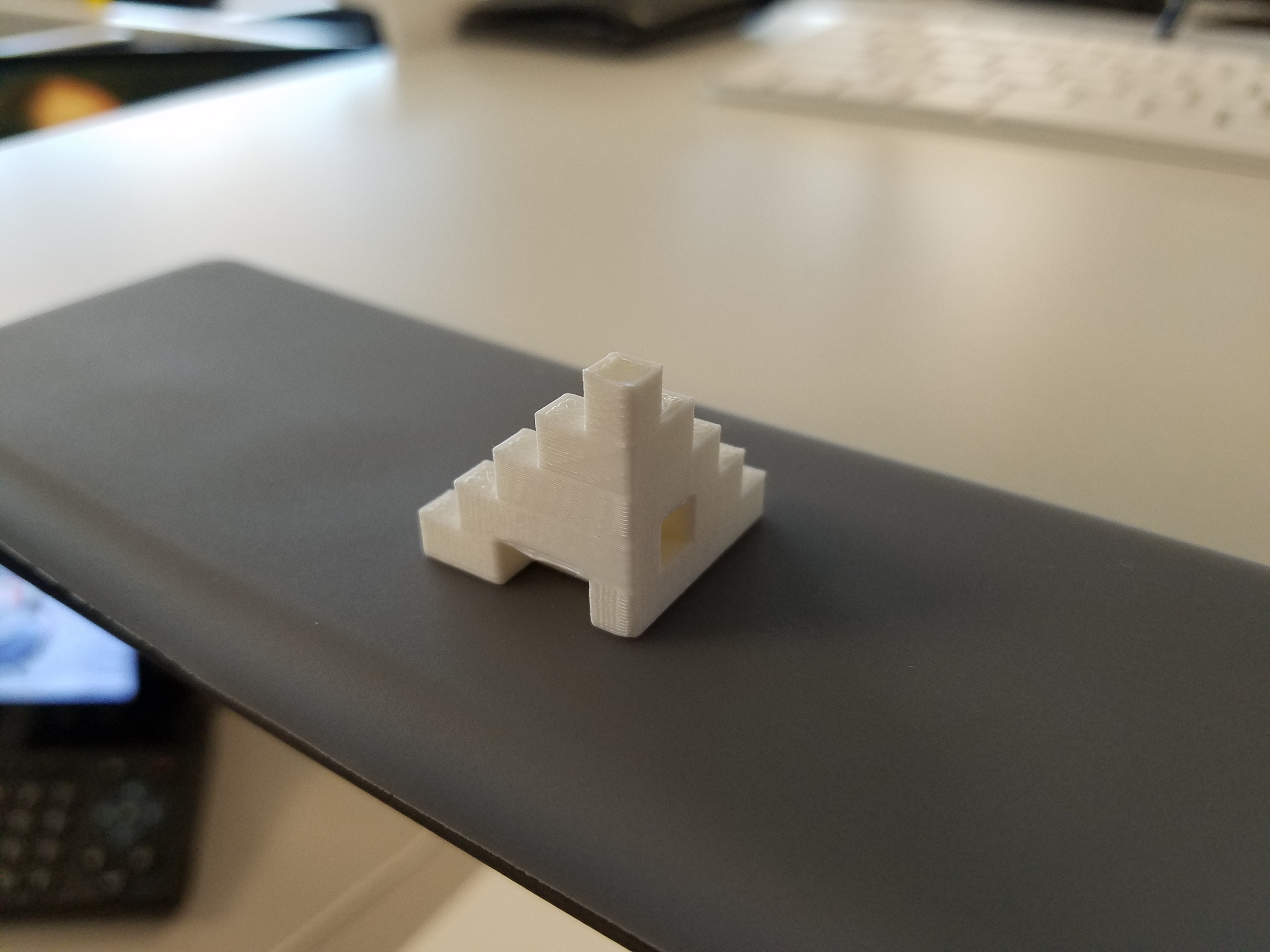

I made all the adjustments that you suggested and printed out a calibration cube from thingiverse last night. The cube came out almost perfect! The bridging does leave something to be desired though. All in all it looks good (see attachments).
How do you think it looks?
Nicely done!! My guess would be a little over extrusion maybe by looking at the tops but that is ok. I get similar looks on smaller ABS parts also. ABS can be a beast but it can teach a lot also!
That is the whole point of the exercise with calibration cubes is to find these things out!
What temps and speed?

I am using the temps and speeds you suggested above:
Speed: 2300 mm/min
Bed temp: 110 - first layer, 100 - second layer
Extruder temp: 240 - first layer, 230 - second layer
It seems to be working much much better now with some minor hiccups here and there. You have helped tremendously just with those simple adjustments. Thanks a lot!
