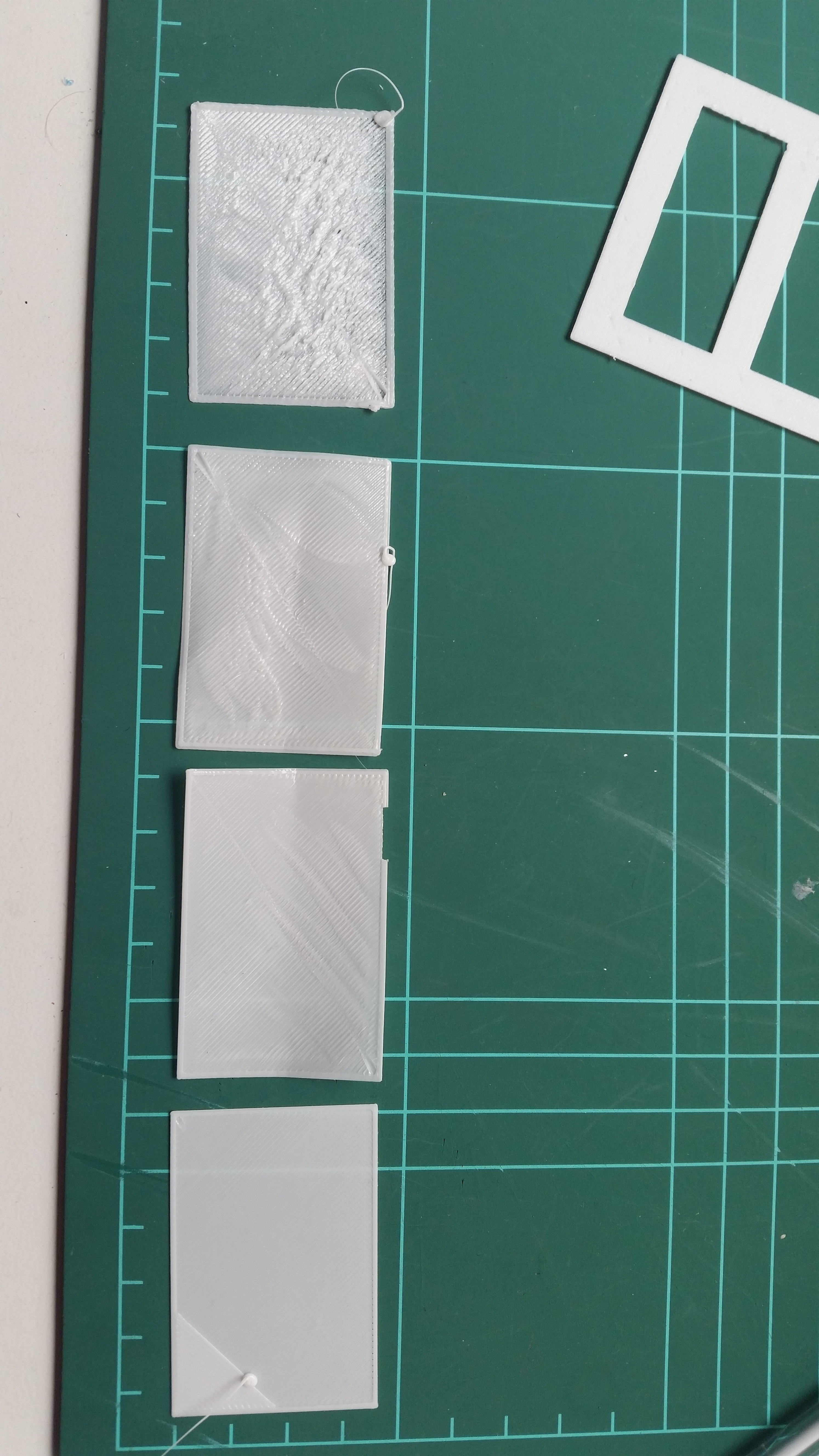

Hi, I had rippling on bottom layer which translated too top layer. After google got multiple answers reasons. Simply fixed by lowering print bed in 1/4 turn increments - 3/4 of a turn later - fixed. In my limited experience - it appears temp and bed fix most things before getting funky in the advanced settings…see attachment. Flashforge guider. Brett
