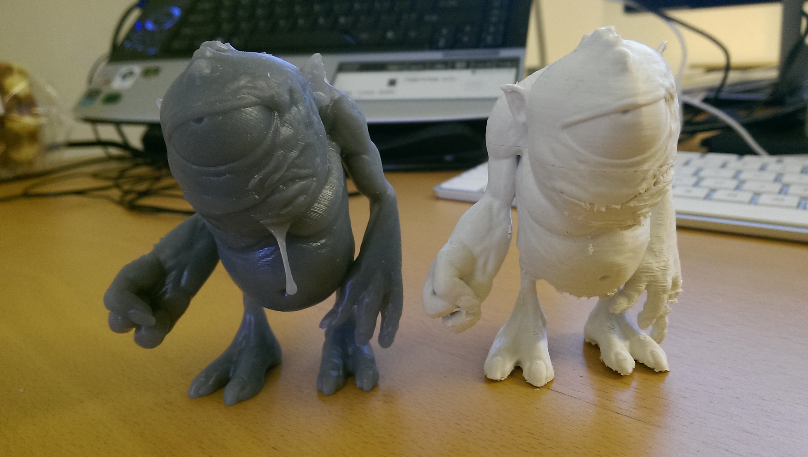

I saw this Talk and think I might have something to add as well. I’m a regular ZBrush user and have begun printing my sculpts on both on a FDM and SLA machine. I brought my model back from about 16 million poly’s to around 70 K using the decimation master, which is still an incredible tool. Using the the 3D printing exporter within ZBrush I was able to create an STL file that was about 23 mb’s.
For the FDM printer (which was an Ultimaker 2) I used Meshmixer to slice up my model and add supports. (I had quite a few overhanging pieces) There are two main things to keep in mind here:
- What is the most efficient angle to print your model at that will require the least amount of supports
- Support usually leaves traces so think about where you don’t mind seeing these (I used the back of my character)
For the SLA printer (which was an Formlabs 1+) I use the standard program, PreForm with all the standard settings and again made sure the supports were on the back of the character.
Feel free to check out the results of my prints below (the left is the Formlabs 1+ and the right the Ultimaker 2)
I do have to admit that both could be better, but this is my first try on both printers. (The model itself is about 7 cm in height)
