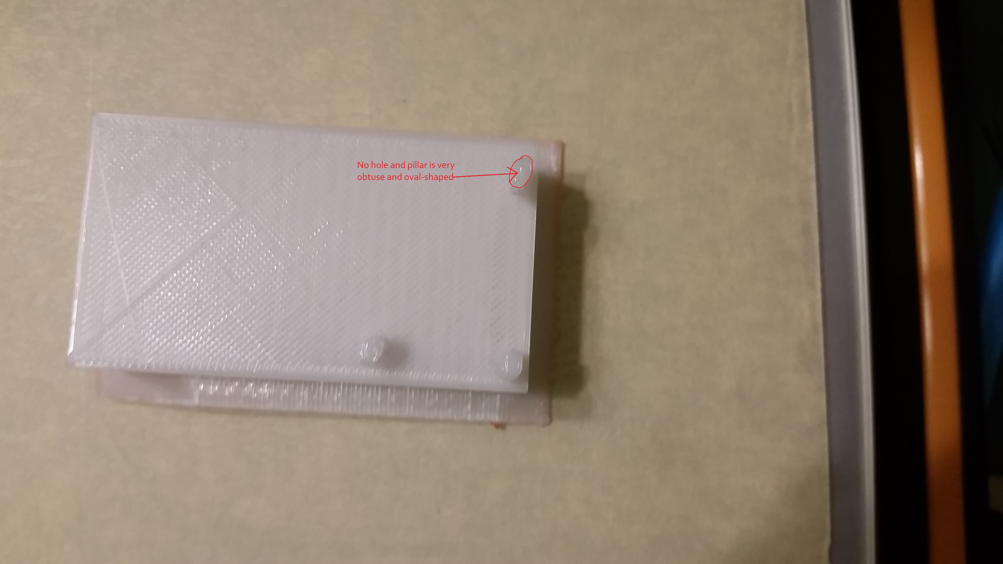

So today was the first time ive ever 3D printed. My printer is the Creality CR-10. I used “Cura” to convert my .stl file to gcode, and I used blender to create the model. I have pictures cause they are literally worth 1000 words, if not more.

You can see in the 3rd/4th pictures in blender AND Cura the pillars are round with a hollowed hole. 1st Pic shows that they came out very very oval shaped with no hollowed center.
So: Is this Cura related (software)? Is it printer related (my printer not capable of such precision)? Or what would cause this in general?
The box was about 1-3 mm short of what my measurements in Blender were. Has anyone else experienced this?

What version of Cura are you using? Unless it’s ridiculously old, I would say Cura is not the issue. Check the belt tension on you printer and measure the rectangle to make sure the dimensions are accurate, the rectangle might be elongated in the same direction as the circle. For the other issues I need to see the other pictures.
