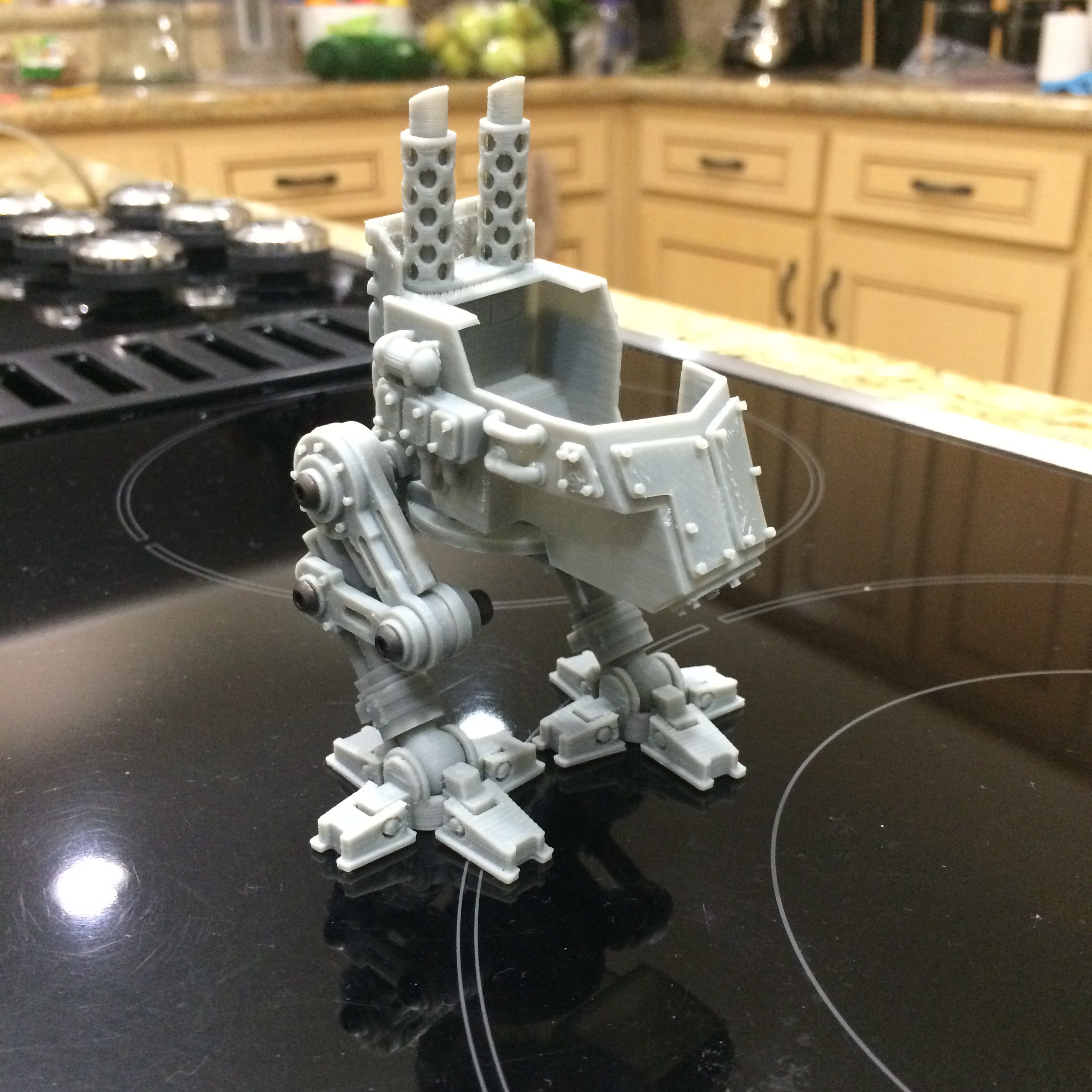

I am having a great time with my afinia h480 (up plus2). I wonder if there are more hardware and software improvements and updates coming or not. Just wondering because I see that tiertime is coming with a new printer already.
Mi included a picture of my current little project.
Thank you and happy holidays!
