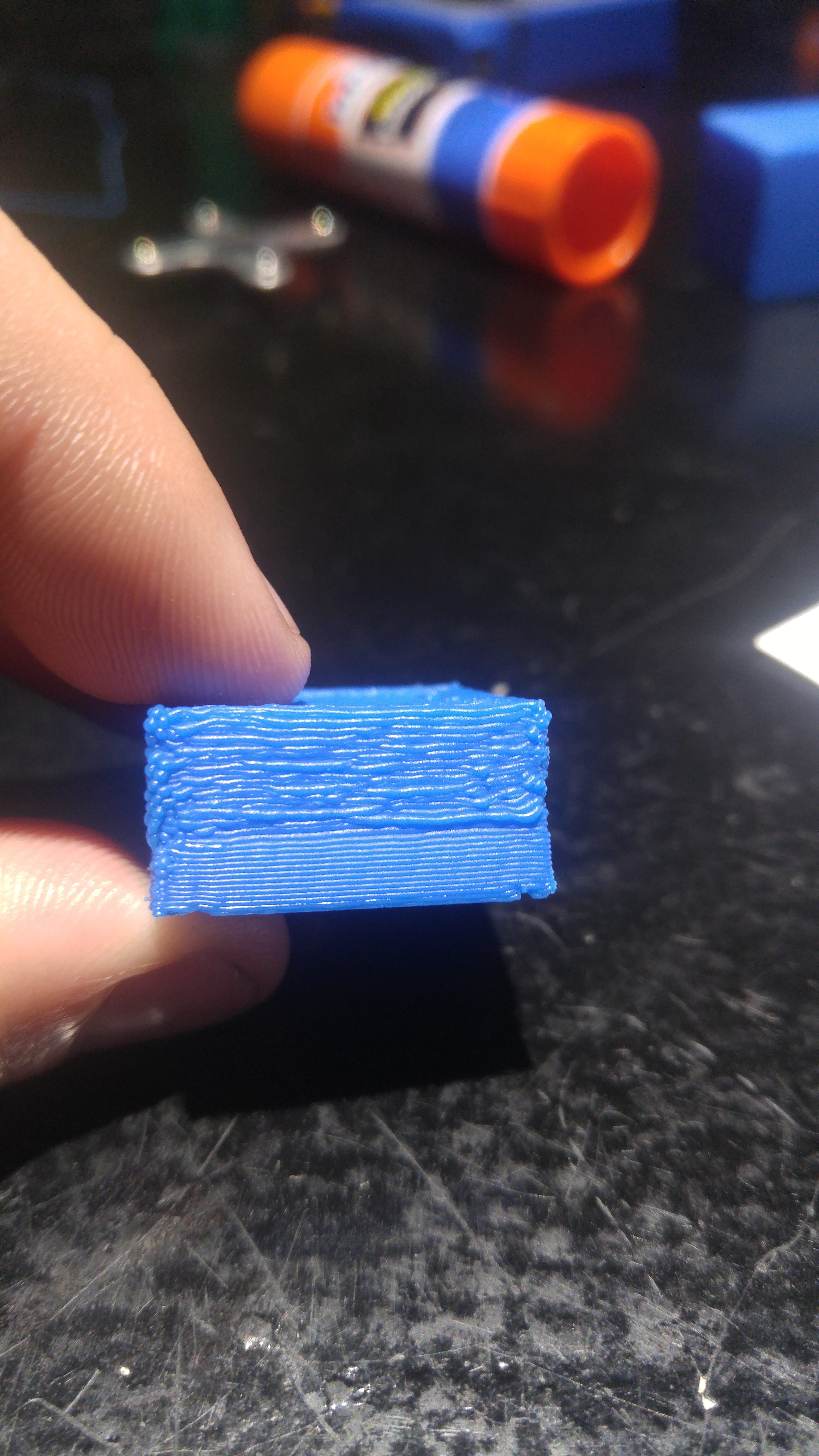

I have a Folgertech FT-5 large format 3D printer. I have been printing with it for about 6 months and it’s been great. Last week it started to deform the outer shell (shown In pictures). I can’t figure our why.
1. I have replaced the nozzle.
2. The heater and thermistor
3.Drive gear
4.Extruder motor stepper driver
5. I have also tested with various brands of material (same results)
I am using Cura and have been adjusting:
1.Extrusion rate
2. Outer wall Extrusion rate
3. Temperature
4.Speed
I currently print with a 0.4mm Nozzle. 210C with PLA. Heated bed of 60C. I run about 50mm/Sec
What could be the problem?
