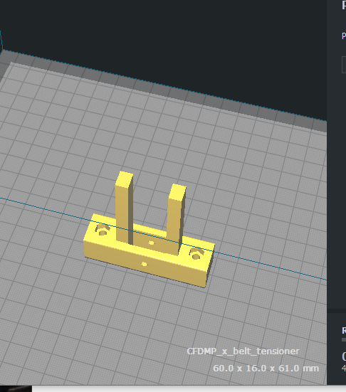

I’m working with a printrbot plus metal while I’m printing with PLA and have PVA layer on my print bed. Small prints with a flat surface work fine, however when I have prints with a large base, at some point I start seeing peeling happening.
Details:
I’ve tested putting more PVA, slowing print down, increasing layer height, increasing bed temperature all without luck.
I’ve attached my cure settings as a screenshot and also artifacts of the print as well.
