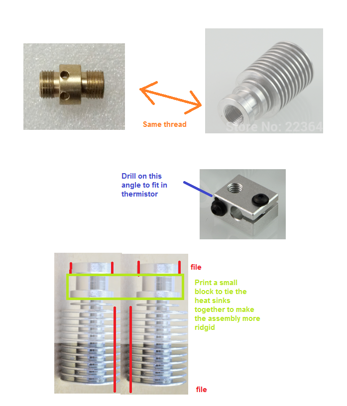

Hi, I replaced mine with Aliexpress hotends (based on E3d V6 metal ones). Works really well. The screw thread for the Bowden tube fits directly on the height adjustment screw on the Creatbot assembly.
You need to file the heat sinks at the top and on the fins to make them fit.
When you screw them on use some PTFE tape to reduce any play.
Once assembled print out a small block at the top of the heat sinks to tie them together to further reduce any play.
On the aluminium heater block you can drill out the side of the block if you want the original creatbot thermistors to fit.
For buying the hotends I would like to recommend E3D as they did the original design but unfortunately you need one of the Chinese copy ones as they have a threaded bowden connector in the top.
http://www.aliexpress.com/item/E3D-V6-Long-distance-J-head-Hotend-for-1-75mm-3mm-E3D-Bowden-Extruder-0-2/32482708127.html?spm=2114.01010208.3.1.wGjHgm&ws_ab_test=searchweb201556_8,searchweb201602_2_10057_10056_10055_10049_10017_405_404_10059_407_10058_10040_10060,searchweb201603_1&btsid=29672e15-ceed-4327-946a-d92c194c3c0a 37
I’ve added a diagram with the mods you need to do.
Hope this is useful for anyone having issues with the Creatbot print heads.
