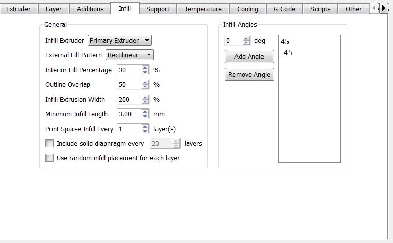

No I can get the support on simplify, but the issue is in the picture, but after doing some tinkering i tried to add another shell to the surface layer if that would help?

Like Munjeni says, try upping the outline overlap percentage: infill > outline overlap (mines on 20%) should get rid of those gaps between infill and shell.
Looks a bit like under extrusion - which can be from too fast, too cold etc. (slow down and heat up :))
In S3D it is worth checking you have your nozzle size at 0.4 and extrusion width 0.4
in Advanced use “gap fill when necessary”
plus I normally use 4-6 layers on the base and 8 on the top when I am slicing 0.15

In your infill properties window change the infill “overfill” (something like that, cant think of them item currently) to 60%. I have not tried it lower than 60% but 60% seems to work. This means that the infill will go over the outer shells by 60% vs the std 20% that it is set too.

My nozzle size is correct and the extrusion width was set to “auto” should i put manual and change it to 0.4 as well… its grayed out on (0.48)
I also raised the layers to 6 on top and bottom because i need both faces to be pretty clean

PLA at 205, just changed to 200c to see if change occurs
Okay so after reading all the suggestions, here are all my settings with the changes mentioned. Please let me know if you see anything i can do different.

Ultimakers handle PLA at 225-230 quite well. Both of mine are running right now at 230.
Alrighty I’ll try to raise the temp but i thought someone stated it was too high in regards to the photo
Your definitely not to hot if your only at 205 on an ultimaker. That I can say for sure. Up the temp and see if it helps.
