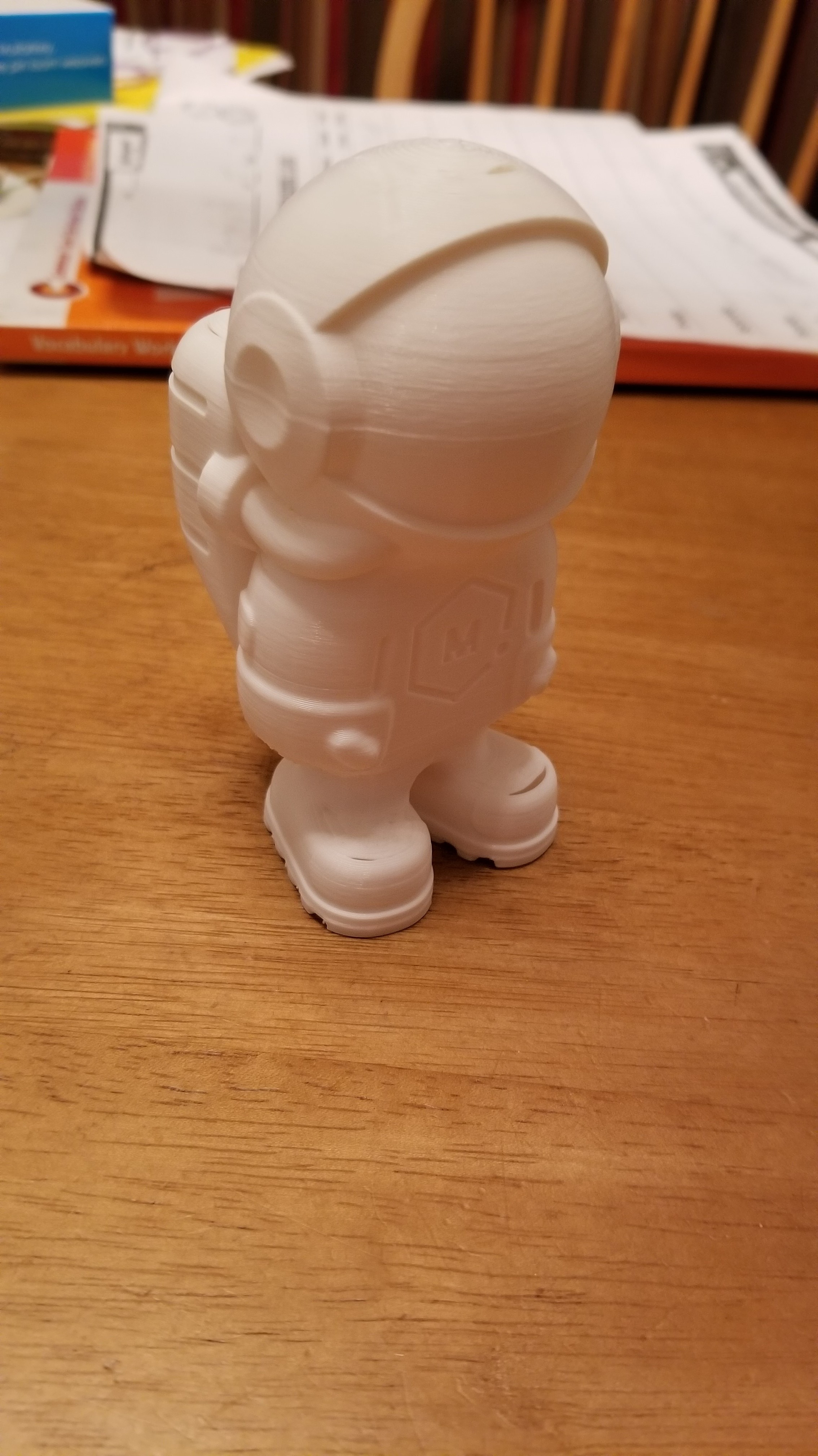

I printed this using ABS.
Any ideas what could be causing these issues? (see pics)
Temp: 220
Fill: 10%
Layer: .2mm
Shell: 3
Bed Temp: 110
Printer: PowerSpec Ultra

Probably this overhang area need to be supported, and 10% is quite low for the infill. Also what is the thickness for the top and bottom ? or numbers of layers?

The overhangs aren’t supposed to need supports. This is a new bench test model (like Benchy).
I don’t know the number of layers. I think the first layer was set to .25mm. Not sure about the thickness for top layer. I don’t have that setting.
