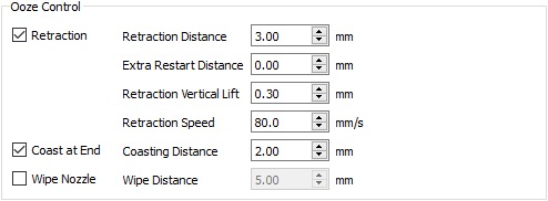

Oh, we’re going to get this working. FIRST, Simplify3d is awesome and you’re awesome for getting it. SECOND, and I say this only because I would hate to see other people yelling at you, but people might tell you to switch your display speeds to mm/sec instead of mm/min. Maybe not, depending on where you live, but if you want to, Tools > Options > Preferences Tab > Speed Display Units. THIRD, and this is just from my own personal experience, but 3000 mm/min (50 mm/sec) might be too fast for the smaller parts you are trying to print. I was printing a dozen small 28mm tall figurines for a buddy of mine, and was trying to print at 50-60 mm/sec, only to find that the figurines weren’t very smooth looking. Maybe try slowing down to 20 mm/sec or less? That may also help with the stringing between the arms and legs. May I ask what your retraction settings are? I spent a fair bit of time perfecting those for my Makergear M2 because I was seeing stringing, over-extrusion, and globs. I finally landed on the settings I’ve attached in the picture, and that also solved a lot of my problems with printing small figurines. Now, your printer will probably require some different settings, but hopefully that would be a good starting point. Let us all know if this helps in any way. And please feel free to ask as many questions as you want!
