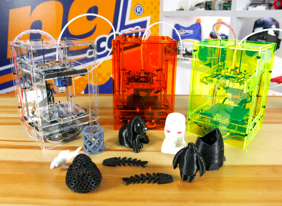

Cool. I would like to see how the Fabrikator Mini stacks up against this.
Nice job on the build though!
5-star Marvin! Only you, Arnie ![:wink: :wink:](/talk/images/emoji/apple/wink.png?v=5)
I haven’t really heard anything about that one, but damn its tiny!!! And cheap! Perfect for printing Marvins ^^

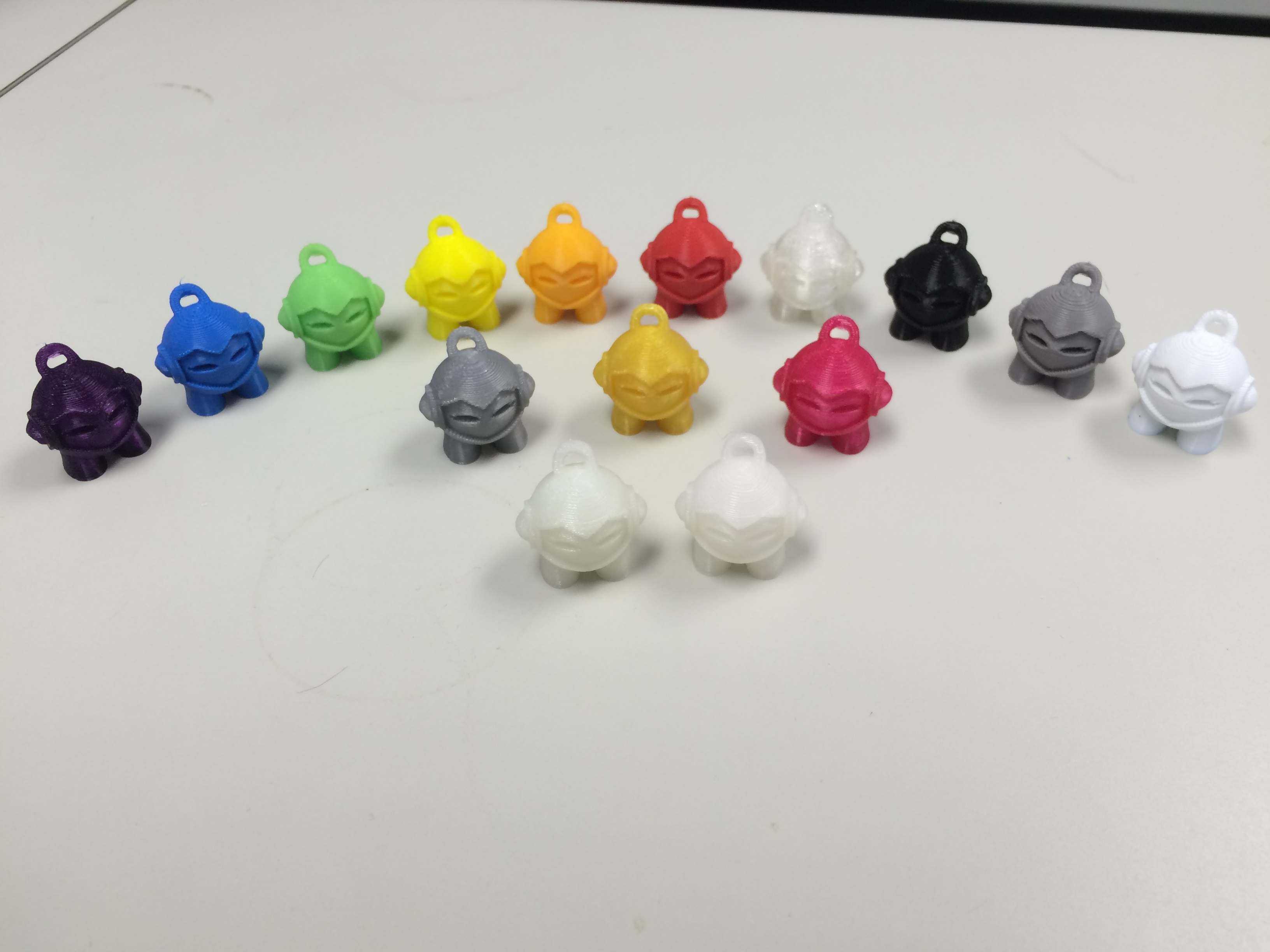

this was done on my Rep 2 at the course setting (0.3mm, 6% infill, 2 shells, varying temp depending on material used) and at the fastest rate. Each took just under 10 minutes. Shown are mostly PLA, a couple of PET-G, color changing with UV and Temp as well as a glow in the dark. Just finished one in copper that was not in the pic. The Marvin is a good way to test print settings, especially where the body meets the legs/feet, if your temps are too hot, you will get droops there, also strings at the top.
I have some in .1mm but the difference in the part was not that great and took 3x the time.
Whoah! Those are some real nice Marvins! Great job. For a 10 minute print they look awesome. I’ve made one in 6 minutes and it still looked pretty good. It was 0.25 layer height. Wonder how much faster can it get.
