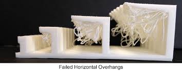

*There are some exceptions to this rule. ie flat “bridging” can work across small distances because the filament is anchored at the end of each point where the bridge starts. Although, drooping is common and can cause a print failure because the layers have to be perfectly level. As a comment on complexity, a model like this won’t print on FDM and would struggle on SLS because of the reasons discussed above;

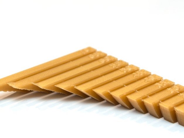

P.S. Try this Thingiverse overhang test to see how your printer fairs when you play with the settings!

I really like the picture of’Failed Horizontal overhangs", verry sculptural.
A print like this would be a nice addition to the “sample shelf” on the wall of my studio.
And a good article of course, thanks for sharing.
