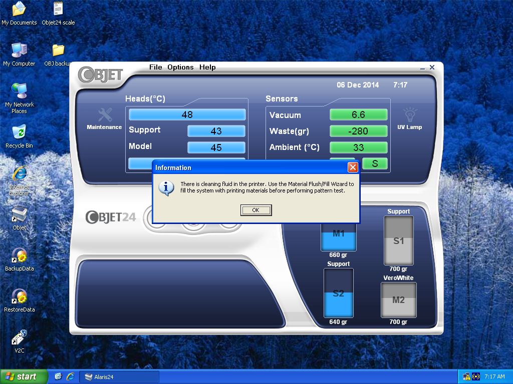

You mentioned you Purge manually? do you mean you initiate the purge sequence?
The trouble I am getting is that the Printer wants to do a material flush as it believes that I have cleaning fluid in not Resin, its all automatic, it is just a pop up message. Once I have this message displayed I can not do any other function except Material flush. I lost a litre of resin and support material on Sunday.
Have you ever experienced this? I am getting this error after every print now and really dont want to waste more resin.

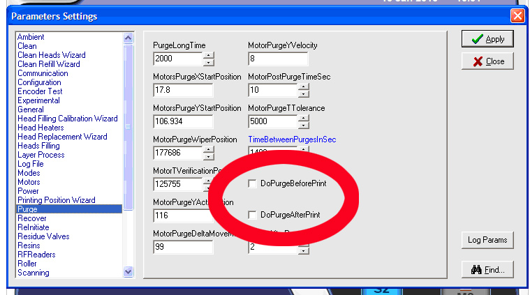

Hi Lee,
yes I purge manually. That can be switched within the maintenance/Parameters Settings menu, see picture. But always be VERY CAREFULLY what you change in the various maintenance menus. You can ruin all within your printer.
As I remember, here in the forum is anywhere described how to switch into maintenance mode.

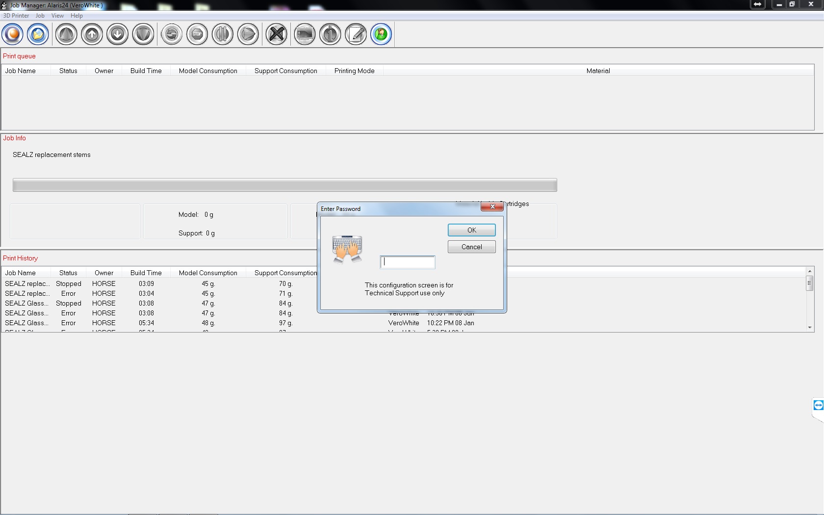

Thanks again Edgar,
I really appreciate the help.
I tried the Ctrl+Alt+M on the software I have on my laptop.
I am not connected to the printer here, so I dont know if it is that or the wrong menu.
Attached are some screen shots of the only menu that appears when I press ctrl+alt+m.
The first image is the only way ctrl+alt+m works. After I am in Job manager I go to the drop down menu, 3D printer and select machine properties. Once I have the next pop up box (the technical support configuration screen password) open I then can enter ctrl+alt+m, which gives me the menu on the second image attached.
I hope this makes sense and I hope the image attached shed some light on this problem.
Again, thank you for you help.
Kind regards
Lee

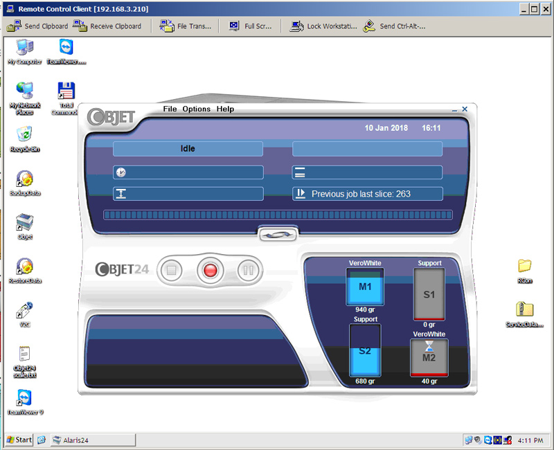

Hi Lee,
what I meant is the remote window of the embedded Windows XP inside the objet (see pic1) not any window in the local Objet-Studio-Software. Click into the middle of that remote window, then move mouse to lower right corner (big red arrow in pic2) and press Ctrl+Alt+m, then a warning message appears (see pic2). If you confirm, then a new top-menu appears and shows the additional maintenance menu items. (pic3)
For example the weight tests to control the right amount of printed materials. Weight test should be made two to four times a year. You cant do that without the maintenance menu.
I’m looking for years to get real service manuals for my Objet24 but its very very difficult to get those informations from service personal. Stratasys strategy certainly.
If you dont have access to the remote window or it looks different to my pics, then you have other software than I have and I’m afraid I can’t help you in that case.
best Regards,
Edgar

Hi Edgar,
I am in front of my printer now and I am doing all the work arounds you suggested.
I am just waiting for the Material Fill/flush wizard to finish and I will hopefully be allowed to do something.
I initially tried the CTRL+ALT+m and the warning pop up box appeared, warning me that if I proceed it is at my own risk. However after I click ok, nothing. I waited for the menu to appear but nothing yet.
I will wait for the material flush/ fill wizard to finish then I will try again.
Attached are some images of the error I have been getting on the printer.
I will keep you updated on my progress getting this printer back up and running.
Kind regards
Lee
Hi Lee,
was the mousepointer in the lower right corner while pressing Ctrl+Alt+m? If not, the warning message will appear but NOT the new menu item. So try again:
- click right in the middle of the remote window to make sure that the window is active
- mouse lower right corner
- Ctrl+Alt+m
If it doesn’t work then I know no other way to get into the maintenance menu, then better ask a service technician.
To the other error messages unfortunatelly I don’t know a solution.
Success and best regards,
Edgar
