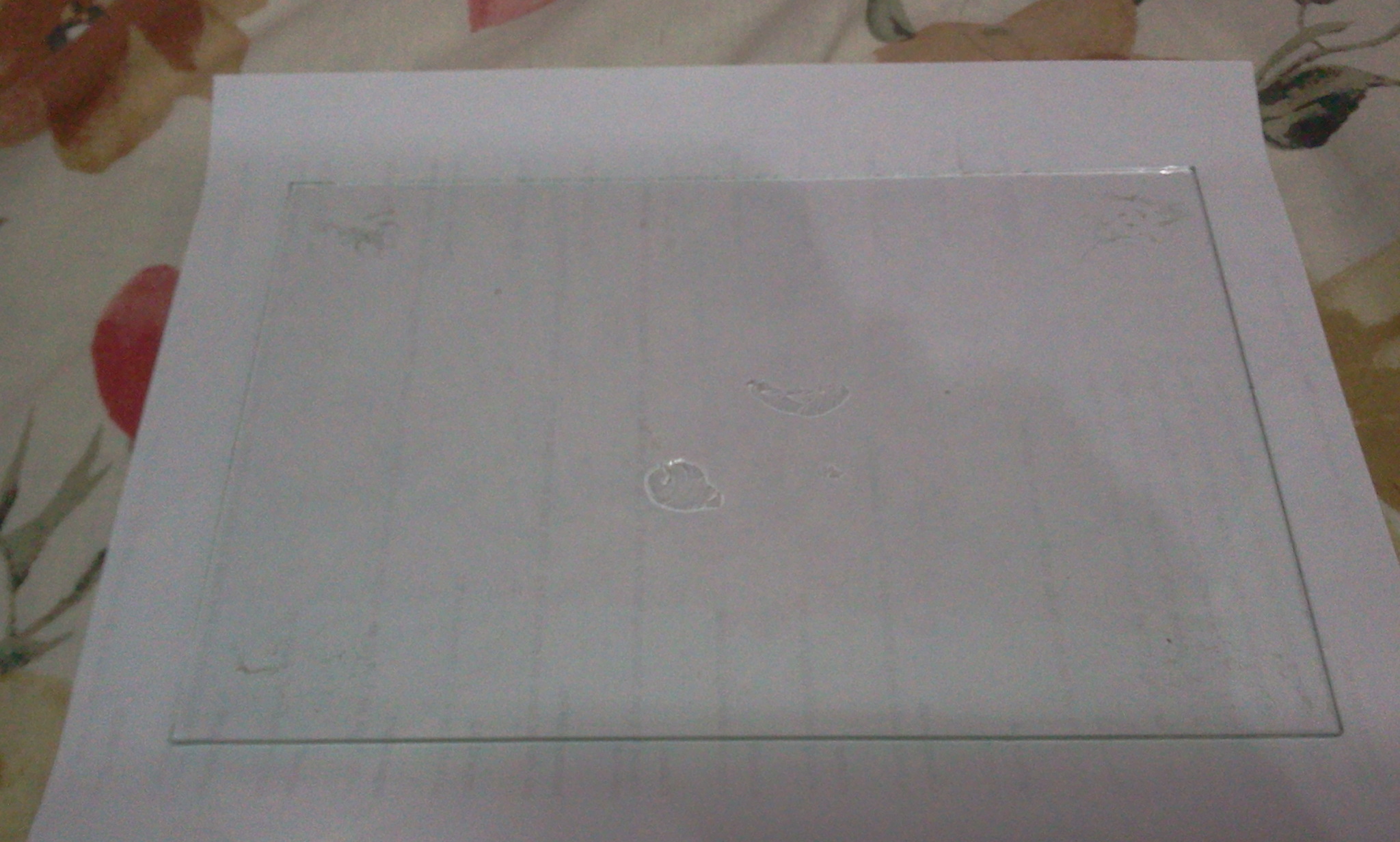

When printing with ABS my settings are as follows:
Glass Heated Bed : 110C
Extruder : 230C
Adhesive : 2 coats of Hairspray on Glass Build Plate
Every time I print large ABS objects, when I let the glass cool down to room temp and try to remove my prints, it always leaves potholes on my glass plate as shown in the image. Anyone has had this experience before and found a solution for it. I hate changing plates all the time. Thanks in advance guys.

I’ve also had this problem occasionally. It’s super annoying, especially since my build plates are expensive. The only fix for me was using kapton over the glass, though I suppose build tak would also be a fix. That comes with it’s own issues but better than replacing glass.

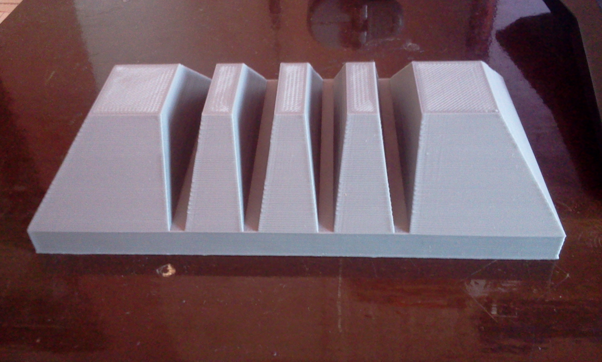

Hi Robert, thanks for the response. I printed something large last night just to test new settings I’ve been playing with using simplify3d. Basically what I did was, to lower the Heated Bed Temperature after the first layer from 110C to 100C. I also reduced my extruder temp as well, from 240C to 230C. To my surprise, when I woke up this morning, I found my object did not have any warp, and when I removed the glass build plate, the object just fell right off with no chip or potholes on glass. It was a only a 5 hour print with 5% infill , using ABS+ Silver of ESUN. I was just wondering if it is worth the money to change from ordinary 3mm glass to a borosilicate or tempered glass. Check the image below :

Lower your bed temp to 100C and try using less hairspray.

Cover the plate with kapton film, and don’t use hair spray. You are seeing horizontal fracturing of the glass due to temperature differences between the top and the bottom of the glass, the print itself acts as a heat resovoir, and creates the very high temperature gradient between the top and bottom of the glass plate, particularly where large parts of the print are in contact with the bed.
If you use kapton, it seems to resist the flaking action, but also becuase the ABS will stick to it when hot without any adhesive or sprays, it tends to release from te surface when the temp drops by about 20c.
You do however have to keep the kapton very very clean, the slightest trace of a fingerprint will cause the print to lift.
Basically by using a fixative or adhesive, you are disabling the ability of the ABS to detach from the surface, and the combination of the temperature gradients and the mechanical stress caused by the print shrinking are causing he pancake fractures you are seeing. Without the adhesive the part will naturally release and the stress will not build up.

Ya, I think I am getting substandard glass plates, never occur to me that it would be that bad. Posted, I tried lowering my Heatbed Temp and it worked perfectly. It was a fairly large object, and took 6 hours, the only think I changed was to lower my heated bed to 100C after the third layer, and set my extruder temp to 230C instead of what I was use to 240C.

I am having great success running my bed at 95C, I checked the temp and found it was running higher than the settings so I adjusted it down 5 degrees at a time and found 95C to be the magic number for my printer. I am not adding hair spray on every print, I just us a razor blade scraper to remove any high spots from the last print. I wash the glass every 20 or so prints. I am also using cheap 3mm hardware glass.
Hi Wrbehel, thanks for the response. You are right on the money with that 95C, though with mine I am using 100C. I had 4 successful big prints since my post. What I do is set my bed to 110C for the first four layers, then turn in down to 100C for the rest of the prints. I wash my glass every print and apply hairspray. I know it’s a lot of effort but it’s the only way that I could ensure perferct, unwarped prints everytime. I do this if it’s client prints I am doing, but if its for myselft, sometimes I get lazy and not clean my glass. I hope this is it, I hope don’t get potholes anymore and warping. Thank you very much.
