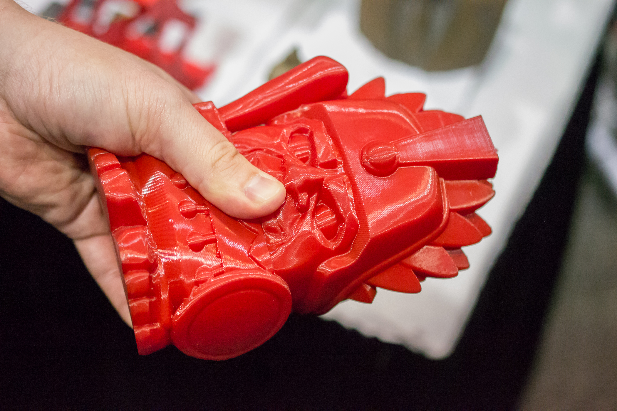

For small detailed Ninjaflex prints and reliability there’s really only one option - Lulzbot with a Flexystruder (either the Mini or TAZ5). If it’s just small prints, then the Mini should be perfect for you. I recently saw them at a trade show with a Lulzbot Mini making these amazing little Aztec figurines out of Ninjaflex on the new V2 Flexystruder. You can see a picture of one here:
AFAIK this is the only hotend specifically designed for flexible filaments, and I’ve read that Fenner Drives, makers of Ninjaflex, use Lulzbot Flexystruders themselves in development and testing of Ninjaflex filament.
As for reliability, Lulzbot has received top scores from both 3D Hubs and Make.
