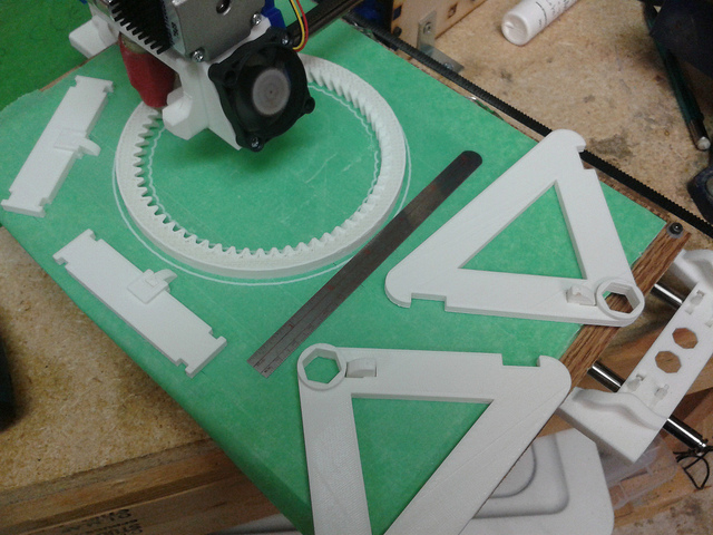

The curl depends on how much you can bend the base. The thicker the acrylic, less warping. Same with glass on the heated bed printers. I use 2.8 mm glass
The prints really stick to the surface so once in a while I use a little bit of lip balm or bee wax on the bed to make it easy (very) remove. But when you do make sure you sand it too. To compensate…
Nice! Will have to experiment with that. Currently I’m throwing around a (very heavy) glass mirror and it’s causing ringing/harmonics to show up in the print job. Am looking for lighter alternatives (I’m also printing a better design that doesn’t torque the bed so much).
COOL!
I want those custom parts you have! Did you design them? How big can you print?
You definitely need to try the acrylic sheet, a lot lighter on your printer. Will help you get even better prints…
Ha - no I’m not nearly that smart. They’re designed by Jon Lawrence - he’s got designs loaded to Thingiverse (Thingiverse - Digital Designs for Physical Objects) and YouMagine (YouMagine – Designs by iamjonlawrence on YouMagine)
I currently can print 200x220x90 (lost some height in the conversion). I’m printing his designs from YouMagine and in between building a Printrbot #Frankenbot, hope to transfer the Simple guts to the new design from YouMagine (which will give the bed rods/bearings a wider stance and put the stepper between them - that should dramatically reduce the amount of twisting the bed does).
