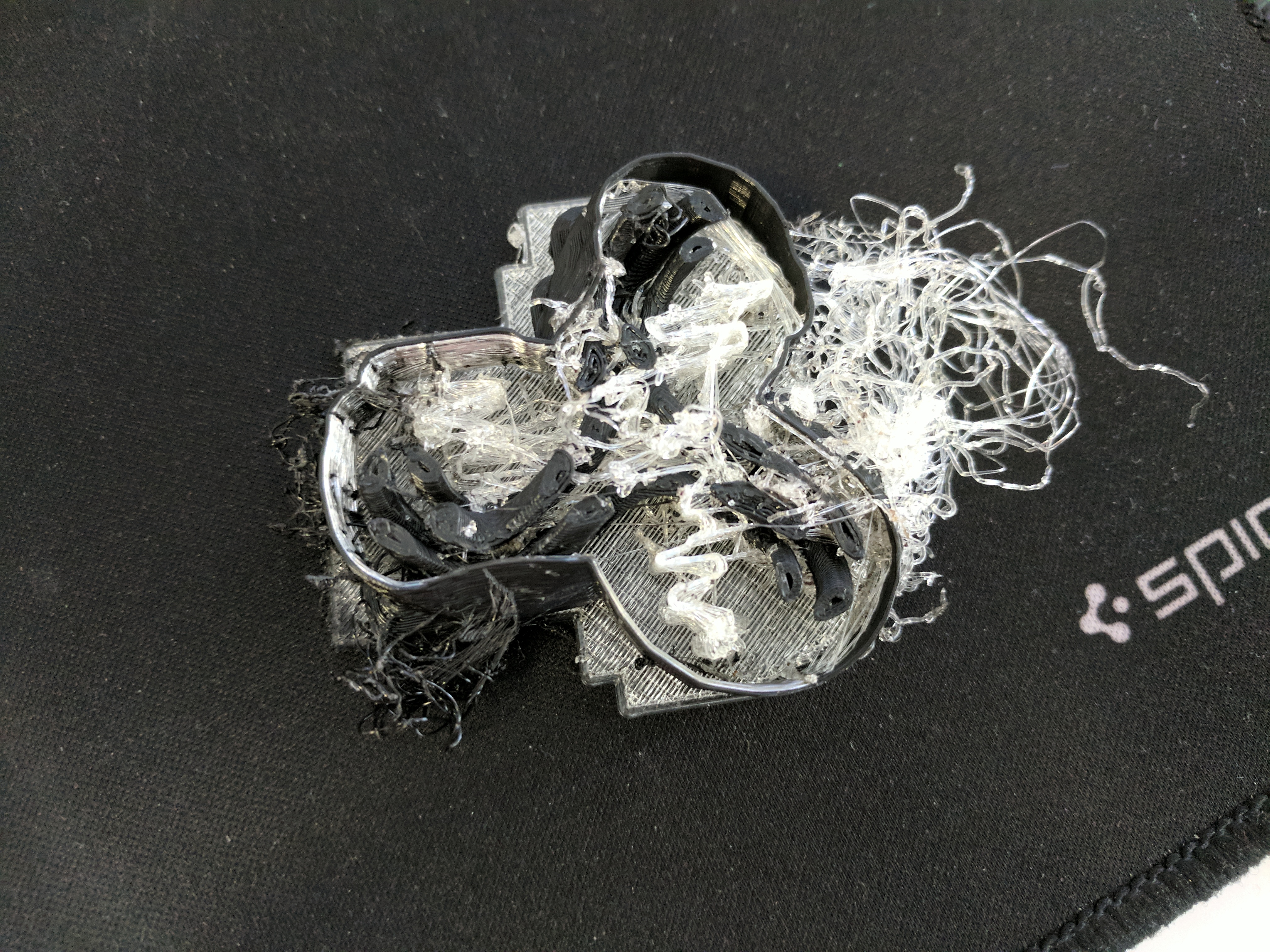

I’m trying to perform double extrusion wit PLA+ and PVA but I’m unable to get it work.
the PVA supports are not forming correctly and there’s a lot of Oozing Attached image.
My current configuration is:
PLA: 200°C 50mm/s
PVA: 190*C 25mm/s
PLATE: 60°C
FAN (ON)
Where is my misconfiguration? ![:frowning: :frowning:](https://www.3dhubs.com/talk/images/emoji/apple/frowning.png?v=9)

I personally print the pva at the same speed and temp as my normal pla, so in your case try increasing the speed also its hard to tell from the photo exactly whats going on if you could upload more reference photos id be happy to help
