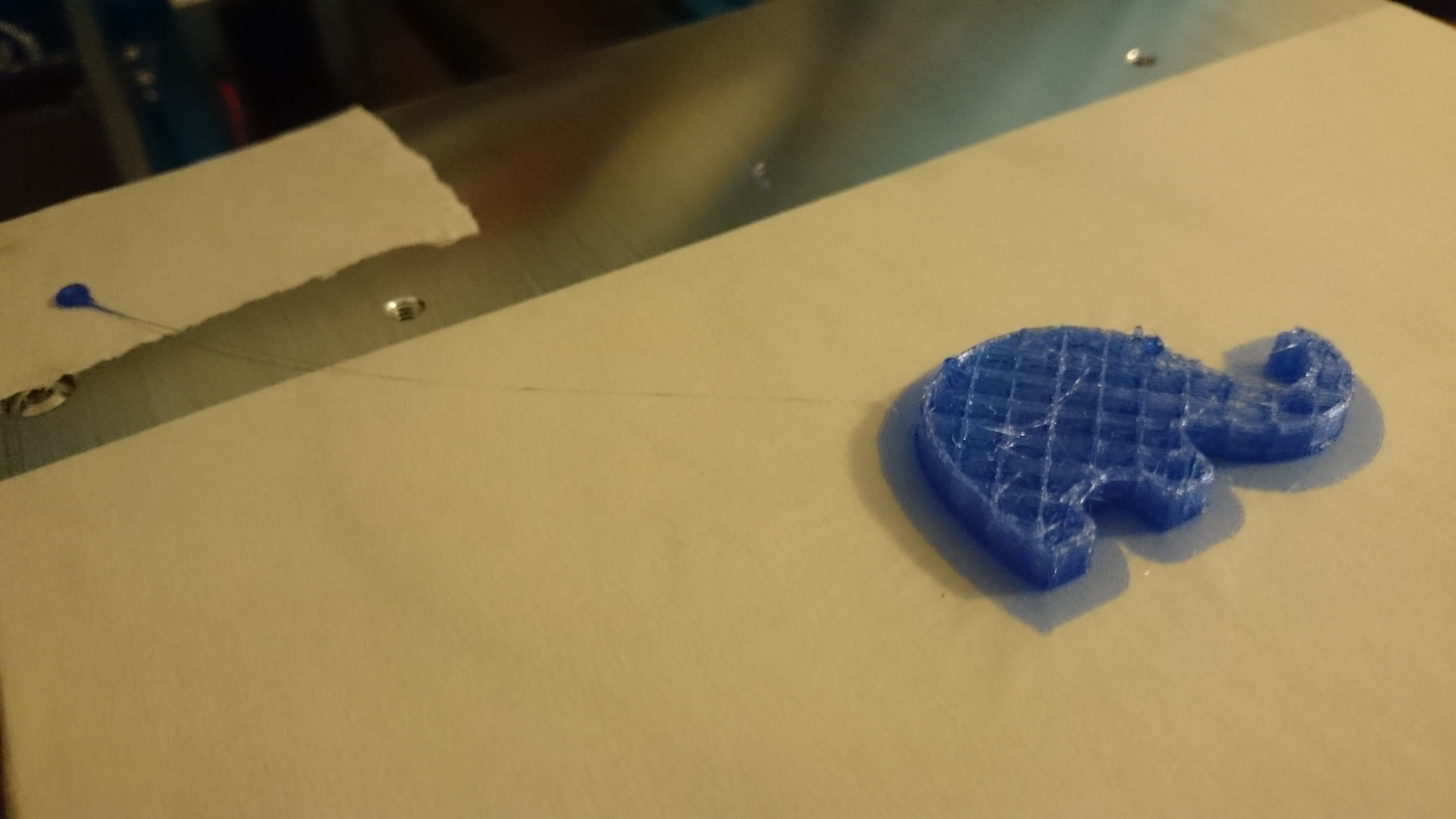

Here’s an update: i measured the width of the filament and it’s indeed not 1.75mm but 1.80mm, did find some other settings and fiddled around again but I keep having the same problem. The filament won’t push through the hot end after ± 15 minutes. I added some pictures which might help. The company who makes the filament (Octofiber) suggests printing at 210. Maybe 230 is too high? Though i read a lot that PETG likes higher temps and lower print speeds.
