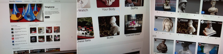

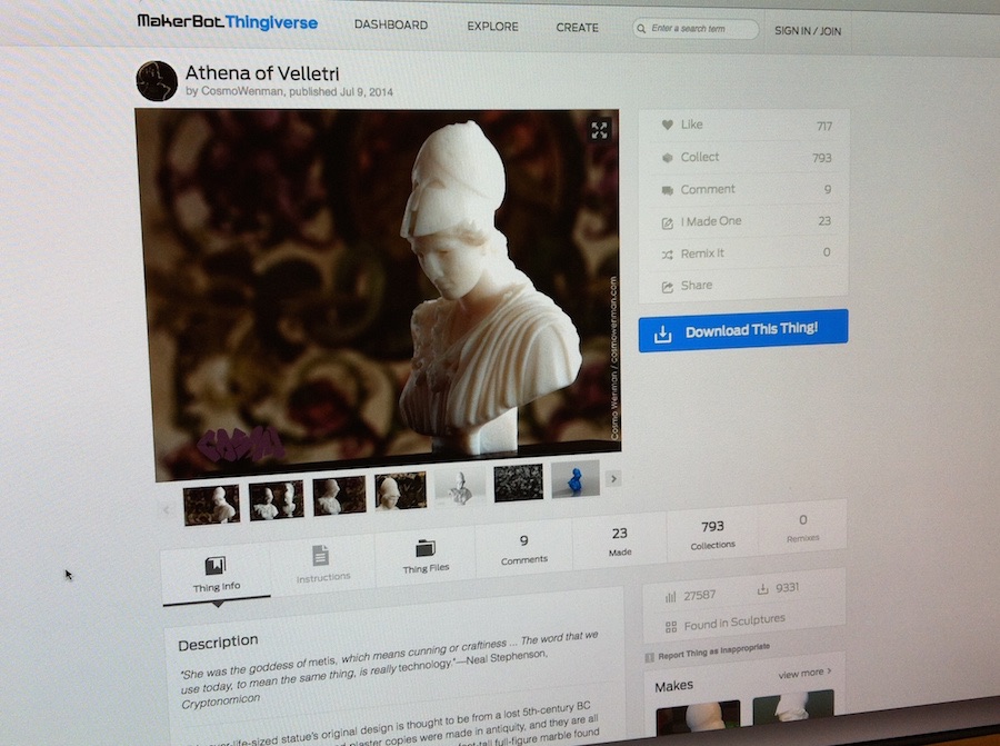

I found a .stl file on Thingiverse.com (other websites are available).
I wouldn’t exactly say it was a carefully thought out selection process.
It was more like this.
Ahhhhh, Athena.
Athena of Velletri, I presume?
The short excerpt from Neal Stephenson on the Thingiverse website reads, “She was the goddess of metis, which means cunning or craftiness. The word that we use today to mean the same thing is really ‘technology’”.

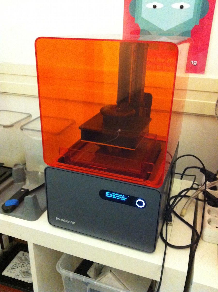

But the Form1+ appeals to me.
It’s quiet.
A different breed.
It slowly pulls the printed piece out of a resin tank as lasers dance across it.
Which is way more sci-fi, and cooler.
At least, in my opinion.

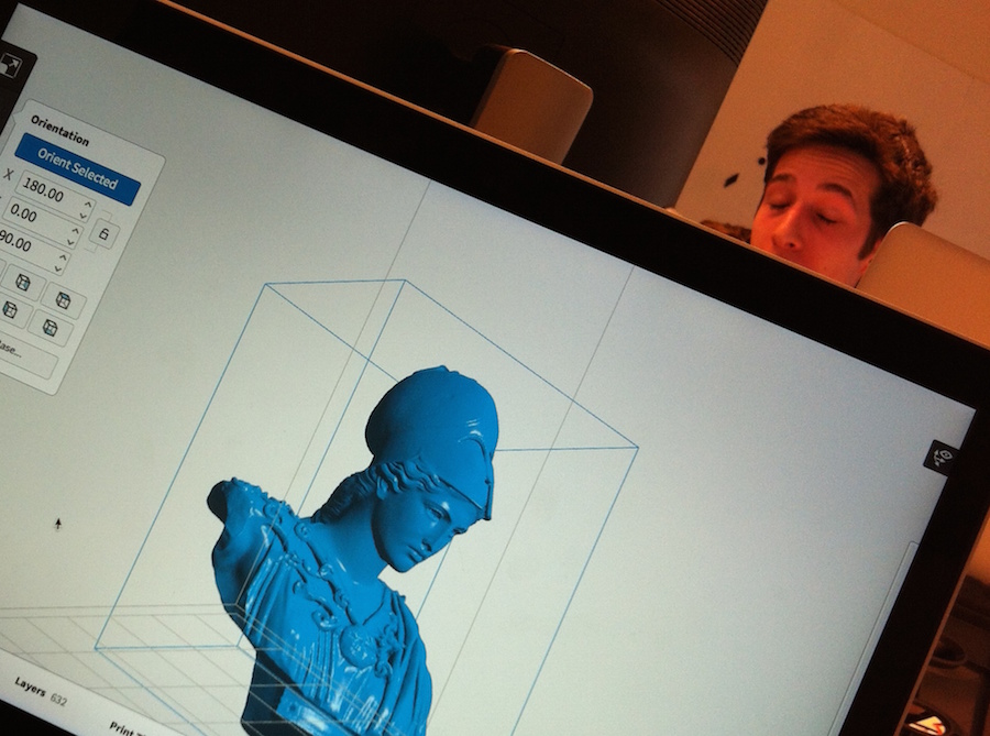

Just to be safe I moved the model to the side of the build plate where the resin tank was still nice and clean.

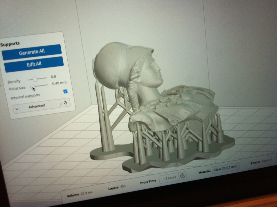

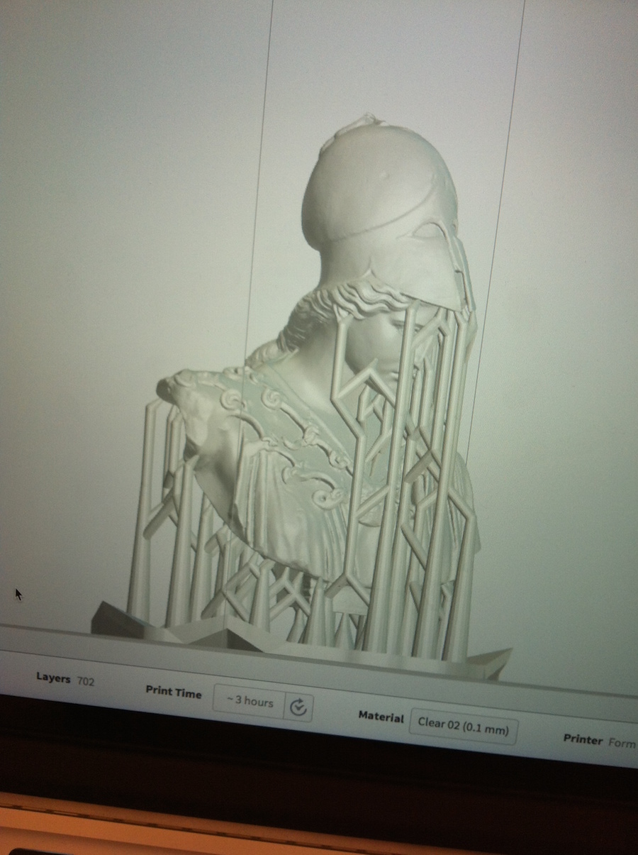

The Formlabs software - Preform - is pretty good, right?

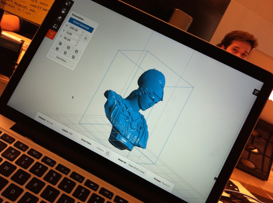

As I set up the model I sensed that a very tall man was watching my laptop over my shoulder.
It was Robin, our Head of Customer Support.
He’s very good at 3D Printing.
After some discussion, we rotated the model so that the supports didn’t touch the face.
We also made the point size as small as possible.
“This will make it much easier to remove from the supports when it’s finished.”
Said Robin in his heavy Dutch accent.
Much better.

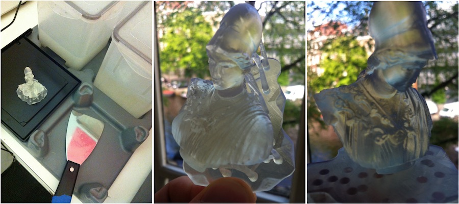

The print didn’t take long.
Maybe an hour or so.
After it had dried Robin used a metal spatula to pop the print off the build plate.
Quick acetone bath for Athena.
Then about an hour of drying off whilst I did some work.
Once it was no longer damp the supports easily clicked off in my hands.
If the resin finish gets too cloudy then it can be polished with paraffin to regain that shiny aesthetic.

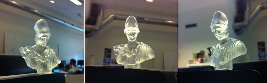

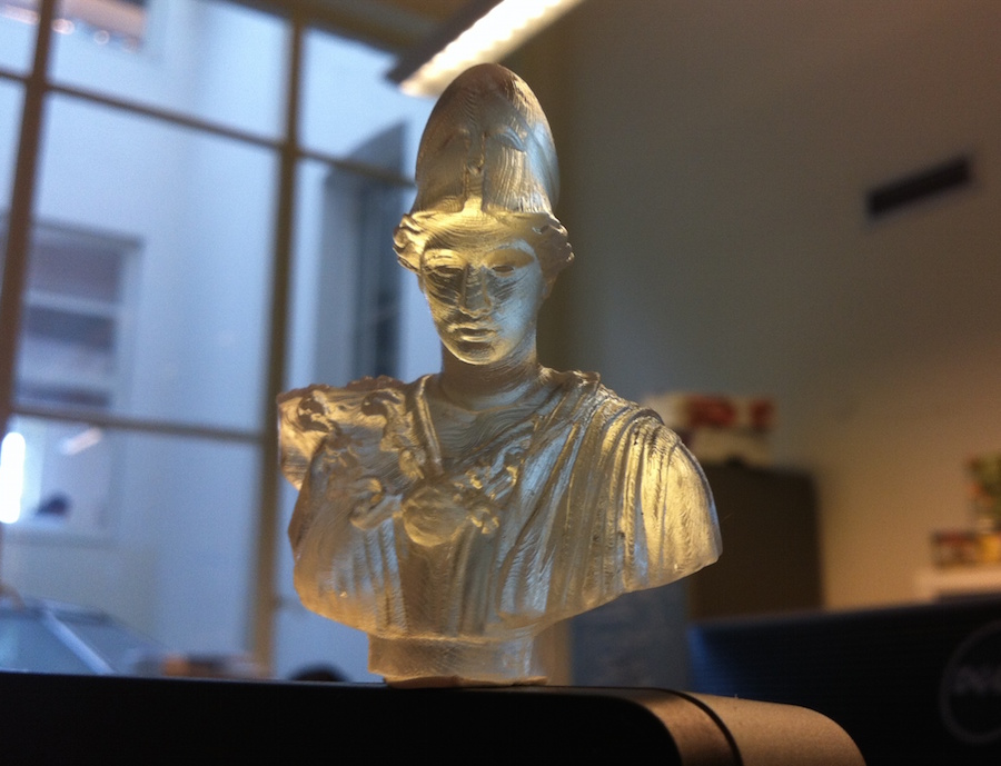

I held the finished piece up to the light of the window and admired the print quality.

So after my unplanned durability test it was just a matter of some quick filing to smooth off the points of contact from the supports.
Then I stuck Athena on the corner of my monitor.
