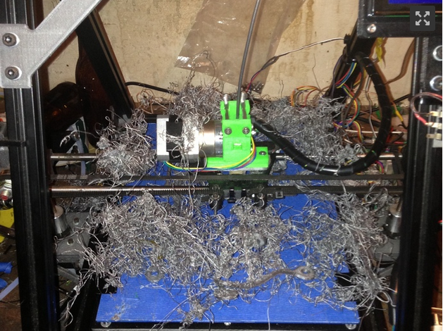

Printing the first layer can be surprisingly tricky, especially when you are setting up your printer for the first time, have recently made some heavy modifications, or are testing a new filament. Here I’ve compiled some tips and tricks to get that first layer down perfectly. As always, feel free to share your experiences in the comments too!
(not a good example of a first layer)
http://www.thingiverse.com/thing:44267
What can be so hard about the first layer? Why’s it so important? Getting that first layer right is an indicator of a lot things. Such as, a correctly leveled bed, right filament temperature, correct extrusion amount, etc. In short, getting that first layer right is a good signal* that your print won’t fail. You can save yourself a lot of time catching errors in the first layer(s). Its better to reprint with different settings after only 5 minutes of printing, rather than 5 hours. Also, if your print isn’t sticking, without a desperate application of ducktape, there’s no way the print will succeed.
