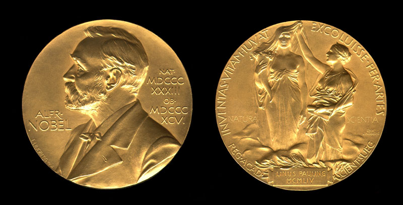

Can someone create a design file for me for a medallion that I have .jpeg file in. I can convert to PDF. How much will that cost?

But still you want to convert this to 3D , please attach te jpeg to have a look?

I would need it converted to an .stl printable file. It just has to look like a medallion. The material doesn’t matter. The diameter would be 66mm. I’ve heard ColorFab Broze Fill Filament or ProtoPasta’s Metalic PLA could work. A 3D extrude would work as well. I will attach the .jpeg for you to look at. Some people have told me that it is so high in detail that it might be difficult to replicate.
