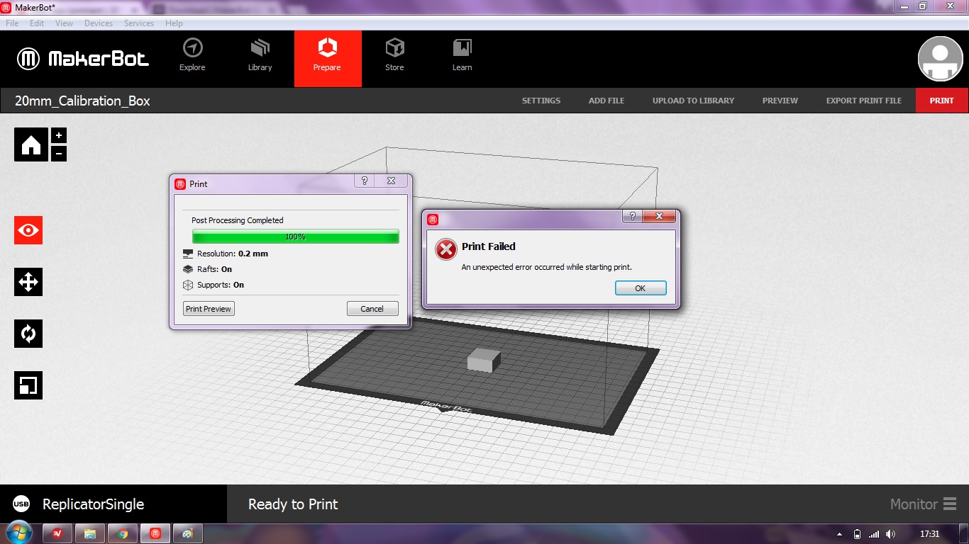

I’m a teacher in a new school and I rooted out an old MakerBot Replicator with original lazer cut wooden frame.
I installed software from Makerbot but when I try to print from Makerbot Desktop it gets to 54% then says that the prit failed
I installed MakerBot Print, also, and when I stop desktop running in the backgroup MakerBot Print still cannot from the printer as a printer in the options.
Any thoughts on how to get this working??
Thanks in advance,
Dermot.

is there any indication beyond it saying print failed?
Does it just stop at a location and not go further or does it go to home and stop?
if you reprint the file does it stop at the same point every time?
What fails at 54% - the print or the slice? If it’s the print, is your computer going to sleep? That disconnects the USB.

Makerbot Print doesn’t support legacy printers very well; as far as I know, it does not support dual extruders at all. I would suggest uninstalling it and installing its predecessor, The Desktop App. Here is a link: https://support.makerbot.com/troubleshooting/makerbot-desktop-software/software-download/download\_12190

When buffering to the printer, it actually goes to the “post processing” phase and then says it fails.

It’s possible there is something wrong with the stl file. The Desktop App has example files. Try printing one of those. Start with the 20 mm cube.
