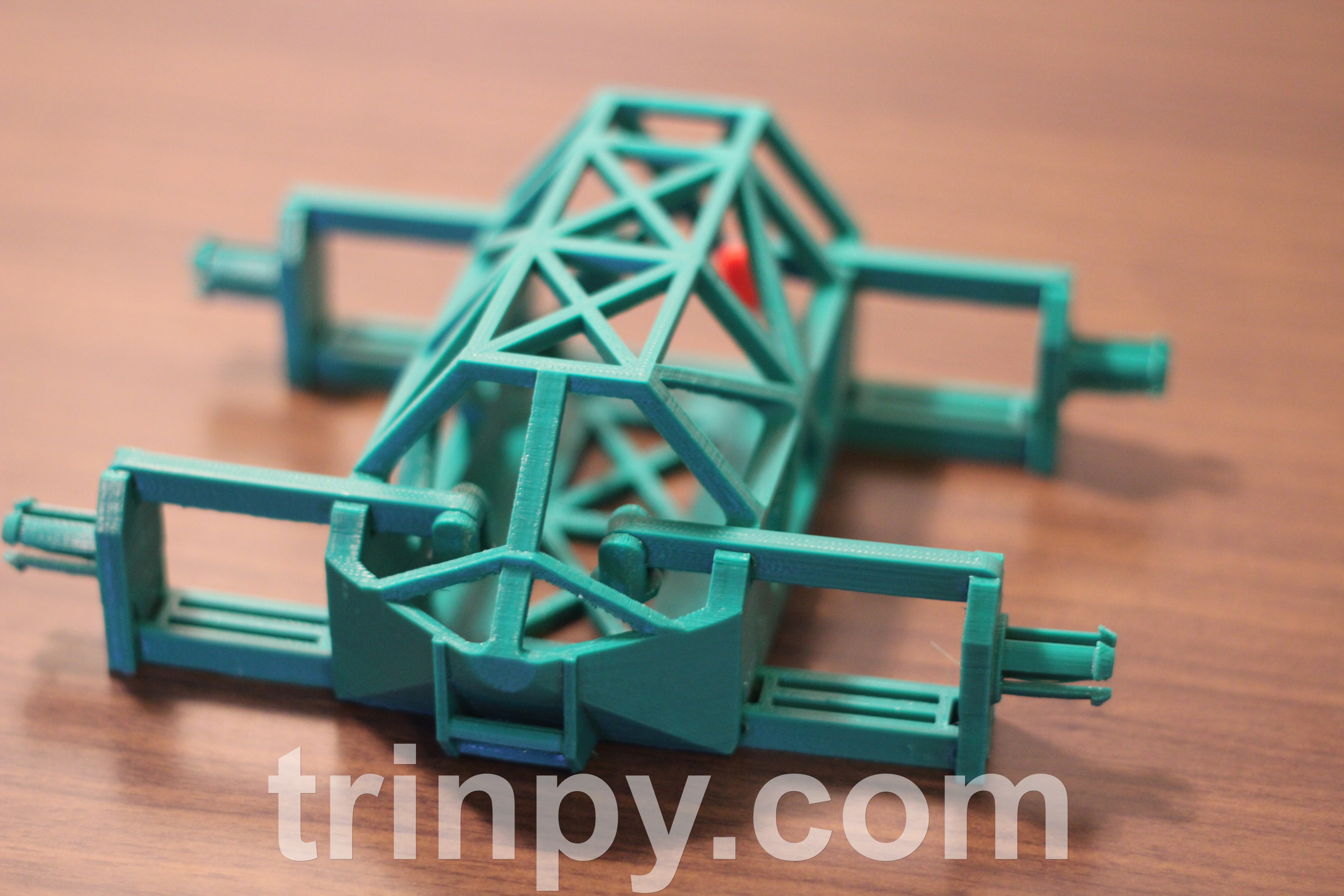

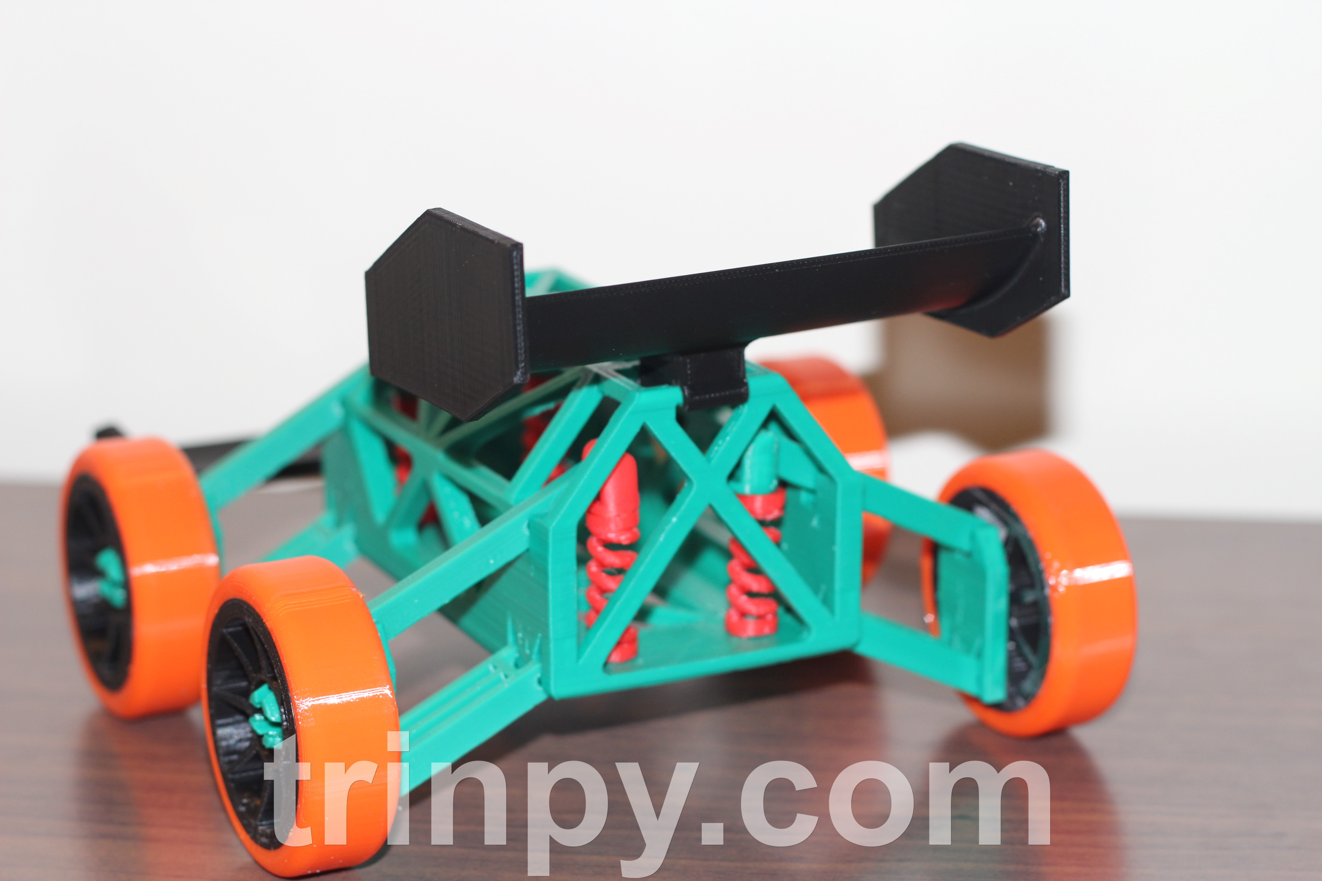

Here is my off road dune buggy design that has working suspension and linkage. I have put wings and slick tyres on it just cause I thought it looked cooler.

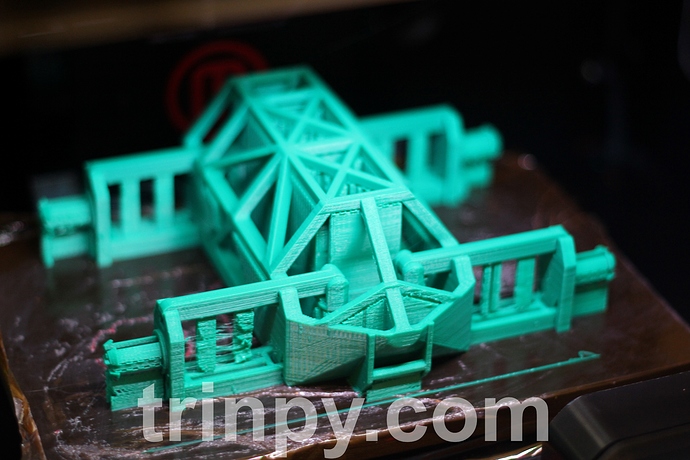

The idea behind it was to create the car and suspension linkages so it could all be printed in one print so that it could be created with stronger elements as the pieces didn’t have to be assembled. This design is printed with the chassis, linkages and suspension elements all in one. I made the springs separately so that they could be a different colour but it could be printed in one piece, see below.
Print settings
All the parts were printed in ABS except the tyres (orange) which were printed with NinjaFlex. Printed with 3 layers and 10% infill, support is required for the springs and chassis. The parts all clip together with no glue or other fasteners required and it is extremely strong. Video of cracking the linkage after printing here:

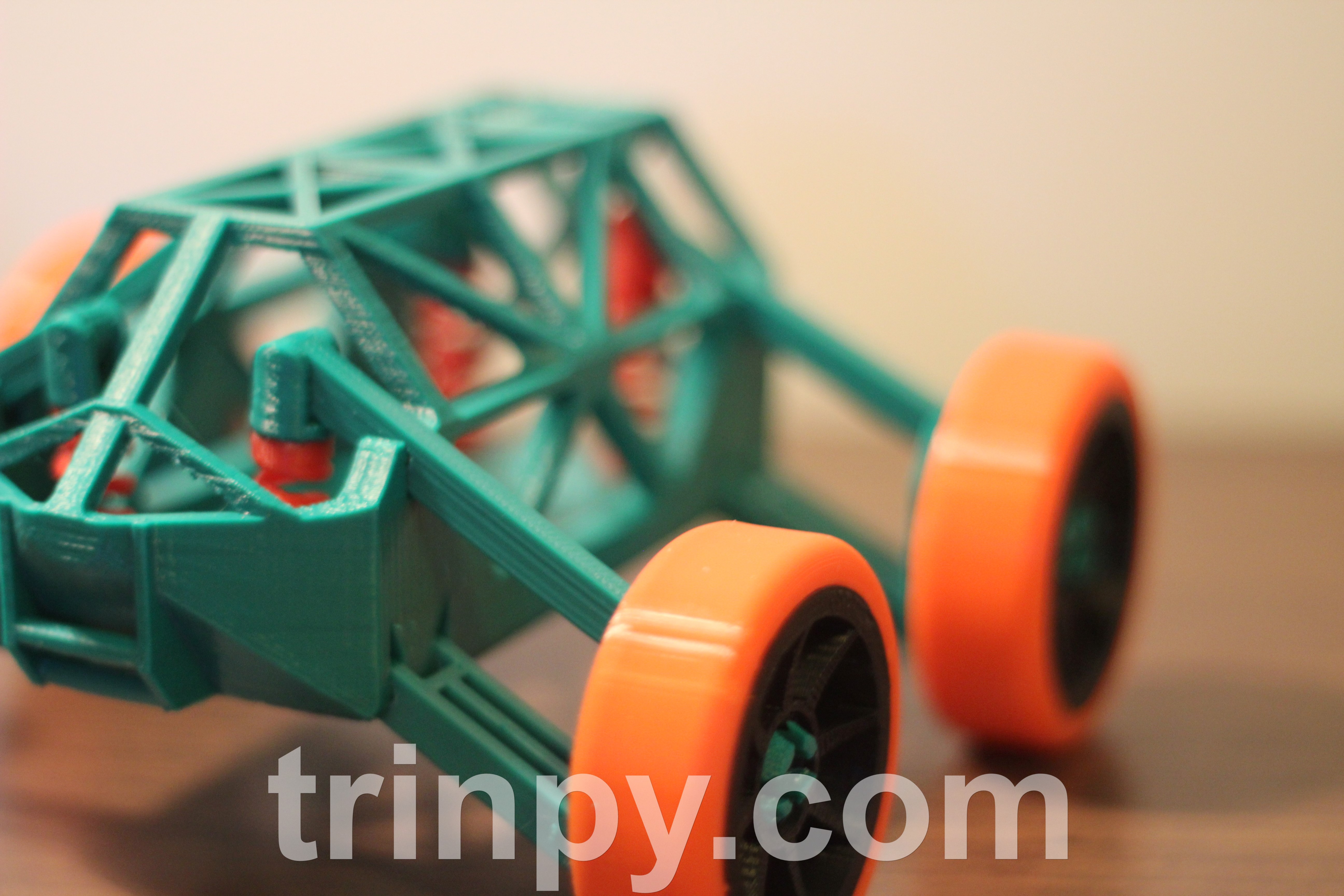

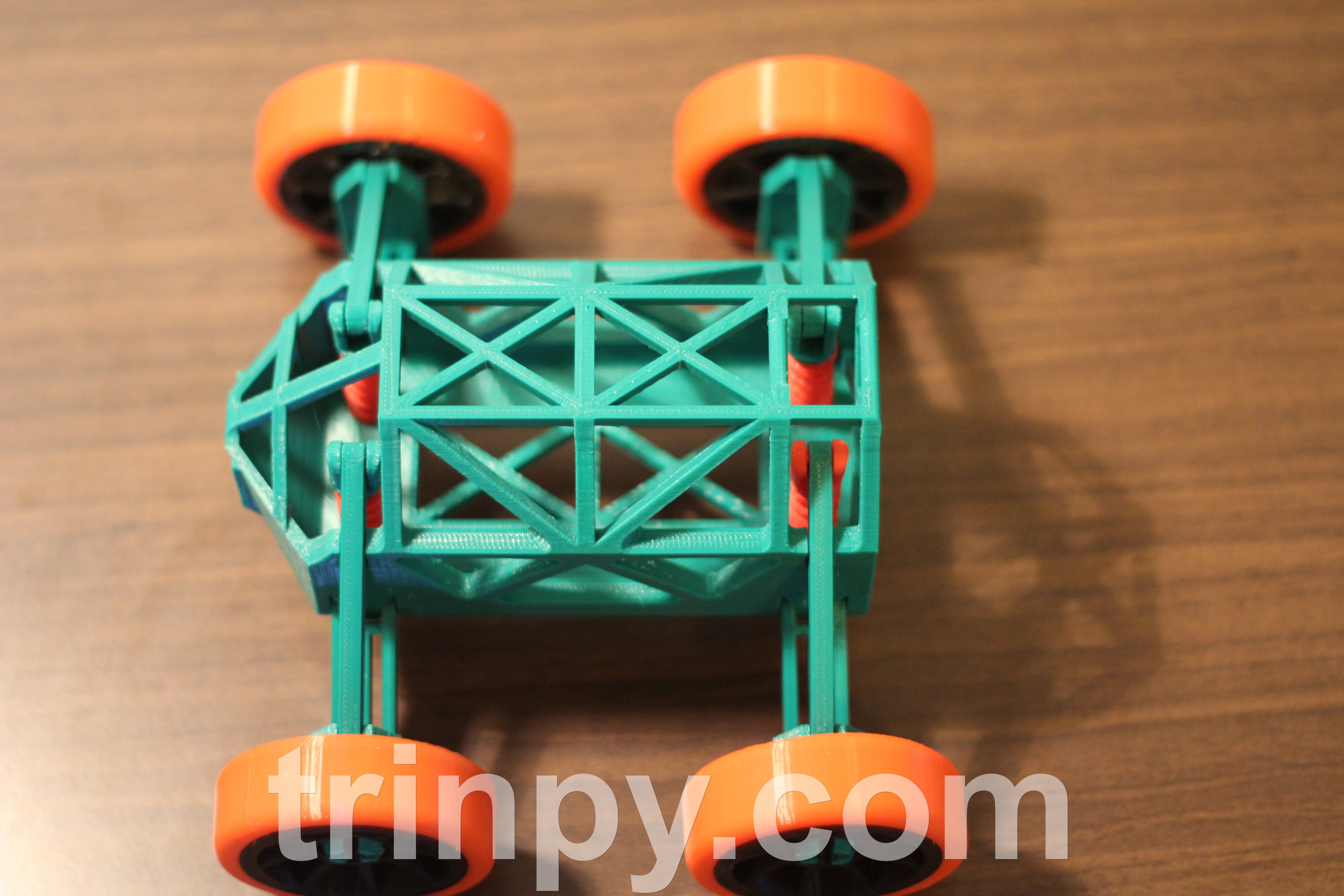

See the suspension movement in the photos below.
