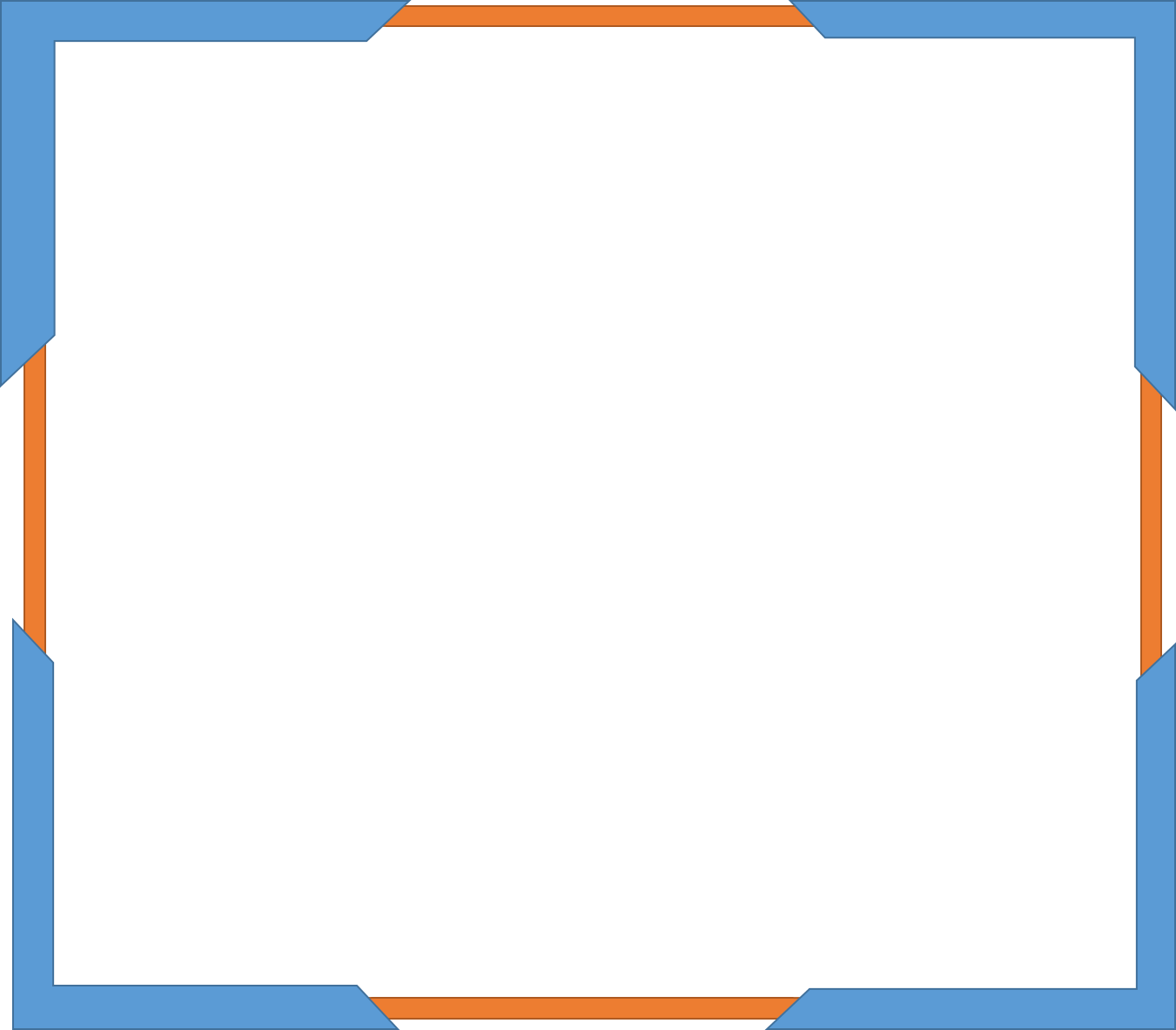

To add to this problem solving mission you’ve all dived into, we are needing it to fit into a large but manageable sports bag. The aim of which is to begin distributing around the country… exciting times. So the main points are:
2x2m
grippy for indoor use
collapsible to fit into sports bag
as slim as possible to reduce the trip hazzard
ridged to a point, just so it holds it shape
We have had the idea of having larger corners and shorter sides (see pic) to get round the length issue… but again open to suggestions.
