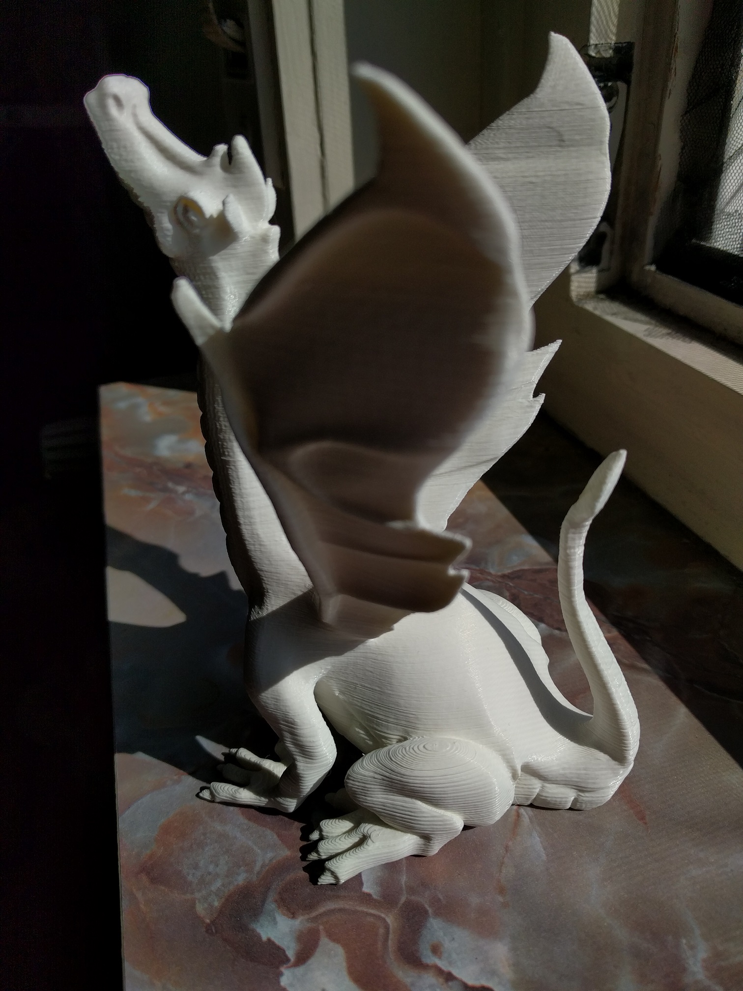

I have been playing around with my new Prusa i3 MK2 for a few weeks now but I just can’t get really good prints. This printer is starting to get on my nerves…:frowning:

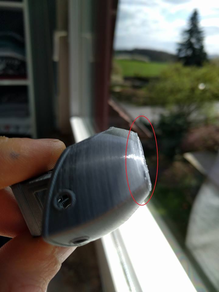

I have done some prints right after the printer was setup using the included silver PLA, the prints came out pretty good…see pictures…
Now after trying some Fillamentum ABS, things start to look different.
I have the Prusa in an enclosure with 2 fans, one blowing in air onto the rambo board (not blowing directly at the heatbed) and the other one is blowing air out to the top.
I noticed that the life z adjust value for PLA is somewhere around -0.660 and for ABS it’s somewhere around -0.710. ABS has an extrusion multiplier of 1.05.
All prints where printed at 0.2mm layer height and sliced using slic3r.

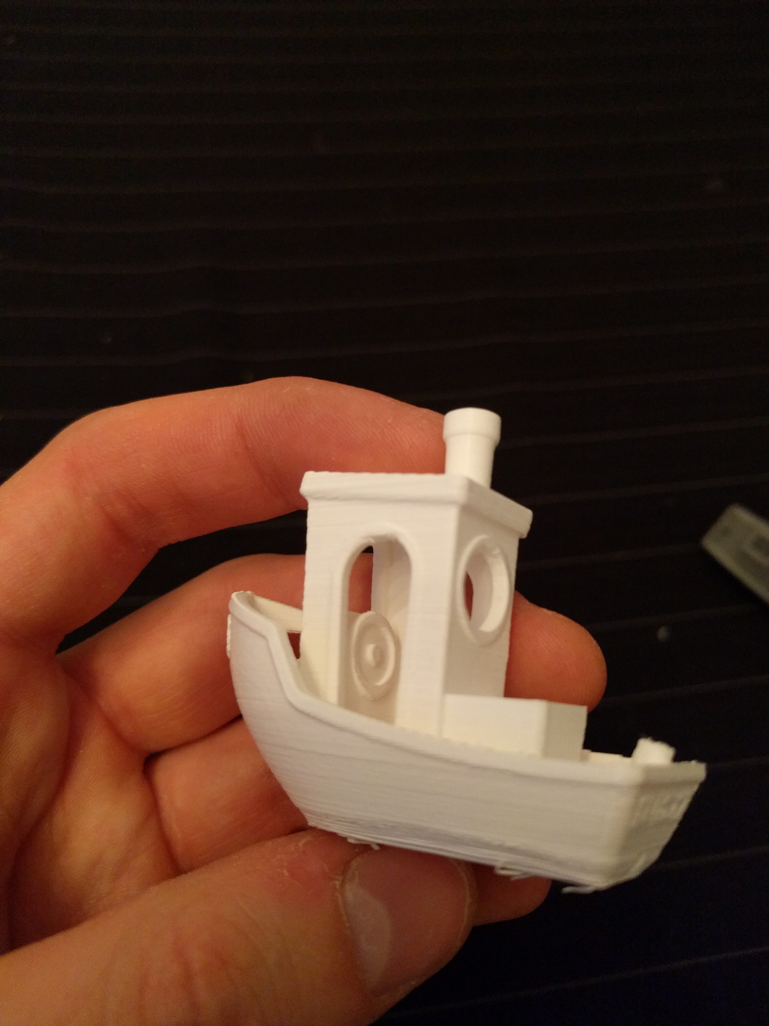

Can someone tell me why the white Benchy looks the way it looks, and why the white Adalinda and corse ridges near the bottom?
Thanks!

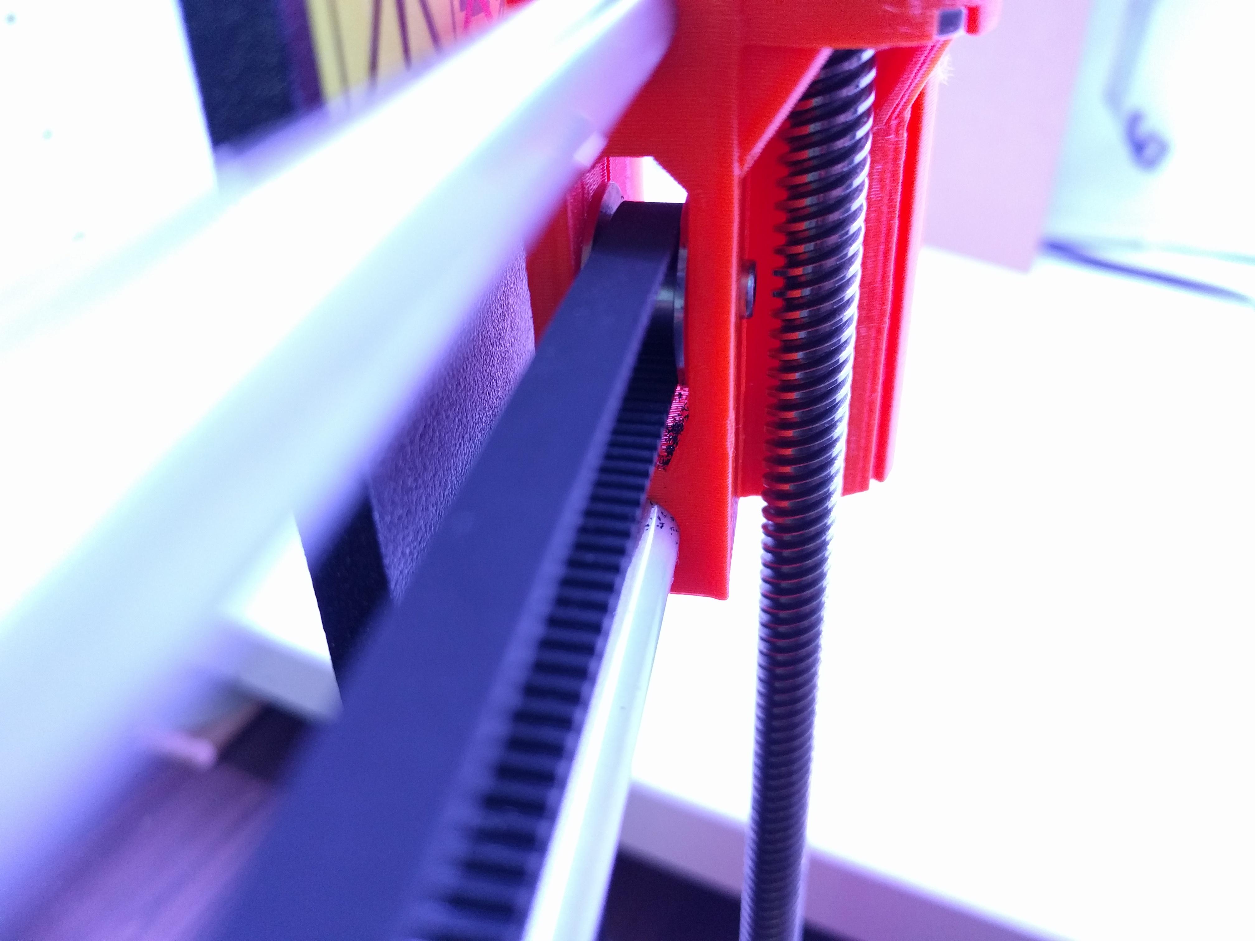

Yes I am using the Prusa version of Slic3r. Also using the Fillamentum ABS Settings, 240 HE and 100 Bed. I noticed that the X belt is rubbing against the Idler, maybe this could be causing some problems?
Problem is…I can not get the belt to be in the middle of the idler…Impossible.

The belt could be an issue. Thy Y belt is usually an issue because the motor twists. There is a little brace you can print and put between the motor and the threaded rods to help this out.
On the X belt. I would look at the centering of the drive pulley. I have heard others have this issue. There is a large Facebook group for the original prusa printers that can be helpful.
Hi there… have you tried with a extrusion multiplier of 1 instead of 1.05? It seems like is a bit overextruded
Looks like you may have a patially clogged nozzle and/or are printing a bit cool. You may also should probably adjust your PINDA height. With that much correction the mesh bed leveling will not be as precise.

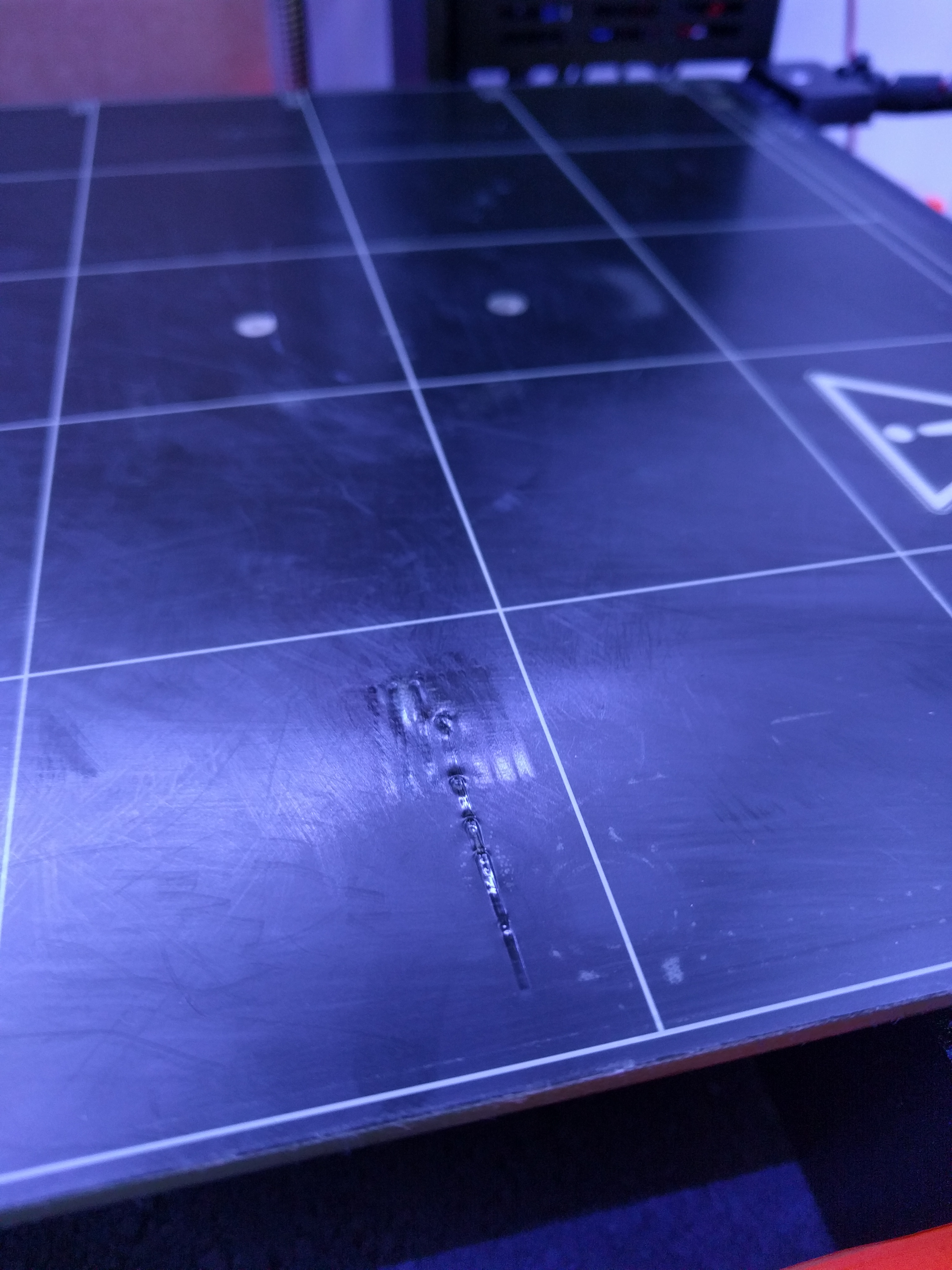

Oh no. I really would have left it alone. It was ok and the prints were pretty good just fine tuning. Fortunately it looks like it didn’t damage the bed itself. I would give the bed a good heat and gently see if you can smooth it any.
About the most you can get is about 110 for ABS. It is just a thought that it may settle down a little but I would be real careful also. Don’t want to make it worse! Right now it is near the edge so you should be able to print around it pretty good. I just was worried about calibration that the nozzle might catch it.
For a while I would run initially with my hand on the power switch ready to kill it if it acts up.
Aside from here this would be a good one for the Prusa forums. A lot of PEI gets torn up on new builds!! It happens so don’t despair.

I printed another white Benchy out of PLA. It looks underextruded. The gray Benchy out of PLA was one of my first prints when I first set up the printer. It was pretty much near perfect.

You might rotate him on the bed so he faces a different direction and see if things change. It is hard to see in the pic what is really going on. What are the temps?
