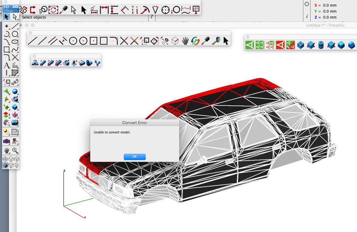

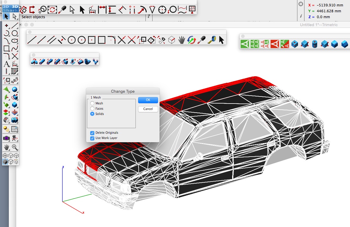

Hi Leanne,
I’ve had a quick look.
Although I can import the model in my professional 3D modelling software, it is not possible to stitch the mesh together and convert it to solid. See attached screen grabs.
The model is also very faceted, I don’t think it will give you a good final 3D print.
My suggestion would be to re-model the car and then hollow it. If you’d like help with this, please raise an enquiry via my hub https://www.3dhubs.com/leicester/hubs/designeering …we can discuss your project further there and give you a cost for the work.
Hope this helps.
Sébastien
