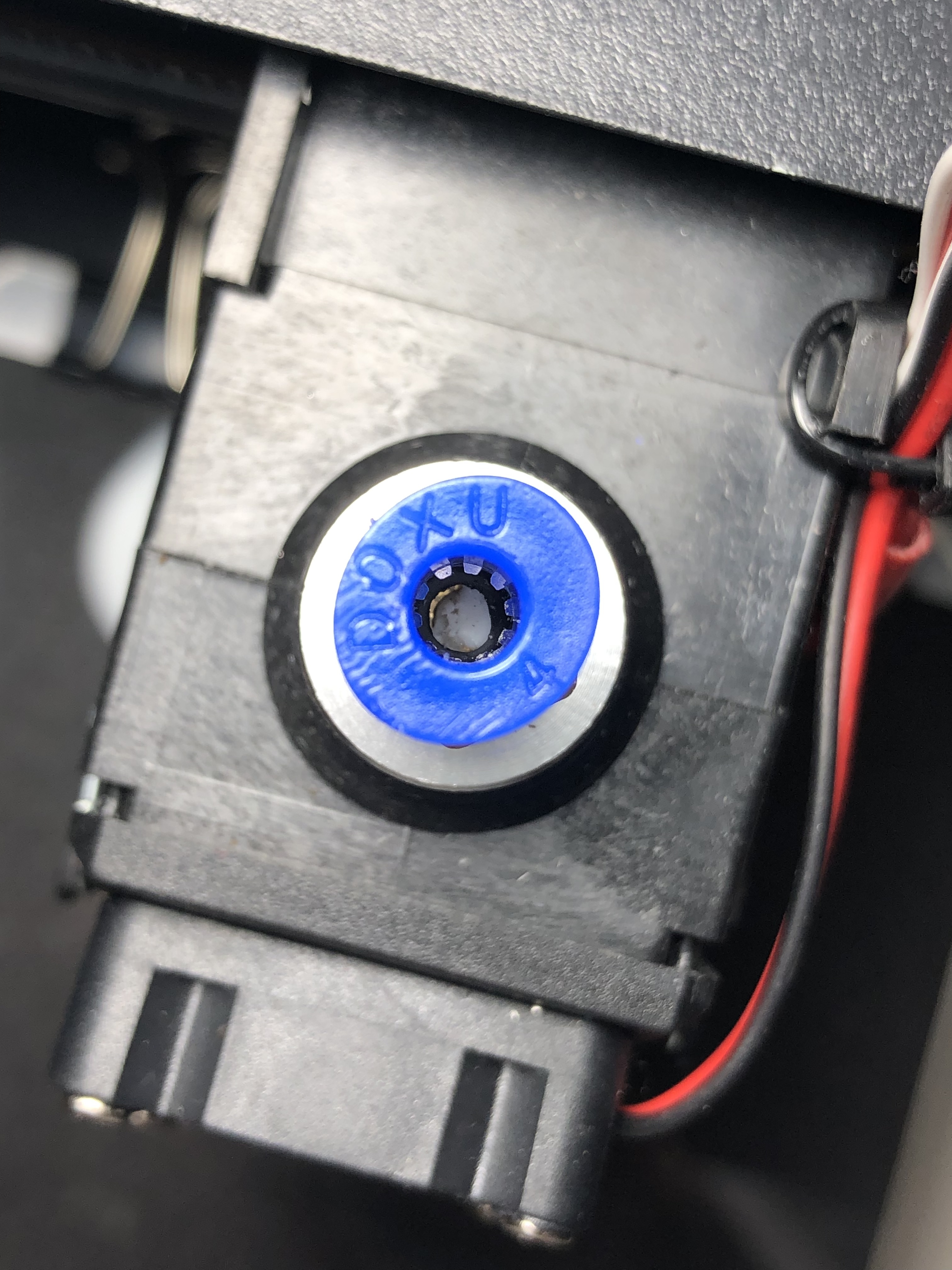

Hi all!
As you can see in the picture - a piece of filament has broken off and is now super stuck! I’ve tried forcing another piece filament to push the stuck piece - and nothing happens! I’ve cranked the heat waaaay up - still nothing.
This has happened before - but when I contacted Monoprice support - they just wanted me to send my printer in. I can’t keep sending it in and being without printer for a few weeks!
Any and all advice is much appreciated!

Torch the nozzle tip. Torch an opened paper clip and insert from the top. Disassemble the head and check that the ptfe tube (If you have one) isn’t clogged or deformed and remove and replace if needed. These are the first solutions I can think of trying
