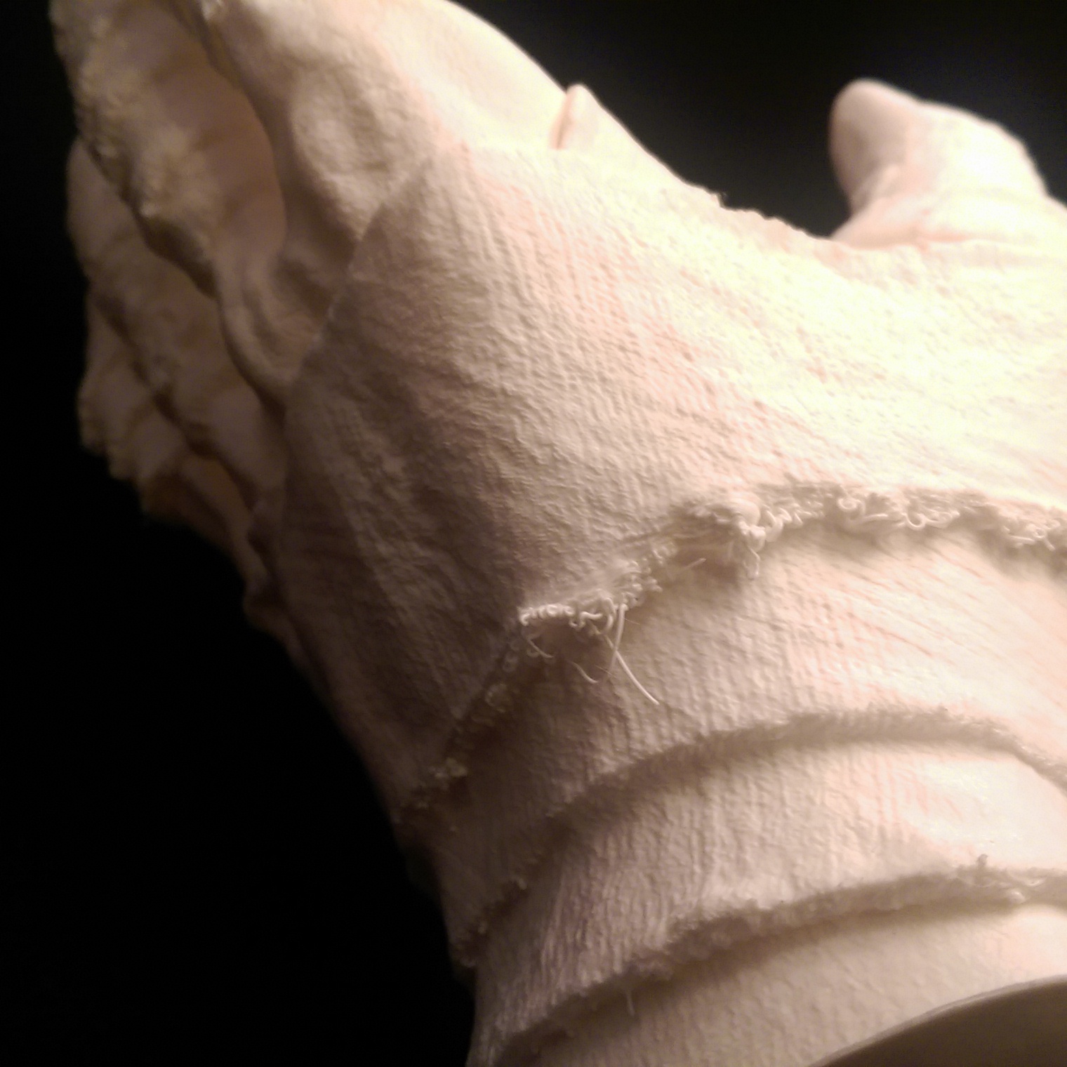

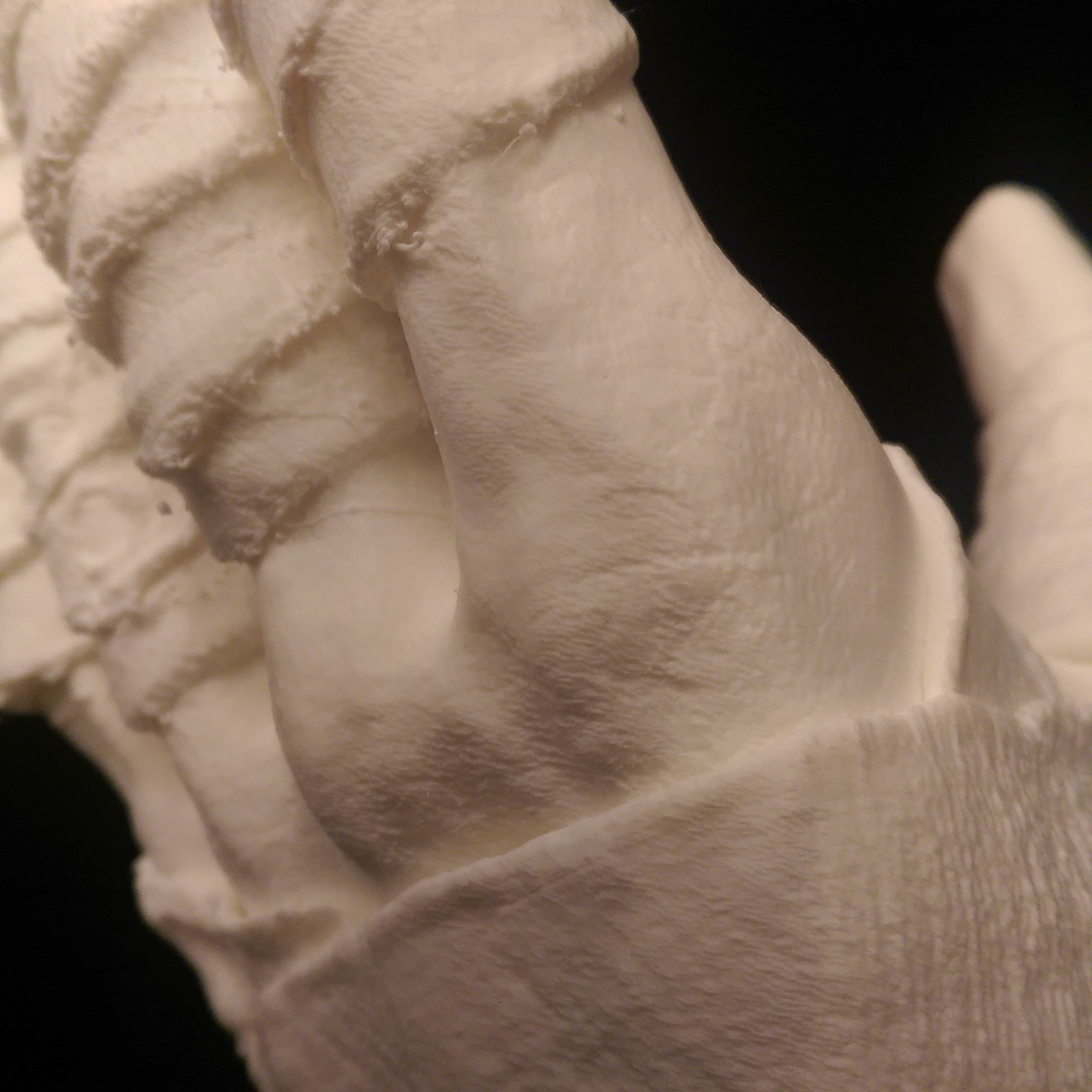

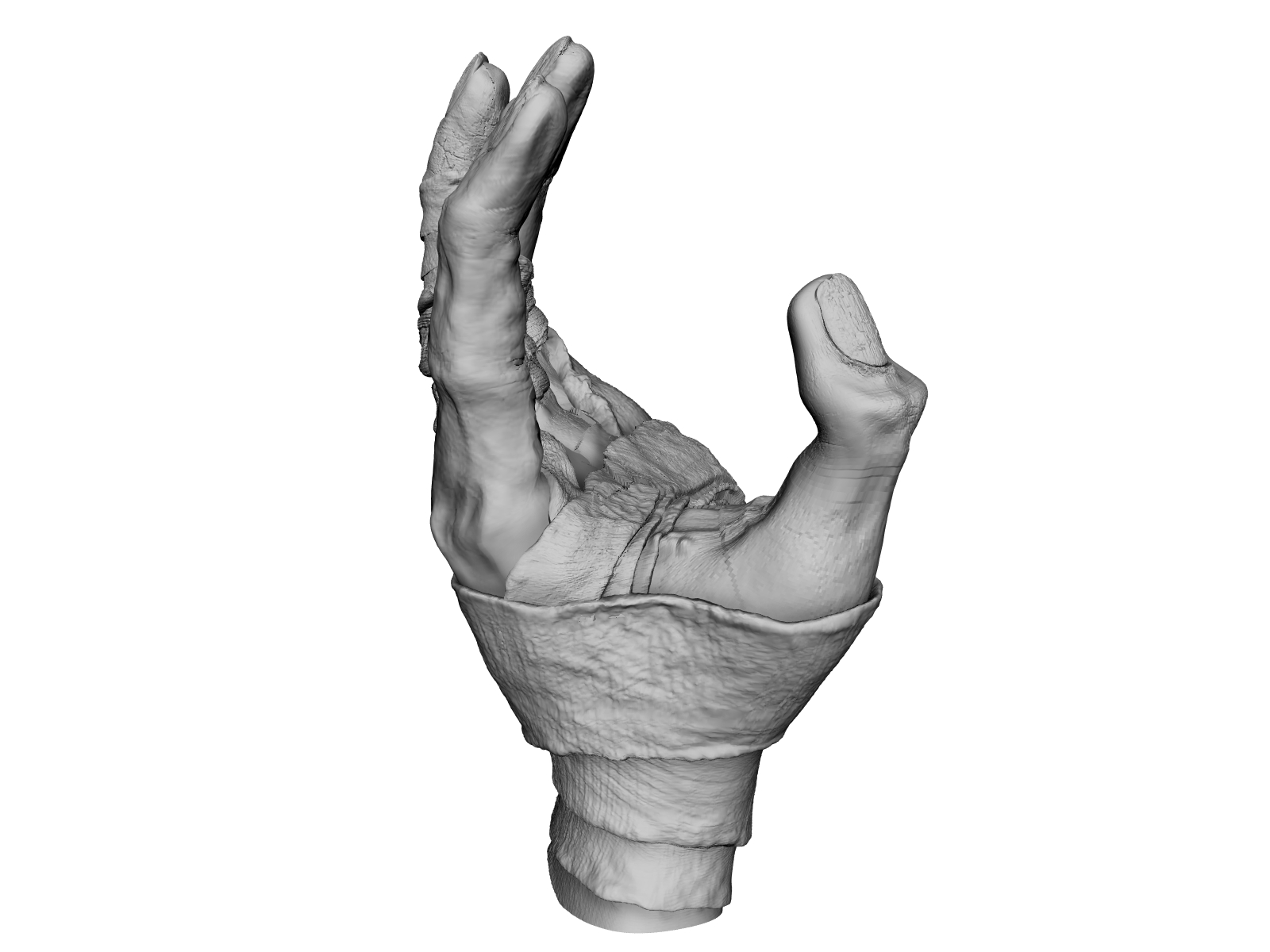

This Mummy Hand was a model I did to get a freelance contract to do more work for guitargrip.com. I modeled the lowpoly in Maya and did the high resolution details in Mudbox. The wraps are separate geometry from the hand itself. At first I didn’t bother booleaning and combining the geometry because Cura has a great option to ignore internal wall structures. So this allowed me to less work in between half size test prints. This option combine everything (Type-A) under the expert settings.

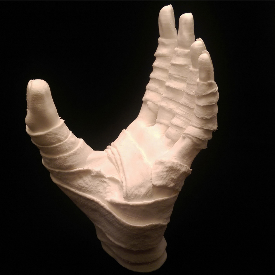

I printed this on my Ultimaker Original at 50micron layer height. The main goal was maximum quality so this took almost 40hrs to print. At the time I did not have the heated bed upgrade and printed on blue painters tape which worked fine with PLA. And this was only a 5% infill to save as much time as possible. I did not use any support even though there was some significant over hang with the wraps. This turned out to have an interesting and positive effect for this design with the mummy wraps. The wraps came out stringy on the underside which gave it an unraveled look.
I used Ultimachine White PLA at 210c with retraction to minimize strings. It still had plenty of stringing between the fingers but wasn’t very hard to clean up. I also needed to make sure I had cooling set to at least 15-20 seconds during the last part of the finger nails so it didn’t goop up and I also had dual fans on the printer at that time. This has always been something I struggle with.
This is also the first version of the Mummy hand as I later redesigned the wraps to be less repetitive between the fingers. I also updated the proportions and fingers. The first one was more distorted and creepy I think but not very practical. I can publish these models if anyone is interested.

Great work! I love how the stringing actually helps the look of the bandage! Really nice print and great quality pictures!

Great work. Clever overhangs!

Here are a couple of photos of the v2 I finished recently. I’ll print this tonight and share a photo in a couple of days. Mainly I changed the pose of the hand, fixed some finger proportions, and made the finger wraps more unique.
This is such a great 3D-print! We love the way the unsupported surfaces have the natural drooping of filament. This really fits the feeling of the cloth on this mummy hand.
