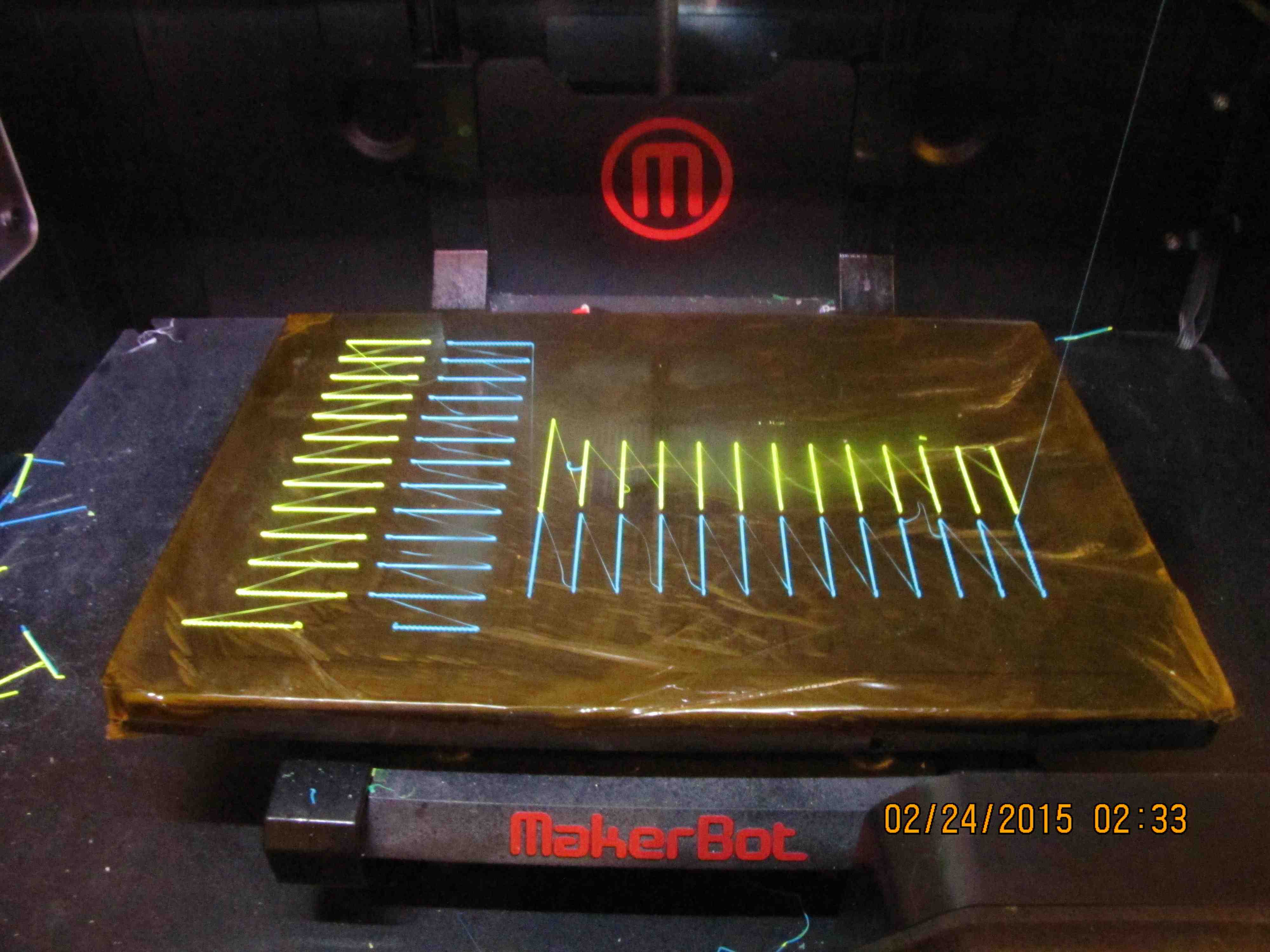

I have yet to use both heads of my flashforge on the same print, but I’m going to start experimenting…
Hi Amogos! I just got sorted out! Lookin’ fwd to “normal” life again! Even though this calibration is off, it’s on, somethin in the new makerware I guess- I only know my baby shark is running!
