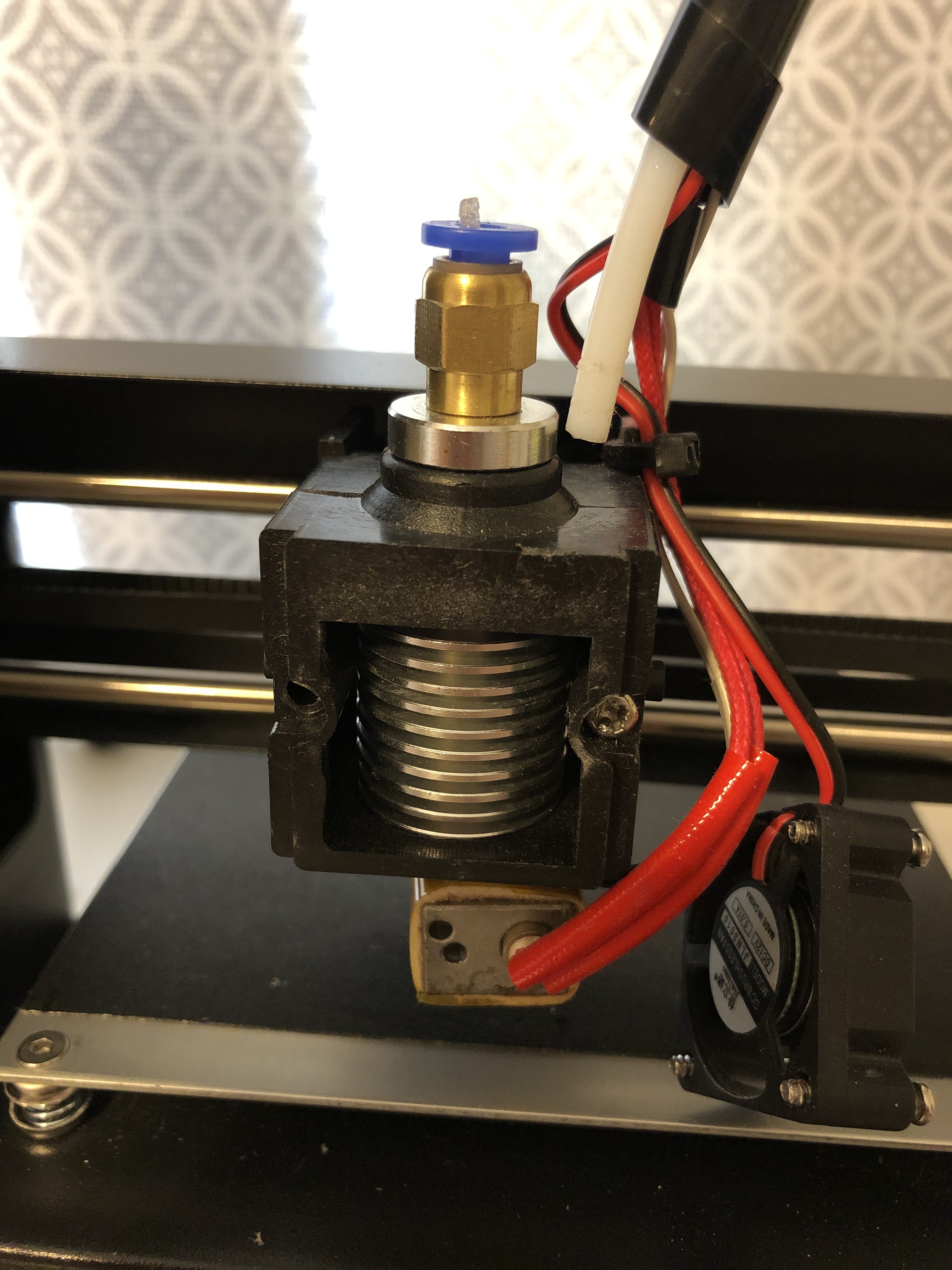

A piece of proto pasta filament is stuck in hotend /nozzle - cannot be pulled out even when heated!
Is taking it apart what I need to do to clean jam? I’ve never had this happen. I’ve used this filament 100 times.
Thanks!
Once heated good try to push it through rather than pull it out and see if that works. If not then disassembly will be needed.
