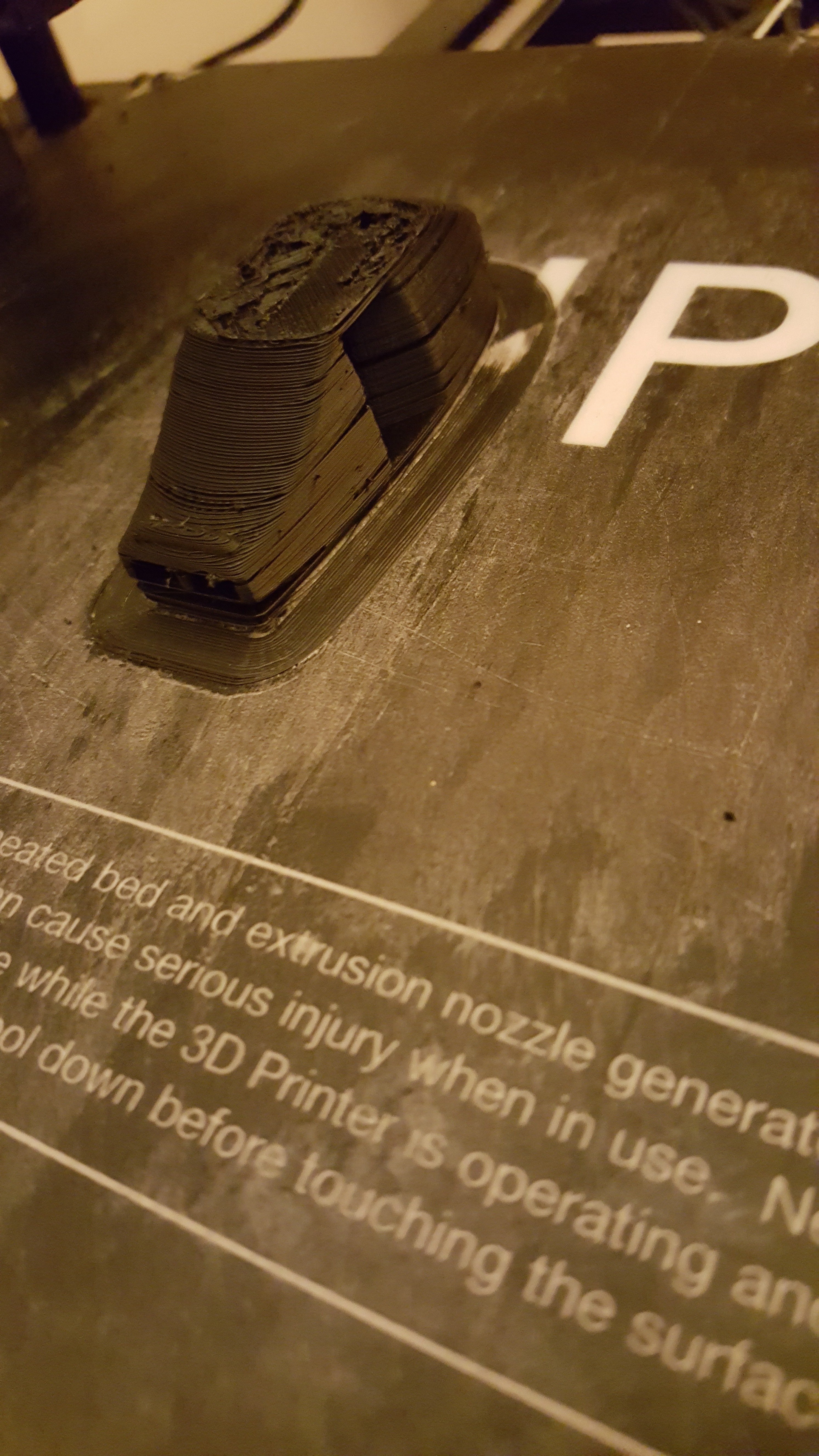

I have had all the trouble in the world with my IIIP Maker Select V2 printer. The nozzle has recently been unable to get a first layer down 100%. I’ve tried resetting the bed thinking it may be the leveling, but that hasn’t been successful. While using the heated bed I usually always have a couple corners warped which completely ruins the layering farther up the print. I usually set up my prints with a bed temp of 210C-220C and an extruder temp of 65C-70C, so still not sure where to go with temps to fix the warping. Along with the first initial layers being a problem, it seems the nozzle catches small fibers of print that are part of the support inside the print. I bounce around with 30%-50% density And haven’t found the right spot. As far as adhesion I’ve tried attaching glass, gluesticks, painters tape, and hair spray (even combining some and still failed prints). Im just praying someone has some advice because in my attempt to talk to Monoprice they want me to send the while printer back and to get a replacement. Plz help.

Did you describe your temps correctly? Do you print with a raft or brim?
I have this printer and I usually run the bed temp at 60C and the extruder at 215C. If you have the bed too high the filament won’t cool fast enough and will warp. I only use PLA. I print with either .15 or .2 layer height and only 20-30% infill. Unless you need something really strong you likely don’t need 50%.
Also make sure the bed is high enough to make good contact with the extruded filament.
For adhesion I have had luck with the included build plate with the tape on, but sometimes I have used painters tape with a purple gluestick on top of that. The only downside is you have to reapply layers of tape because it tends to come off with the print.
You also may need to replace the nozzle and PTFE tube inside the extruder. Sounds a lot more complicated than it is. I can direct you to the replacement parts I used.
I’m assuming you meant a bed temp of 65-70C & a extruder temp of 210-220C, not vice versa.
How long have you been printing with your existing nozzle, and what materials are you using?
There are only so many variables that can cause the problems you’re having, so we’ll figure it out!
Personally, I would recommend using a raft. I use Cura for slicing and the automatically generated raft has completely removed warping. Furthermore, if you are using PLA, I would lower the extruder temp. I have had a lot of success with 195degrees C.
Yes I meant to say my bed temp is around 65-70 and extruder 210-215. I have been using a brim for my prints that go 5 times around. I began using rafts and they always seemed to peel up. Next time I’ll have to try using less infill because on the print I just tested it was all sorts of messed up. I did my best to level out the bed and used a glue stick and hairspray.
You may want to try taking off the nozzle and the plastic tube and see if that is clogged. You’d have to heat it up to printing temps, cut the filament, and push down the lever and pull the filament out or extrude it through to clear it. Then just use pliers to hold the heating block and a socket wrench to loosen the nozzle. Usually 3/8 inch works. If you are still under warranty then may be best to just replace the printer. I only had to pay $50 shipping to send it back.
