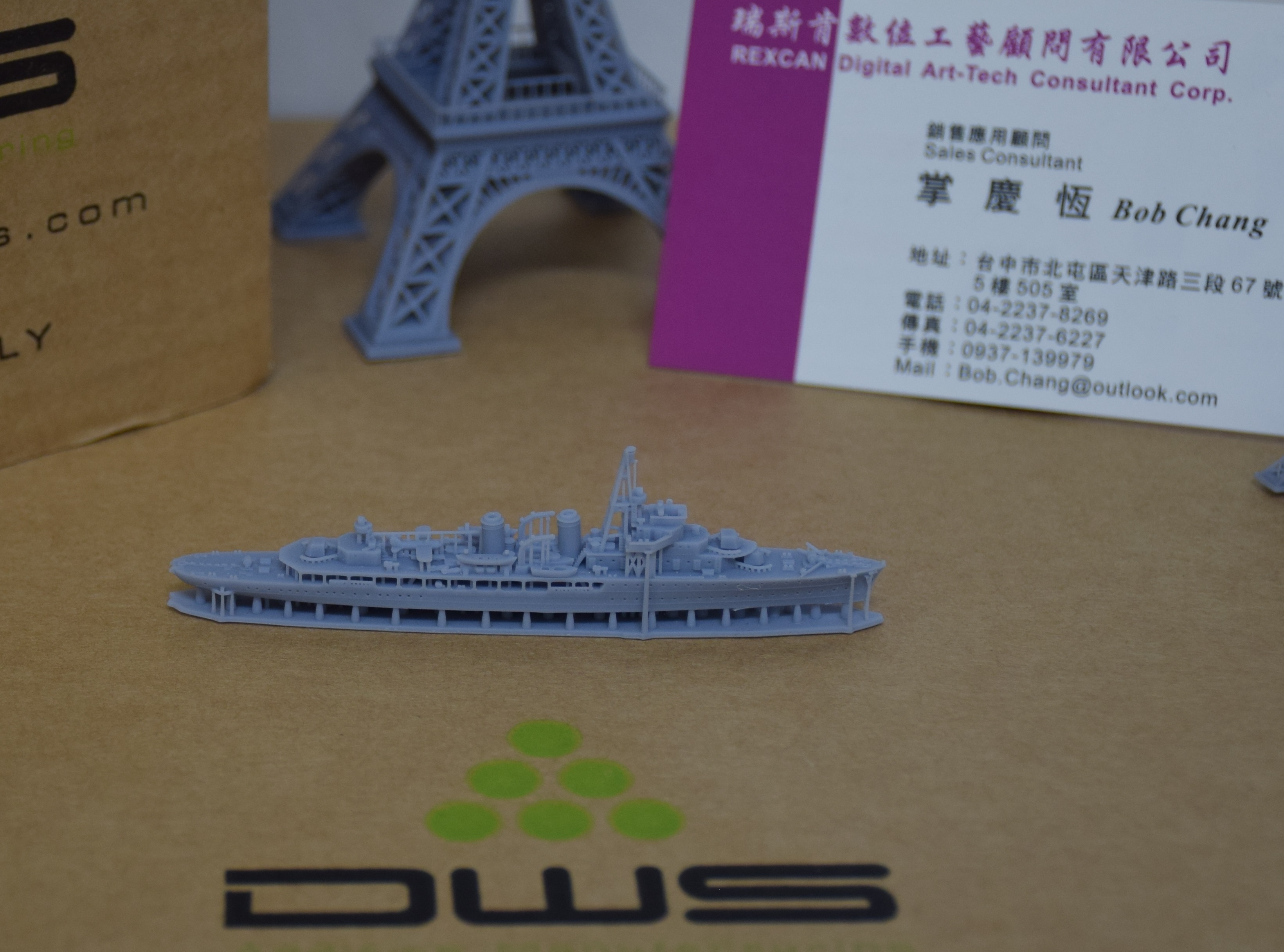

wow. Just out of curiosity- what’s the layer height for something as small as this?
And how long does it take to print it?
Mic drop…
for this piece I used a layer of 0.02 mm, but I can go down to 0.01 mm
the time is 60 minutes

Wow! It took you 60 minutes to print this small thing?

it’s normal for printer in high resolution …
100 layers/hour for 1 object or 100 object

Is this the smallest Marvin yet?
Awesome in any case!
nice boat !!!
Dws ! great machine
Love the boat too, great details! How long did it take to print?
7 hours
