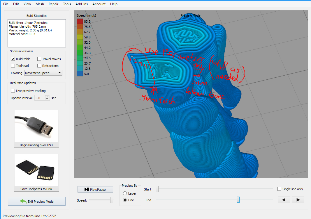

Not too sure what you mean by rigid cuts but you can doing it with any material. I would say PLA since it’s harder yet more brittle than ABS. ABS has a slight bit more flexibility than PLA, it’s really up to personal choice or whatever you think works better. When it comes to simulating bone, my guess would just be making a model of the area you’re planning to work on. Leave the marrow area empty and just making the “bone” area and its infill really high or close to whatever gives the best simulated density. Or you could get a model and just make the walls as thick as you need to give the depth of bone. Check my picture to see what I mean. http://puu.sh/nTiUe/6bce082f8f.PNG if the picture doesn’t somehow work.

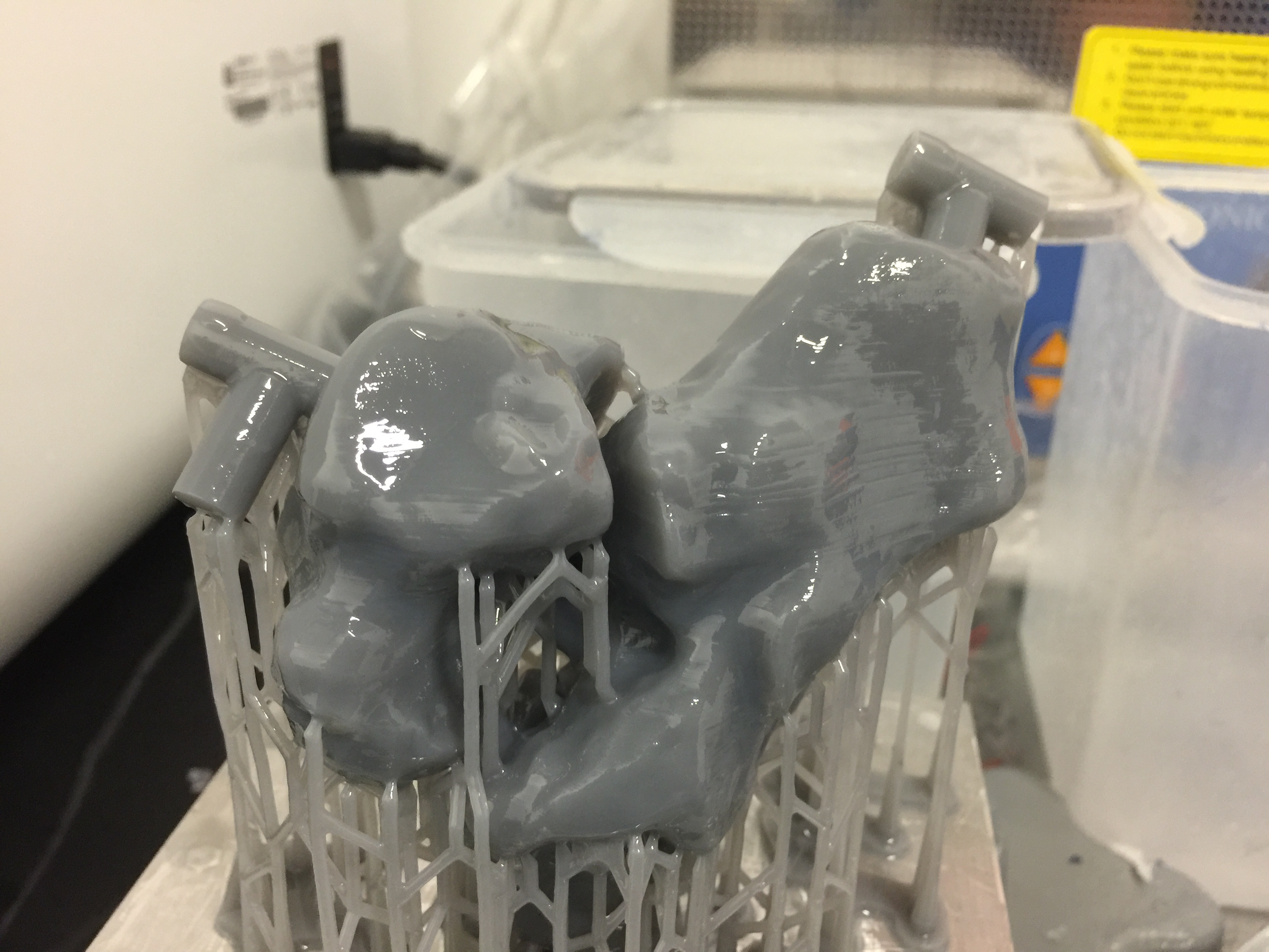

i recommend using an SLA printer and photopolymer resin. i have used this for orthopedic surgery planning. PLA will melt when sawing. The resin holds up well to the heat and can even be CT scanned with great results. see the photo, this has been the go to for bone.
thanks for your response. how are you cutting the resin? osteotome or oscillating saw? or some kind of hobby tool?
Polycarbonate is extremely strong and has a higher melting point. Very tough and durable material. I am a jeweler by day and mill a lot of different polymers by night. lol The plastic PLA , ABS, are easily broken…if you will… When I hook up my 30,000 rpm handpiece and begin to mill polycarbonate I fear for my hand and major arteries lol bc I know the poly carb will not give or break! I think it could create a very satisfying bone!
oscillating saw. now it depends what you are trying to accomplish. the resin has worked for us since we have used it for research purposes. our models are solid (i segment it that way) but if you want to just replicate bone it can also be done this way too.
