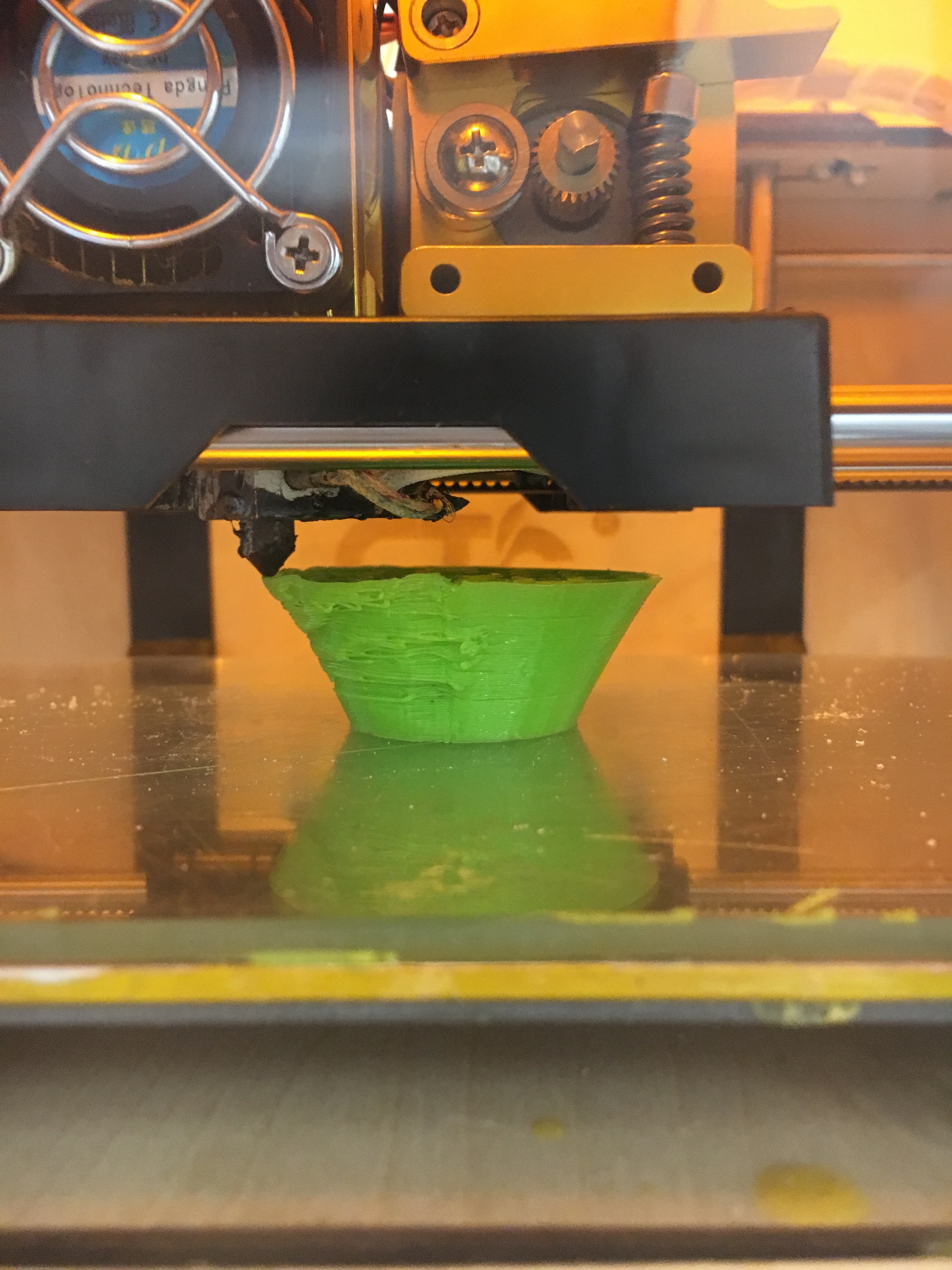

Hey, I shipped my Makerbot 1 across the country last week, sadly a couple parts broke and I had to take apart the belts & metal rods in order to fix it. It’s running now but with issues …
Overall what’s happening is my prints are sloppy on the left vertical half. I attached two pictures to show you, the green filament is Colorfabb XT, the brown is ABS. I have used these both in the past without any issues and it seems odd this is happening right after replacing mechanical parts. I am still using the same settings as before and have leveled the build plate a few times … anyone have ideas? …
