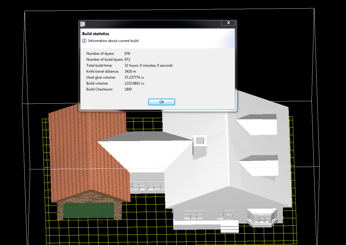

As far as costing, does the slicer output any information like distance the blade travels per layer? Would correlate with print duration. Maybe even be able to pull data like distance cut and number of layers for a each print run?
If you’ve come up with another solution to the costing, I’d love to hear.
Hi
You get a complete statistics out of the slicer, but you need to calculate the weeding process, which depends on the skill of the person who is freeing the model from the excess-paper. This is the most expensive part in germany, because labour is expensive :wink:
See the pic of the statistics… but unfortunately it is not possile to use this out of the programm atm. So no auto calculation on Websites…
best, Gunther
