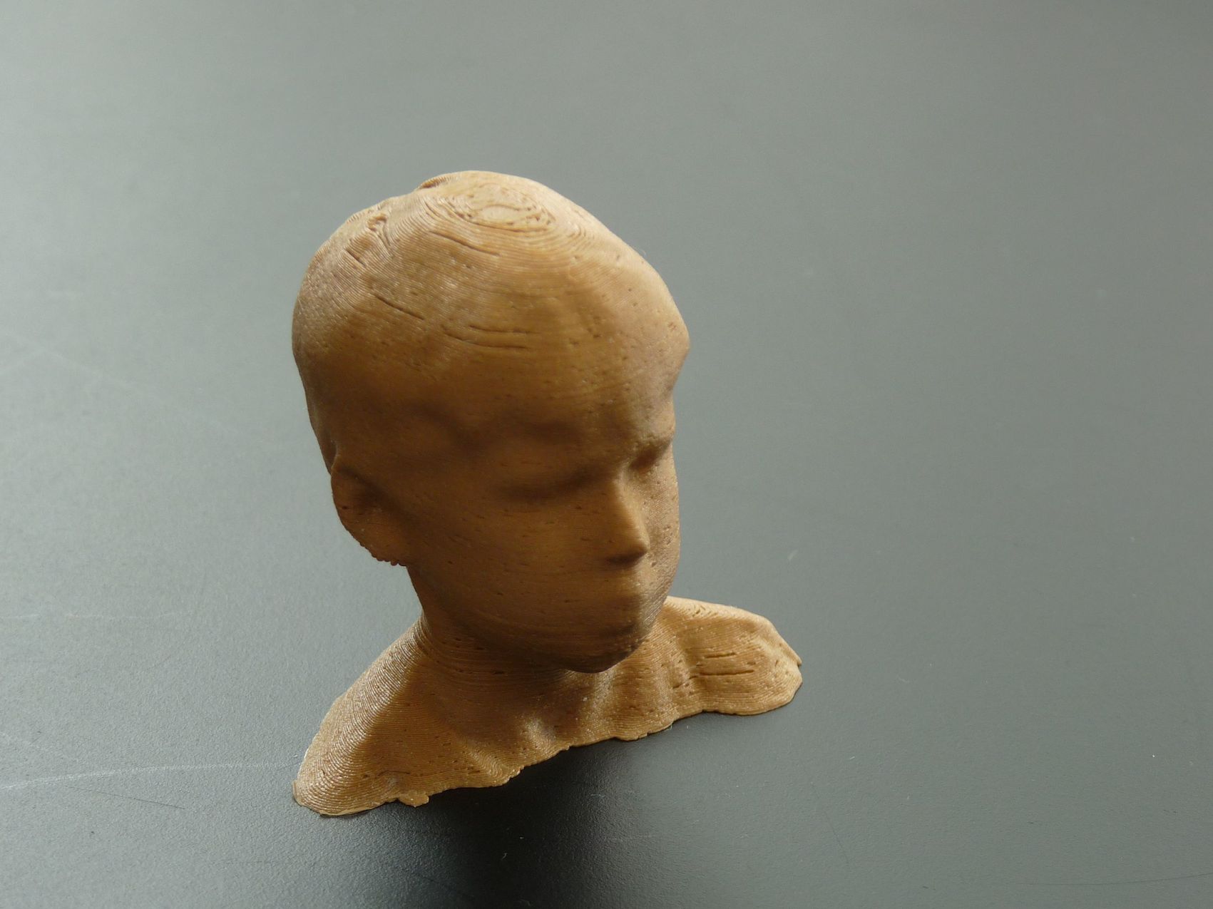

Mattijs scanned with Structure sensor on iPad, with itSeez3D app. Slicer Slic3r. Printed with Polywood, layer height 0,1, 210°C, normal speed.
Hey @DeGrazendeSlak , how do you like the itSeez3D app? Was it difficult to get a good scan?
Hi Arnoldas,
No, in fact it works fine. This was the third attempt. Important is that you dont forget the chin and upper part of the head. I use the Structure sensor on a iPad. After finishing the scan the app does its job and creates a 3D model (I think with a max of 50000 polygones), you can send the file at different file formats.
