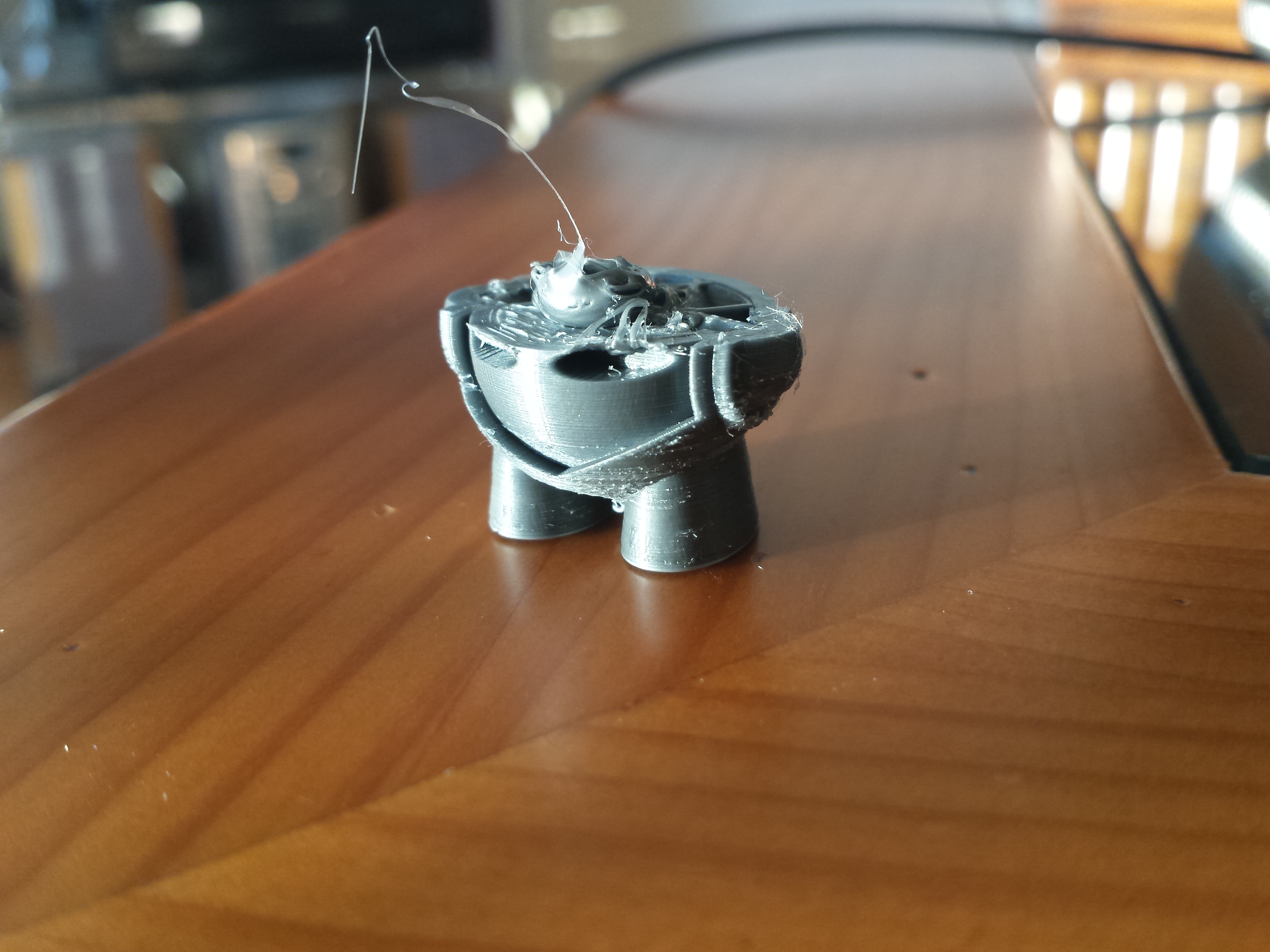

Hi all. I’m trying to verify my printer, I thought it was going to be easy as my other prints are quite good. But Marvin is giving me some headache. It came unglued from the heatbed with the consequent mess. I think it is an excess temperature problem, but I’d like your more experienced opinions. Please see attached images.
- Original Prusa MK2S
- Silver PLA from Prusa
- Extruder: 215º first layer, then 210º
- Heatbed: 55º continuously
- 0.050 mm resolution.
- 25% infill
- Fan always on.
Thanks to you all.

Thanks wirlybird. Yes, I thoroughly clean the bed each time before printing. I’ve run the print again and it failed exactly at the same layer. Seem to me that the excess heat curves a bit the printed part and then the nozzle catches it. I’m trying right now printing two Marvins at a time with a good separation between them.

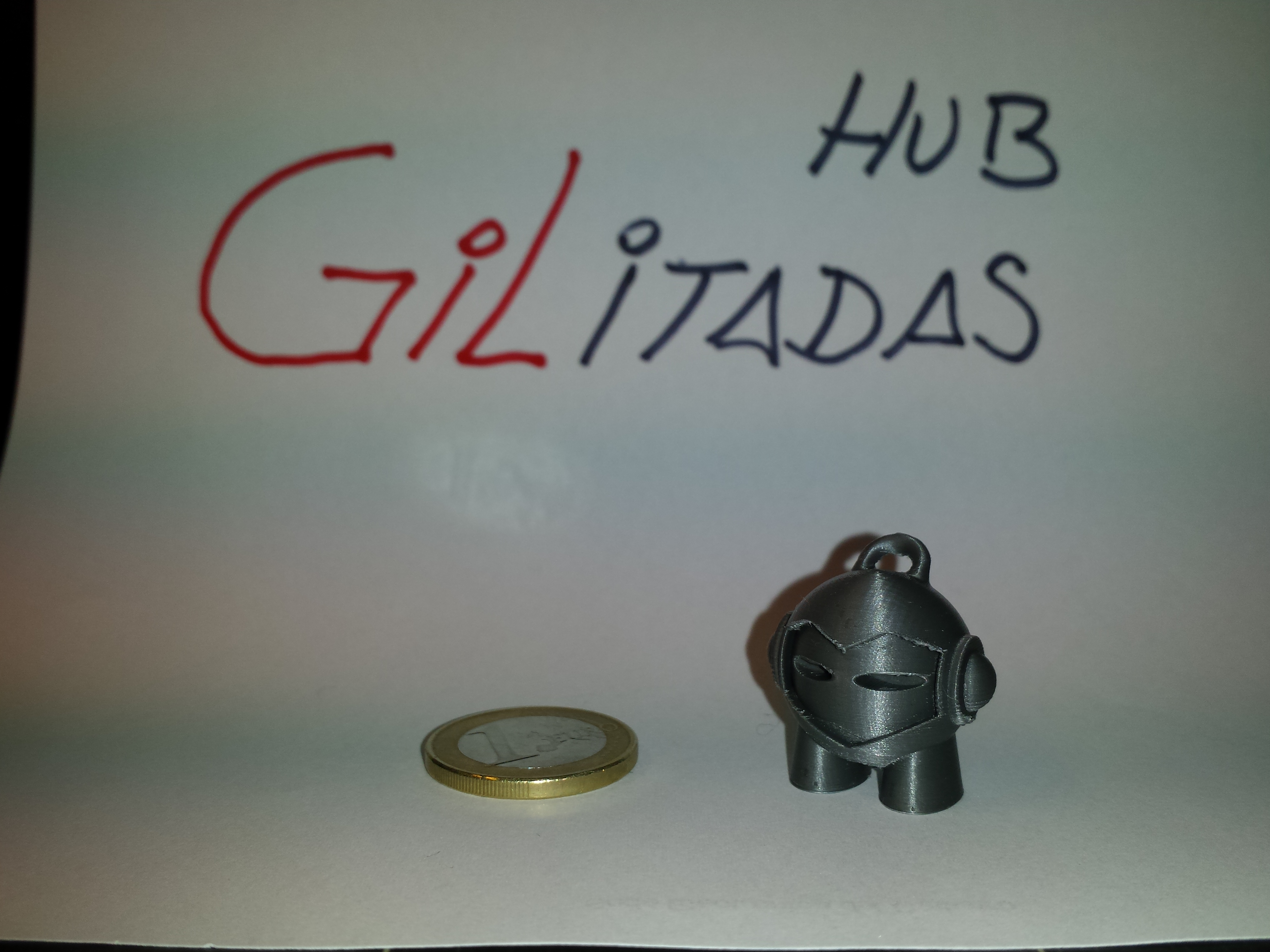

Finally 100 micron was successful, what do you think?

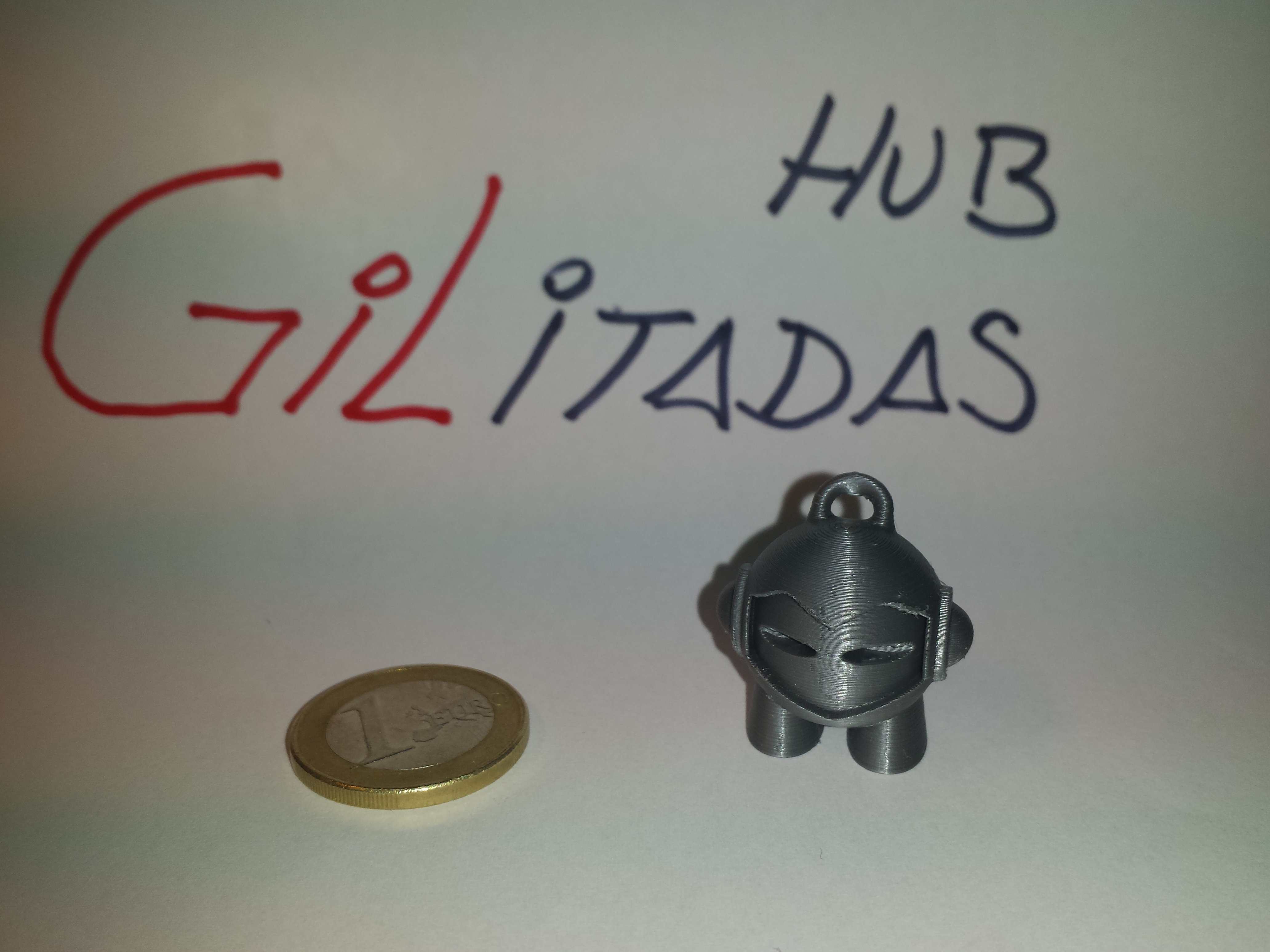

I’ll try 50 micron again with some brim and a lighter and easier infill pattern.
I did it !! Marvin 50 micron. What did I change to succeed? Basically three items:
- Infill set to 10% rectilinear. This way there is much less material, so less heat inside.
- A small 2mm brim helps to keep Marvin glued to the heatbed.
- Disable Z hop when retracting filament, this helps to avoid some hairy finishes.
