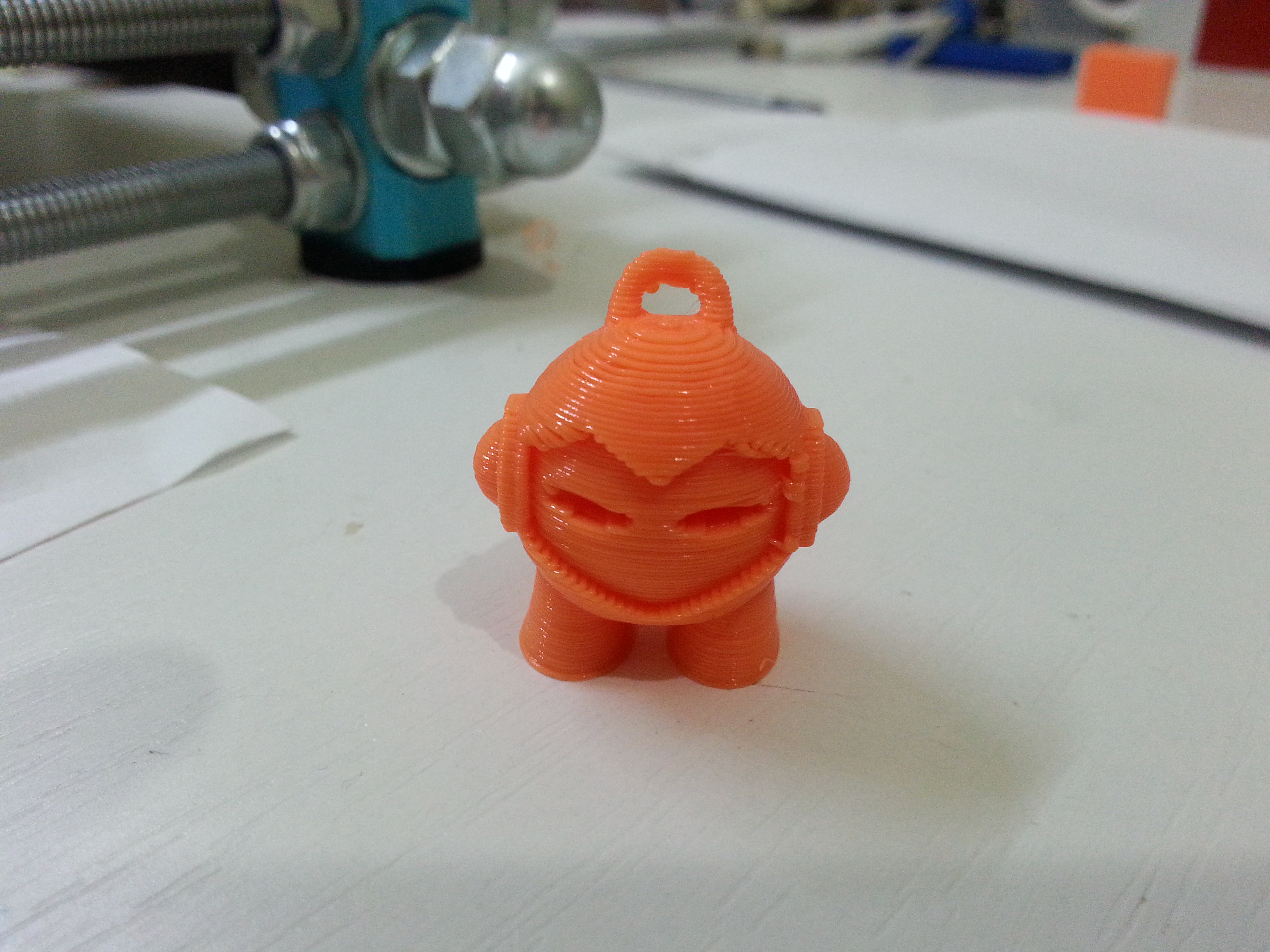

Hi, can someone give me advice how to get Marvin printed right?
For 0.3mm layers a have standard printing results but can not get solution for Marvins eyebrows.
Overhangs are problem.
I print on PRUSA I3, PLA material, 0.3mm layer height and 0.4mm nozzle. Printing fan is on, controled with slic3r. Temperatures are 225/220 C extruder and 65/60 heated bed.
Different than usuall i have started my 3D print adventure with ABS, and for PRUSA I3 i get nice clean parts, which i sell.
Thank you in advance for any help!

Try printing him with a raft on blue painters tape with no heated bed and at .2 mm layer height

Your temp is too high. You want the PLA to not droop before it cools, so keep the molten temp slightly above the hardened temp. I print PLA at 180 with the fan on. I’m using a .4mm nozzle as well with a resolution of .05 and it works like a charm.
