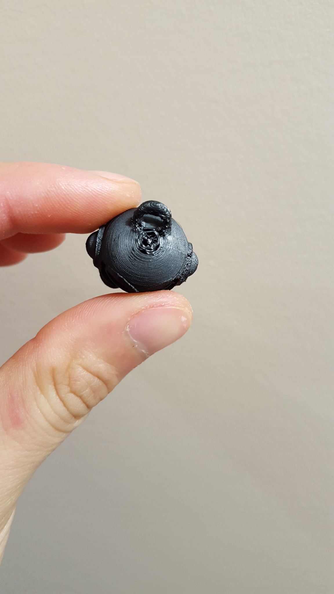

The most I printed at once was 2. I guess it wasn’t enough considering the nozzle was still to hot. I might try spacing them out more with these new settings!

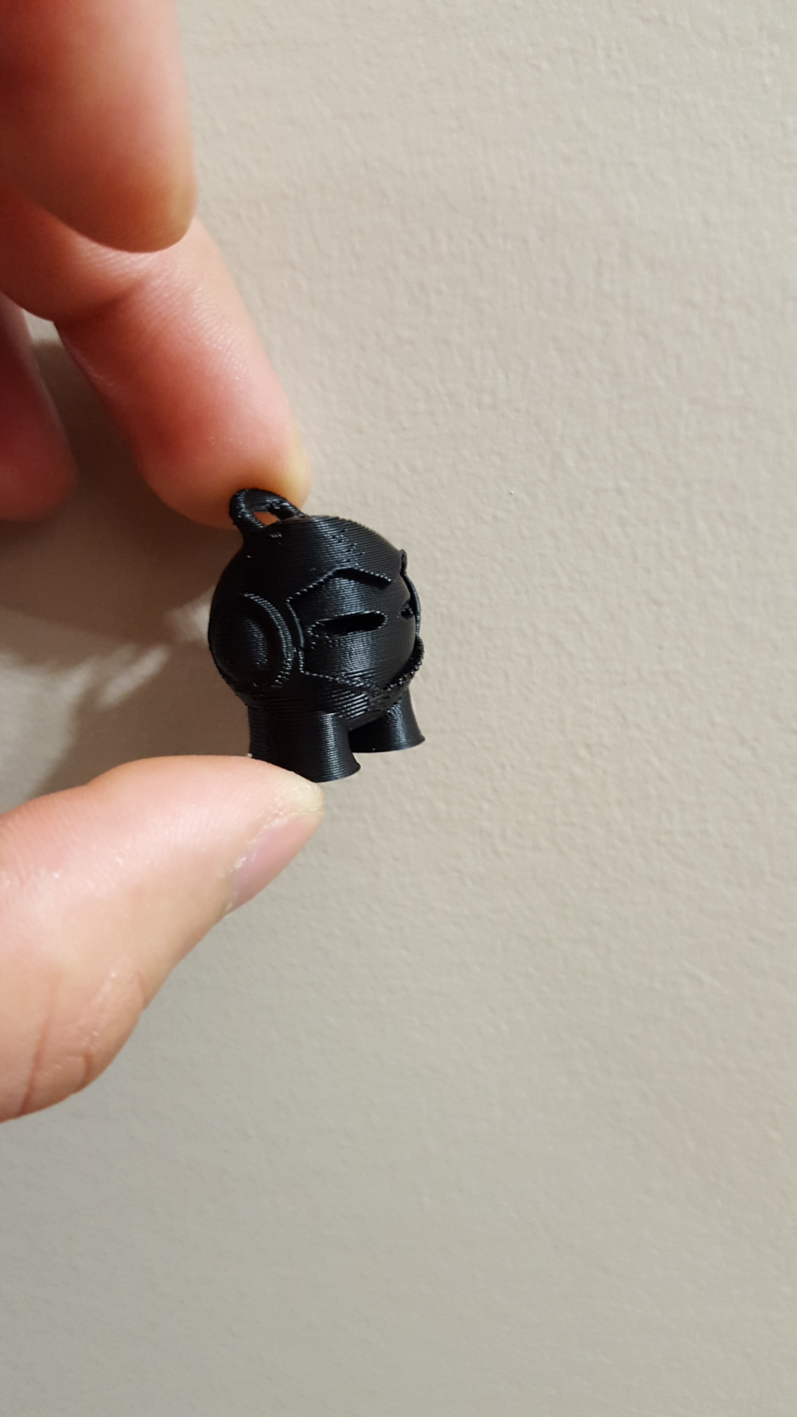

So another print later, and much better results! I think the issues im still having are just a much smaller scale than it was before all the suggestions! I still see some sagging at the very top of the hook and around the legs area. I will continue to play around with the fan settings, and maybe another another marvin into the mix to help with cooling
From our experiences, Marvin prints best at 150 / 200 microns! So may I suggest you to print with that layer height. The second print you made already looks lot better!
-230/110 for the first layer and 220/100 for the rest.
-30-40 mm/s perimeter speeds.
-150 micron layer height. (I had trouble with 100 microns. It causes over extrusion issues which I plan to revisit sometime but have not yet resolved.)
