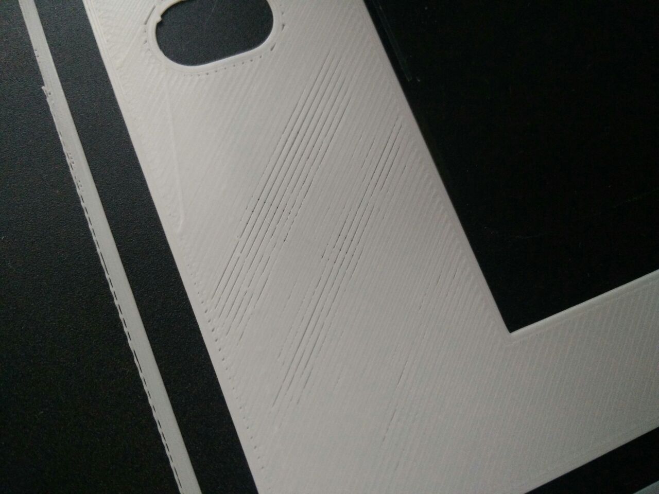

I have an E3D v6 1.75mm bowden.
When I print, there is a gap between infill lines, and also when printing rectilinear/hexagonal infill lines seem to be pretty slim.
My settings:
- Slicer: Slic3r
- Nozzle size: 0.4mm
- Print speed: 30mm/s
- First layer print speed: 15mm/s
- Travel speed: 90mm/s
- Retraction length: 0.8mm
- Retraction speed: 40mm/s
- Extrude ratio: 1 (tried also with 0.48mm extrusion width, I remember it’s the default S3D setting, so I gave it a try)
- Print temperature: 220 °C
- Material: PLA
Firmware settings:
- Firmware: Marlin 1.1.0-1
- Motion system: CoreXY
- Acceleration: 1000
- VMax X: 300
- VMax Y: 300
- VMax Z: 5
- VMax E: 80
- Xsteps/mm: 80.05
- Ysteps/mm: 80.05
- Zsteps/mm: 400
- Esteps/mm: 96.5
Disclaimer: I set Esteps/mm to 96.5 because I calibrated the printer and if I extrude 100mm filament I get exactly 100mm extruded, so I’m 100% sure it’s an accurate setting. Same for X,Y,Z steps. I printed a cube and calculated the real steps per millimeter, and it’s accurate too. The extruder motor works, it’s not the issue.
Here you can find some pictures that show what I’m trying to describe:
I built this printer taking parts from my old i3 printer, which worked perfectly with the exact same filament. The difference is that it had direct-drive extruder while this one has a bowden extruder, and also the i3 had Repetier while the new printer has Marlin.
While printing I tried to release the extruder motor clamp and push the filament by hand: it extruded 1mm thick lines, so the extruder is not clogged and is perfectly capable of extruding the required amount of PLA.
